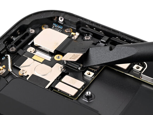

  29. iPad Pro 13" Rear Camera Replacement, Disconnect the camera: passo 29, immagine 1 di 2 iPad Pro 13" Rear Camera Replacement, Disconnect the camera: passo 29, immagine 2 di 2
    • Place the flat end of a spudger between the camera ribbon cable and the top button ribbon cable, against the camera press connector.
    • While holding the top button ribbon cable down with the spudger, twist the spudger to disconnect the rear camera press connector.
  30. iPad Pro 13" Rear Camera Replacement, Remove the camera: passo 30, immagine 1 di 1
    • Use a spudger to break the glue dots near the top-left and bottom-right corners of the camera.
    • These glue dots are small and hard to see. If the camera doesn't pry up easily in the next step, look for more glue dots.
  31. iPad Pro 13" Rear Camera Replacement: passo 31, immagine 1 di 3 iPad Pro 13" Rear Camera Replacement: passo 31, immagine 2 di 3 iPad Pro 13" Rear Camera Replacement: passo 31, immagine 3 di 3
    • Use the point of a spudger to pry the camera up from the top-left corner.
    • The camera is adhered to the iPad. Apply slow, firm pressure to give it time to release.
    • Once the camera is free, grab it by the ribbon cable and remove it.

  36. iPad Pro 13" Rear Camera Replacement, Connect the camera: passo 36, immagine 1 di 2 iPad Pro 13" Rear Camera Replacement, Connect the camera: passo 36, immagine 2 di 2
    • Use the flat end of a spudger or your finger to connect the camera press connector.
