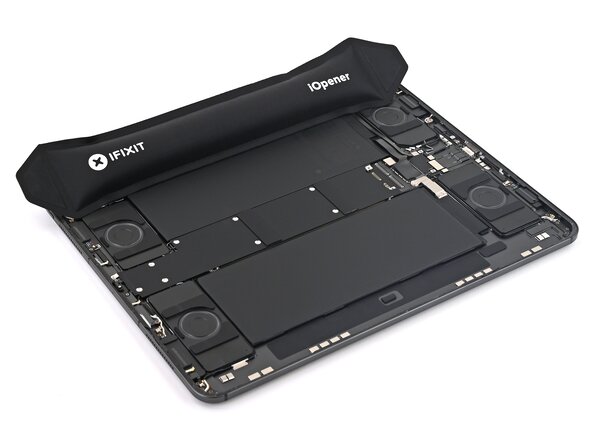

  3. iPad Pro 13" Front Camera Assembly Replacement, Heat the top-right corner: passo 3, immagine 1 di 1
    • Apply a heated iOpener to the top-right corner of the screen for two minutes to soften the adhesive.
    • You can also use a hair dryer or heat gun to soften the adhesive, but be careful not to overheat the iPad as the screen and battery can be damaged by heat.
    • Use this same procedure for all future steps where heat is needed to soften adhesive, unless otherwise noted.

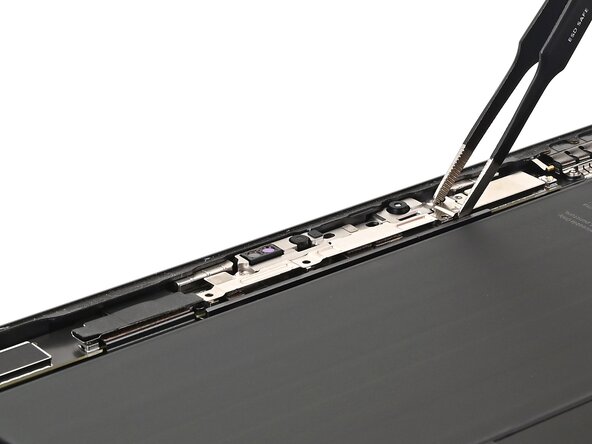

  26. iPad Pro 13" Front Camera Assembly Replacement, Remove the front camera bracket cover: passo 26, immagine 1 di 3 iPad Pro 13" Front Camera Assembly Replacement, Remove the front camera bracket cover: passo 26, immagine 2 di 3 iPad Pro 13" Front Camera Assembly Replacement, Remove the front camera bracket cover: passo 26, immagine 3 di 3
    • Use a heated iOpener, hair dryer, or heat gun to soften the adhesive securing the long, black rubber cover below the front camera assembly.
    • Use tweezers or your fingers to pry up and remove the cover from the right side. Work slowly to avoid tearing it—it'll be reused later.
    • Leave the smaller rubber cover to the left of the front camera assembly in place.
  27. iPad Pro 13" Front Camera Assembly Replacement, Remove the front camera bracket: passo 27, immagine 1 di 1
    • Use a JCIS or JIS 00 screwdriver to remove the four screws securing the front camera bracket:
    • Two 2.0 mm‑long screws on either edge.
    • The left edge screw is hidden by the smaller black rubber cover. Peel up only the loose portion on its left edge to access the screw.
    • Two 1.3 mm‑long screws in the center of the bracket.
  28. iPad Pro 13" Front Camera Assembly Replacement: passo 28, immagine 1 di 2 iPad Pro 13" Front Camera Assembly Replacement: passo 28, immagine 2 di 2
    • Use tweezers or your fingers to lift and remove the front camera bracket.

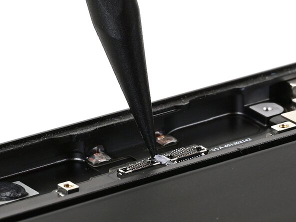

  29. iPad Pro 13" Front Camera Assembly Replacement, Disconnect the front camera module: passo 29, immagine 1 di 2 iPad Pro 13" Front Camera Assembly Replacement, Disconnect the front camera module: passo 29, immagine 2 di 2
    • Use the point of a spudger to pry up and disconnect the front camera module's leftmost press connector.
  30. iPad Pro 13" Front Camera Assembly Replacement: passo 30, immagine 1 di 2 iPad Pro 13" Front Camera Assembly Replacement: passo 30, immagine 2 di 2
    • Be careful not to damage the sockets on the board in this step. The connectors are glued together and more difficult to disconnect.
    • Use the flat end of a spudger to pry up and disconnect the front camera module's two central press connectors. Insert the spudger underneath the top edge of each connector.

    • Use your fingers or a spudger to pry up and remove the front camera assembly from its right edge.
  33. iPad Pro 13" Front Camera Assembly Replacement, Disassembly complete: passo 33, immagine 1 di 1
    • Congratulations on completing disassembly! The remaining steps will show how to reassemble the iPad.
  34. iPad Pro 13" Front Camera Assembly Replacement, Remove residue: passo 34, immagine 1 di 3 iPad Pro 13" Front Camera Assembly Replacement, Remove residue: passo 34, immagine 2 di 3 iPad Pro 13" Front Camera Assembly Replacement, Remove residue: passo 34, immagine 3 di 3
    • Be careful not to damage the press connector sockets when cleaning around them.
    • Use the point of a spudger to lift any residual adhesive from between and around the front camera press connector sockets.
    • Use tweezers to remove the residual adhesive.
