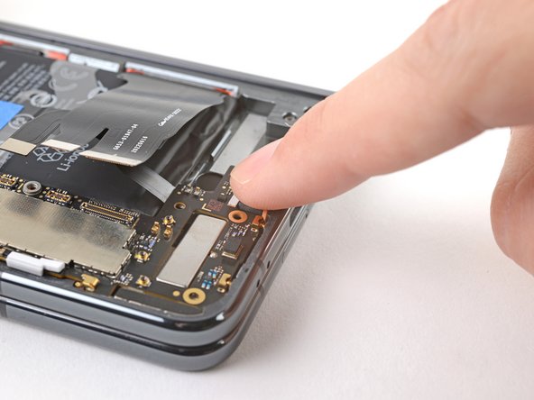

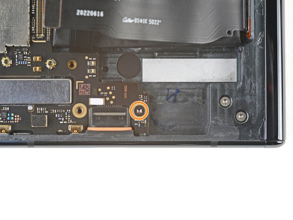

  25. Google Pixel Fold Logic Board Replacement, Remove the screw cover: passo 25, immagine 1 di 3 Google Pixel Fold Logic Board Replacement, Remove the screw cover: passo 25, immagine 2 di 3 Google Pixel Fold Logic Board Replacement, Remove the screw cover: passo 25, immagine 3 di 3
    Attrezzo utilizzato in questo passaggio:
  26. Google Pixel Fold Logic Board Replacement, Unfasten the bottom bracket: passo 26, immagine 1 di 1
    • Use a Torx Plus 3IP driver to remove the five 3.1 mm‑long screws securing the bottom bracket.
  27. Google Pixel Fold Logic Board Replacement, Remove the bottom bracket: passo 27, immagine 1 di 3 Google Pixel Fold Logic Board Replacement, Remove the bottom bracket: passo 27, immagine 2 di 3 Google Pixel Fold Logic Board Replacement, Remove the bottom bracket: passo 27, immagine 3 di 3
    • Use tweezers, or your fingers, to pull the bottom bracket toward the bottom edge of the phone and release its clip.
    • Remove the bottom bracket.
    • During reassembly, reinsert the bottom bracket clip under its slot in the logic board before aligning its screw holes.

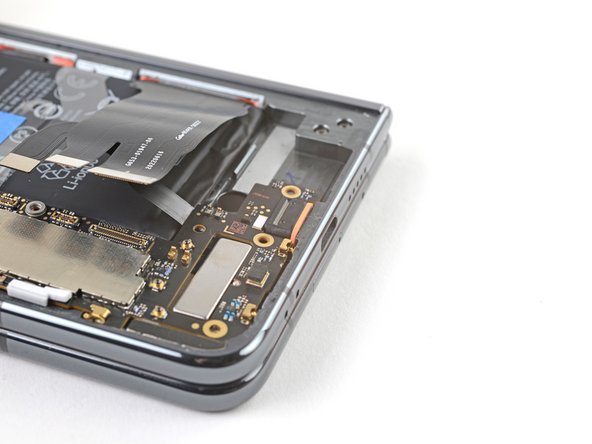

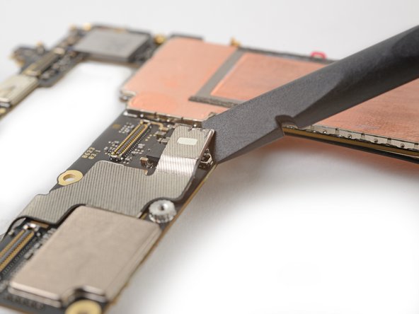

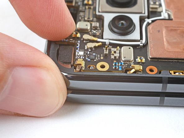

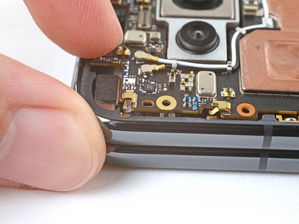

  28. Google Pixel Fold Logic Board Replacement, Disconnect the base battery: passo 28, immagine 1 di 2 Google Pixel Fold Logic Board Replacement, Disconnect the base battery: passo 28, immagine 2 di 2
    • There are two batteries you need to disconnect, one for each half of the phone.
    • Use the point of a spudger to pry up and disconnect the base battery cable press connector.

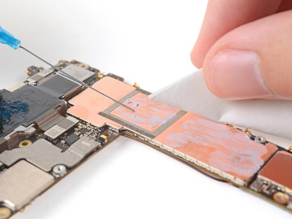

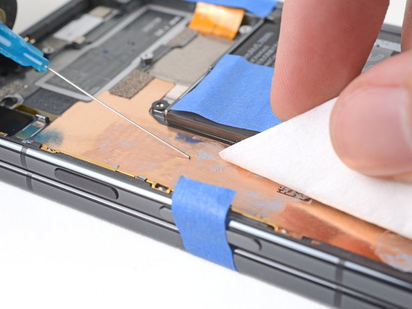

  29. Google Pixel Fold Logic Board Replacement, Remove the tape: passo 29, immagine 1 di 2 Google Pixel Fold Logic Board Replacement, Remove the tape: passo 29, immagine 2 di 2
    • Peel the grey conductive tape off the bottom interconnect cable.

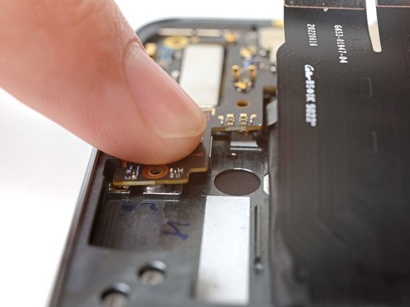

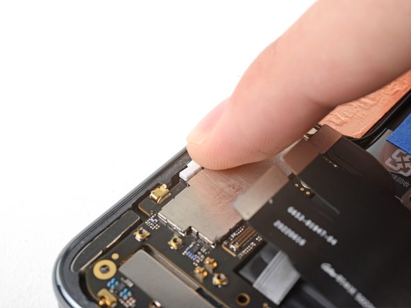

  30. Google Pixel Fold Logic Board Replacement, Disconnect the flip battery: passo 30, immagine 1 di 3 Google Pixel Fold Logic Board Replacement, Disconnect the flip battery: passo 30, immagine 2 di 3 Google Pixel Fold Logic Board Replacement, Disconnect the flip battery: passo 30, immagine 3 di 3
    • Use a point of a spudger to pry up and disconnect the flip battery and bottom interconnect press connectors.
    • You have to disconnect both cables to keep the battery connector from accidentally touching the logic board.

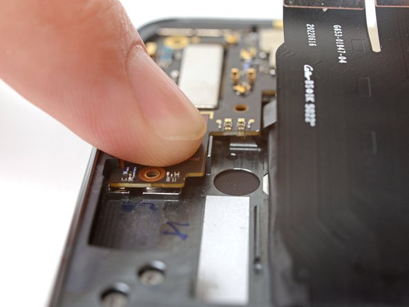

  31. Google Pixel Fold Logic Board Replacement, Reassembly information: passo 31, immagine 1 di 3 Google Pixel Fold Logic Board Replacement, Reassembly information: passo 31, immagine 2 di 3 Google Pixel Fold Logic Board Replacement, Reassembly information: passo 31, immagine 3 di 3
    • During reassembly, the next two steps demonstrate how to replace the flip battery and bottom interconnect cable conductive tape.
    • Peel off the new conductive tape from its liner and apply the sticky side to the bottom interconnect connector, making sure to bridge the logic board.
  32. Google Pixel Fold Logic Board Replacement: passo 32, immagine 1 di 3 Google Pixel Fold Logic Board Replacement: passo 32, immagine 2 di 3 Google Pixel Fold Logic Board Replacement: passo 32, immagine 3 di 3
    • Use a spudger, or your fingers, to press down the conductive tape and adhere it.

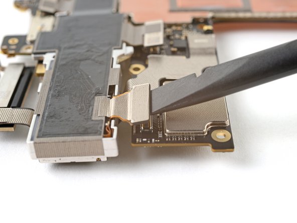

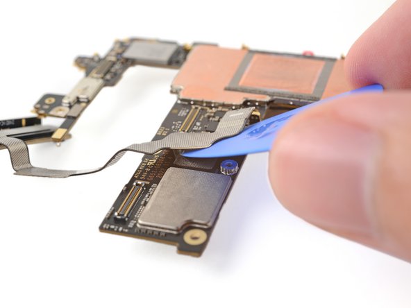

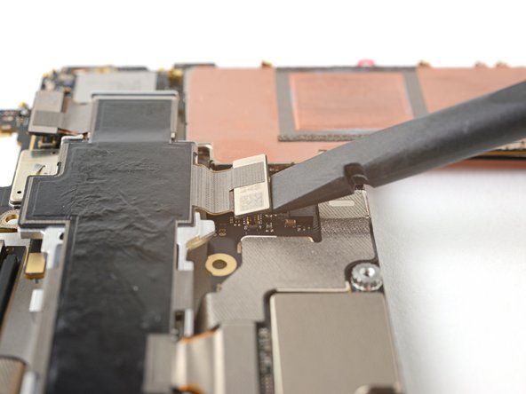

  33. Google Pixel Fold Logic Board Replacement, Disconnect the ultra wideband antenna: passo 33, immagine 1 di 2 Google Pixel Fold Logic Board Replacement, Disconnect the ultra wideband antenna: passo 33, immagine 2 di 2
    • If your graphite sheet is taped out of the way, remove the tape now.
    • Use the point of a spudger to pry up and disconnect the ultra wideband antenna press connector.

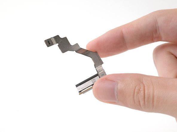

  34. Google Pixel Fold Logic Board Replacement, Separate the adhesive: passo 34, immagine 1 di 2 Google Pixel Fold Logic Board Replacement, Separate the adhesive: passo 34, immagine 2 di 2
    • The ultra wideband antenna is lightly adhered to the graphite sheet.
    • Slide an opening pick under the antenna to separate its adhesive.
  35. Google Pixel Fold Logic Board Replacement, Remove the ultra wideband antenna: passo 35, immagine 1 di 2 Google Pixel Fold Logic Board Replacement, Remove the ultra wideband antenna: passo 35, immagine 2 di 2
    Tesa 61395 Tape
    $5.99
    • Peel up the ultra wideband antenna and remove it.

  40. Google Pixel Fold Logic Board Replacement, Disconnect the fingerprint sensor: passo 40, immagine 1 di 2 Google Pixel Fold Logic Board Replacement, Disconnect the fingerprint sensor: passo 40, immagine 2 di 2
    • Be careful during this step, as you risk breaking surface-mounted components on the logic board. Avoid prying against the logic board.
    • Use the point of a spudger to lift up and disconnect the fingerprint sensor press connector.
  41. Google Pixel Fold Logic Board Replacement, Remove the tape: passo 41, immagine 1 di 2 Google Pixel Fold Logic Board Replacement, Remove the tape: passo 41, immagine 2 di 2
    • Peel off the tape covering the top interconnect cable.

  44. Google Pixel Fold Logic Board Replacement, Disconnect the top interconnect cable: passo 44, immagine 1 di 2 Google Pixel Fold Logic Board Replacement, Disconnect the top interconnect cable: passo 44, immagine 2 di 2
    • The bracket securing the connector is attached to it. Treat both components as the "press connector."
    • Use the point of a spudger to pry up and disconnect the top interconnect cable press connector.
  45. Google Pixel Fold Logic Board Replacement, Disconnect the inner screen: passo 45, immagine 1 di 3 Google Pixel Fold Logic Board Replacement, Disconnect the inner screen: passo 45, immagine 2 di 3 Google Pixel Fold Logic Board Replacement, Disconnect the inner screen: passo 45, immagine 3 di 3
    • Use the flat end of a spudger to lift up and disconnect the inner screen press connector.
    • Move the inner screen cable 90° over the right edge of the phone before continuing.

  52. Google Pixel Fold Logic Board Replacement, Unfasten the logic board: passo 52, immagine 1 di 2 Google Pixel Fold Logic Board Replacement, Unfasten the logic board: passo 52, immagine 2 di 2
    • Use a Torx Plus 3IP driver to remove the two screws securing the logic board:
    • One 2.8 mm‑long screw near the top left corner
    • One 2.5 mm‑long screw near bottom right corner

  57. Google Pixel Fold Logic Board Replacement: passo 57, immagine 1 di 3 Google Pixel Fold Logic Board Replacement: passo 57, immagine 2 di 3 Google Pixel Fold Logic Board Replacement: passo 57, immagine 3 di 3
    • The next four steps will demonstrate how to reinstall the logic board.
    • Insert the USB-C port into its cutout in the frame at a shallow angle.
    • Use your finger to press the USB-C port down until the orange rubber gasket is level with its cutout—not twisted or pinched.
    • Press the bottom of the logic board over its lower alignment peg and engage its spring connectors.
  58. Google Pixel Fold Logic Board Replacement: passo 58, immagine 1 di 3 Google Pixel Fold Logic Board Replacement: passo 58, immagine 2 di 3 Google Pixel Fold Logic Board Replacement: passo 58, immagine 3 di 3
    • While pushing the logic board toward the bottom edge of the phone, press the logic board into its lower metal clip.
  59. Google Pixel Fold Logic Board Replacement: passo 59, immagine 1 di 2 Google Pixel Fold Logic Board Replacement: passo 59, immagine 2 di 2
    • Press down on the white logic board bracket so it rests under the lip in the frame's edge.
  60. Google Pixel Fold Logic Board Replacement: passo 60, immagine 1 di 3 Google Pixel Fold Logic Board Replacement: passo 60, immagine 2 di 3 Google Pixel Fold Logic Board Replacement: passo 60, immagine 3 di 3
    • Make sure all of the cables are above the logic board before securing it back into the frame. If you haven't taped them, do so now to avoid trapping them as you work.
    • While pressing down on the white logic board bracket, push the logic board against the left edge of the phone.
    • Position the logic board over the upper alignment peg.
    • Press down to secure the logic board.

  62. Google Pixel Fold Logic Board Replacement, Remove the rear cameras: passo 62, immagine 1 di 3 Google Pixel Fold Logic Board Replacement, Remove the rear cameras: passo 62, immagine 2 di 3 Google Pixel Fold Logic Board Replacement, Remove the rear cameras: passo 62, immagine 3 di 3
    • Remove the rear cameras.
  63. Google Pixel Fold Logic Board Replacement, Disconnect the antenna cable: passo 63, immagine 1 di 2 Google Pixel Fold Logic Board Replacement, Disconnect the antenna cable: passo 63, immagine 2 di 2
    • Use a spudger to pry up and disconnect the 5G mmWave antenna cable press connector.
  64. Google Pixel Fold Logic Board Replacement, Remove the antenna cable: passo 64, immagine 1 di 3 Google Pixel Fold Logic Board Replacement, Remove the antenna cable: passo 64, immagine 2 di 3 Google Pixel Fold Logic Board Replacement, Remove the antenna cable: passo 64, immagine 3 di 3
    • Slide an opening pick under the square portion of the 5G mmWave antenna cable.
    • Pry up to separate the adhesive.
    • Remove the antenna cable.

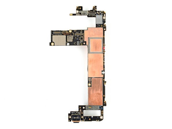

  65. Google Pixel Fold Logic Board Replacement, Only the logic board remains: passo 65, immagine 1 di 2 Google Pixel Fold Logic Board Replacement, Only the logic board remains: passo 65, immagine 2 di 2
    • You're now left with only the logic board.
