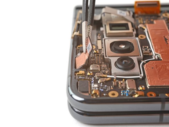

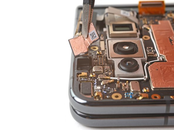

  32. Google Pixel Fold Base Front Camera Replacement: passo 32, immagine 1 di 3 Google Pixel Fold Base Front Camera Replacement: passo 32, immagine 2 di 3 Google Pixel Fold Base Front Camera Replacement: passo 32, immagine 3 di 3
    • Use a spudger, or your fingers, to press down the conductive tape and adhere it.
    • Use tweezers, or your fingers, to pull on the tab and expose the tape.

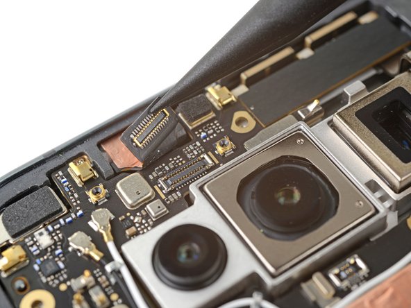

  35. Google Pixel Fold Base Front Camera Replacement, Disconnect the front camera: passo 35, immagine 1 di 2 Google Pixel Fold Base Front Camera Replacement, Disconnect the front camera: passo 35, immagine 2 di 2
    • Insert the point of a spudger under the bottom right corner of the front camera press connector.
    • Don't insert the spudger anywhere else, as you risk breaking surface-mounted components.
    • Pry up and disconnect the front camera press connector.

    • Grab the front camera by the neck of its connector, as close to the camera body as possible.
    • Don't press down on the press connector's pins, as you may bend them.
    • Pull straight up to separate the adhesive and remove the front camera.
