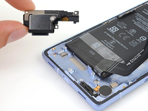

  29. Google Pixel 7a Loudspeaker Replacement, Remove the wireless charging assembly: passo 29, immagine 1 di 2 Google Pixel 7a Loudspeaker Replacement, Remove the wireless charging assembly: passo 29, immagine 2 di 2
    • Remove the wireless charging assembly.

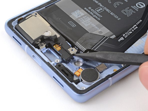

  32. Google Pixel 7a Loudspeaker Replacement, Disconnect the battery: passo 32, immagine 1 di 2 Google Pixel 7a Loudspeaker Replacement, Disconnect the battery: passo 32, immagine 2 di 2
    • Insert the flat end of a spudger under the top edge of the battery press connector.
    • Pry straight up to disconnect the battery press connector.

  51. Google Pixel 7a Loudspeaker Replacement, Pry up the loudspeaker: passo 51, immagine 1 di 2 Google Pixel 7a Loudspeaker Replacement, Pry up the loudspeaker: passo 51, immagine 2 di 2
    • Don't pry against the battery with your tool. Use protrusions in the frame for leverage.
    • Insert the point of your spudger between the top right corner of the loudspeaker and the frame.
    • There is a small slot below the silver screw tab. Insert your tool in this slot and not directly under the screw tab.
    • Pry up to free the loudspeaker from its recess.
  52. Google Pixel 7a Loudspeaker Replacement, Remove the loudspeaker: passo 52, immagine 1 di 2 Google Pixel 7a Loudspeaker Replacement, Remove the loudspeaker: passo 52, immagine 2 di 2
    • Lift the top edge of the loudspeaker to free its bottom gasket from the frame.
    • Remove the loudspeaker.
