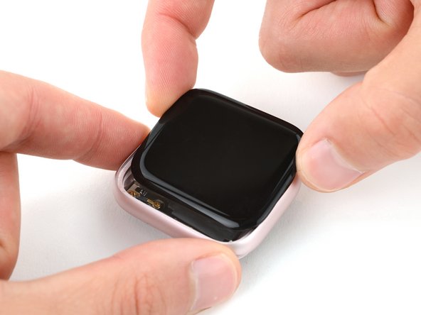

  6. Apple Watch Series 9 (45mm) Battery Replacement, Pry up the screen: passo 6, immagine 1 di 2 Apple Watch Series 9 (45mm) Battery Replacement, Pry up the screen: passo 6, immagine 2 di 2
    • Prying up the screen may take multiple attempts. If you're having trouble, apply more heat and try again.
    • With one hand, push down firmly on the watch's frame to secure it in place.
    • With your free hand, hold the iFlex and push the edges up to make it more rigid.
    • The iFlex should be slightly "U" shaped.
    • Pry up the screen enough for the iFlex to lay flat on its own.
    • The iFlex doesn't need to be inserted far, as it can easily damage the screen cables near the bottom right corner of the watch.
    • Leave the iFlex inserted under the screen.

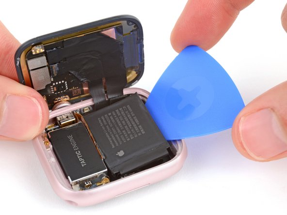

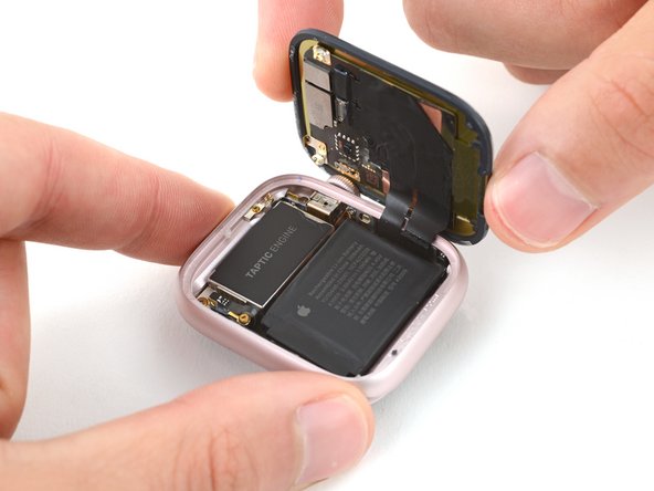

  13. Apple Watch Series 9 (45mm) Battery Replacement, Swing open the screen: passo 13, immagine 1 di 3 Apple Watch Series 9 (45mm) Battery Replacement, Swing open the screen: passo 13, immagine 2 di 3 Apple Watch Series 9 (45mm) Battery Replacement, Swing open the screen: passo 13, immagine 3 di 3
    • Pull the right edge of the screen over the digital crown.
    • If the screen feels stuck, go back around it with an opening pick to separate any adhesive.
    • Swing up the left edge of the screen so it's upright. The screen should be to the right of the digital crown.
    • During reassembly:
    • This is a good point to plug in your watch and test all functions before sealing it up. Be sure to power it back down completely before you continue working.
    • Follow this guide to apply new screen adhesive and reseal your watch.

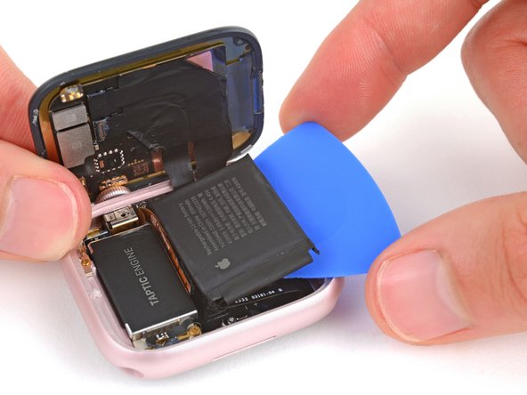

  15. Apple Watch Series 9 (45mm) Battery Replacement, Pry up the battery: passo 15, immagine 1 di 3 Apple Watch Series 9 (45mm) Battery Replacement, Pry up the battery: passo 15, immagine 2 di 3 Apple Watch Series 9 (45mm) Battery Replacement, Pry up the battery: passo 15, immagine 3 di 3
    • Be careful not to puncture or bend the battery—it can leak dangerous chemicals and catch fire.
    • Insert an opening pick between the bottom edge of the battery and frame.
    • Pry up the battery with the opening pick until it starts to separate from the frame.
    • This requires time and constant pressure. If you're having trouble, apply more heat and try again.
    • Slide the pick farther under the battery and lift until all the adhesive is separated.

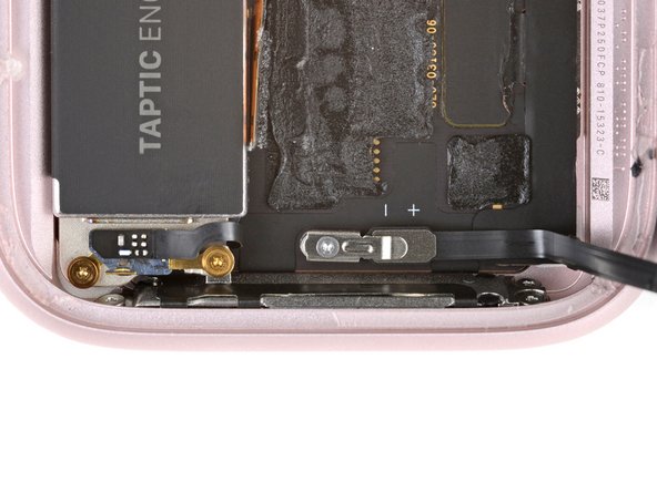

  17. Apple Watch Series 9 (45mm) Battery Replacement, Remove the battery connector screw: passo 17, immagine 1 di 2 Apple Watch Series 9 (45mm) Battery Replacement, Remove the battery connector screw: passo 17, immagine 2 di 2
    • Use a tri‑point Y000 screwdriver to remove the 1.1 mm‑long screw securing the battery connector bracket.
  18. Apple Watch Series 9 (45mm) Battery Replacement, Remove the bracket: passo 18, immagine 1 di 1
    Attrezzo utilizzato in questo passaggio:
    • Use a pair of tweezers to remove the battery connector bracket.
  19. Apple Watch Series 9 (45mm) Battery Replacement, Disconnect the battery: passo 19, immagine 1 di 2 Apple Watch Series 9 (45mm) Battery Replacement, Disconnect the battery: passo 19, immagine 2 di 2
    • Insert the point of a spudger under the short end of the battery connector (opposite the cable) and pry it up.

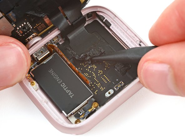

    • To install a new battery:
    • Use a spudger and tweezers to remove all the old adhesive from the battery recess.
    • If your replacement battery doesn't have adhesive pre-installed, put strips of thin, double-sided tape on the logic board (not directly on the battery) where the old adhesive was. Do not remove any liners yet.
    • Reconnect the battery cable press connector to its socket on the motherboard.
    • Put the battery connector bracket into place and install its screw. Make sure the metal arm goes over the battery press connector.
    • Remove any liners from the battery adhesive or double-sided tape.
    • Firmly press the battery into place to secure it with the adhesive.
