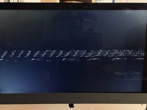

Please Help me, Screen Problem after Replacing HDD with SSD
Hi,
I did it twice before, replacing faulty hard disks in two iMacs, everything went ok, this 3rd machine (only one normal 3TB HDD), i just swapped the HDD with SSD (Samsung 860 EVO) following the guide, with the frame and heat sensor, upon testing I can hear the startup sound but the screen showing just strips, from the rubbish I can sense the system is booting from internet or just flashing folder, the usual sign that no operating system, I double checked the cables and can’t find anything wrong as far as I can tell, but I admit the data cable (the wide cable with lock) may be pushed hard when trying to insert it back, did I damage the screen or the board?, please advise…
I tried to remove and reinsert the cables but nothing changed, it is as it is…
Here is a preview:
Please accept my question and help me, I have no clue without your answer…

Hello guys and thanks for your responding, but it seems that there are some conflicts between my updates and your answers, so here is what I did…
after I swapped the HDD and fall into the screen problem, I swapped back the original HDD that has mac os on it and boot the iMac, the same screen issue continue but this time after the initial boot, the screen went black completely with no back light at all… so I connect the iMac to external Display (my Samsung 50” TV) and I can see the output but it is continuously flashing on & off, the keyboard, the mouse and the system is responding but the flash never stops…
I tried to search in the internet and I notice that many places point to the cable as a suspect so I connect another iMac using the same cable and the output was fine without any flashing…
so the iMac display has the problem shown above and the output to the external monitor is flashing continuously…
the iMac is working, programs and responding but the display is showing as above during the boot after that it turns off when the mac os reaches the log on screen, on the second monitor I see everything but with continuous flashing…
I double checked the display cables and the sockets on the board and they are fine with no visible marks as far as much as magnified as I can tell…
where does this put me…
I appreciate any information to lead me, should I give up or there is something I can replace for sure…
thank you all

here is something new and I didn’t expect it by any means…
today I received another 27” iMac, Late 2012 (EMC 2546) (with a dead hard disk) which is compatible with mine Late 2013 (EMC2639) and I connected the display from that machine to mine (which is suppose to have a problem in display), to my surprise the screen also shows the same symptoms as mine… I also connect my screen (which is suppose to be faulty) to the other iMac and it works perfectly…
So it is not the screen at all, my screen worked perfectly on the other iMac, also an external HDMI monitor connected to my iMac works perfectly which means ??
where does that puts me? what part of my iMac does not work?

You swapped HDD with SSD? Have you downloaded mac os ( or any operating system, that you like ).
da
No, I was just testing the imac, I just switch it on booting in recovery from internet and the screen was not working from the first start up...
da
Update:
I put back the original HDD that has operating system on it, when starting the screen is the same but after the initial boot, the screen turns off completely, no back light no anything, when connecting to external monitor using mini port connected to samsung tv 50” using HDMI, I can see the output but strangely the output flash on and off continuously, the keyboard, the mouse is working, I can logon but everything is flashing on and off...
Where does this put me?
Thank you
da
I think, that display might be kind of damaged, because, you had to take the display off. When you opened, the display or placed it back, you could had damaged connections? You should check the connections.
da
da

Sadly your display got damaged. During the the process of taking it off you likely damaged it. its very easy to damage if you don’t use the correct tools and follow the technique as outlined in the guide Sostituzione schermo iMac Intel 27" EMC 2639 and here’s the needed part [prodotto collegato mancante o disabilitato: IF174-035]. Presently iFixit is out of stock here’s the Apple P/N 661-7169.

OK, let's walk this back ...
Take the display off and disconnect it. Now plug in your external and restart the system are you able to get an external image?
Looking at the onboard diagnostic LED's what are they telling you? Look at the info in my Answer above.
Before you took the drive out did you make sure you don't have a Fusion Drive config in this system? Basically, you could have a second drive still installed (Blade SSD) which is confusing the system.

Hi @docmofix , sorry for my late answer, busy…, unfortunately, I was unable to resolve it despite all I did…
The 4 LED’s are ON when exactly? here is my test:
I reinstalled the original hard disk that still has the OS that was running Ok before I opened my iMac and I connect the screen back and start the machine, when I heard the startup sound, the 4 LED’s were ON but the screen still showing rubbish (which is the apple logo and the load progress bar), after that when the system reaches the logon screen, the 4th LED turns off and the screen too, completely off, no backlight no anything at all but on my external monitor connected through HDMI everything was OK, I logged on, browsed internet, start even adobe photoshop…., all was working…
I switched off the machine, disconnect the screen but kept the external HDMI monitor and start the machine again and had only 3 LED’s are on, so far the machine was normal accept the fans were running in full speed and that is normal if you notice the heat sensor connected on the screen…
I switched off again and I remembered some files I need so I start the machine in disk mode, for 20 minutes I can see the dancing logo on the external monitor and the high fan running while I copied everything…
something went wrong when I opened the machine the first time, I took care as I did on my two previous attempts but this time something went wrong…
All I can say but I am not sure, I remember I pulled the screen a little bit hard to free it from the machine, just a little bit because it was still stick, that is the only thing I didn’t do before…

@atheerioy - There is a thermal sensor within the display as you took the display off the sensor was lost to SMC which is why the fan is running high and you'll notice the system will be sluggish as well.
Once the display is reconnected the forth LED will come back on and the system should be back to normal.
da
@danj , that is right, but in my first test, the display was connected, the fan working Ok and ALL LED's were on at startup but the display was showing rubbish but as soon as the system reaches logon screen, the display completely turns off and the forth LED turns off...
da
Ouch! That does sound like your display is having problems. If an external works, if the external fails then your logic boards GPU is having issues.

I have the same problem on a late 2012 27” iMac after a SSD install. On this one, after the screen is blurry like that, it switches resolutions down to 720p. Then that is the only resolution it will display. The problem is a faulty display connection. It could either be the display data cable or the socket the cable plugs into. The socket itself is easy to break tiny (not easily observable with naked eye) pieces off and get them stuck between pins, meaning the cable will not fully seat or will not make a connection on all pins. I could only see it with camera zoom on my phone.
Broke off a corner
Piece of metal in connector
Anyway, try replacing the $20 display data cable. Or try getting a magnifier to look at the connector on the board. It wouldn't seat at all until I got the piece out. Now it does the behavior I described at the beginning, including the blurry screen. It seems to realize that the display is going wrong though and drops to 720p. So subsequent boots are no longer blurry like that but really pixellated from too low of resolution. I have to reset nvram to get it to try the higher resolution again. I’m afraid I will have to replace the board where the socket is.
This appears to have been a really common problem even fresh from the Apple Store. As evidenced by this compilation of questions about the same thing. The owner of this iMac tried to get the failing hard drive replaced at the Apple Store (after warranty), but they refused to do anything requiring the screen to come off. I should have taken this as a hint not to do this repair. They probably already knew from warranty work that these are very fragile to work on.
Update: I tried replacing the display cable but same effect.

Has anyone found the solution for this? I do not believe the issue is with the screen/ connectors or anything related. I have replaced 10+ SSDs on these machines with no problems.
When I boot off the original HDD there is no fault. However when I boot off the new SSD the screen becomes pixelated. I will try another SSD and see if that solves the issue.
If anyone has found a solution please let me know!

it is not related to the ssd, I put back the original HD, I started without HD and no difference at all, eventually I found another another similar logic board from a faulty machine and the HD and ssd worked with…
the only two reasons I can come up with are:
  • I some how damaged the board accidentally, a scratch here or there…
  • a matter of static electricity…
