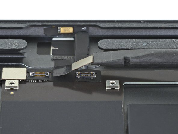

  26. iPad Air 3 Top Microphone Assembly Replacement, Peel up the microphone assembly: passo 26, immagine 1 di 3 iPad Air 3 Top Microphone Assembly Replacement, Peel up the microphone assembly: passo 26, immagine 2 di 3 iPad Air 3 Top Microphone Assembly Replacement, Peel up the microphone assembly: passo 26, immagine 3 di 3
    Attrezzo utilizzato in questo passaggio:
    Halberd Spudger
    $2.99
    • Insert an opening pick or a halberd spudger underneath the bottom of the microphone assembly cable.
    • Slice the adhesive securing the microphone assembly to the rear case.

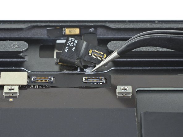

  27. iPad Air 3 Top Microphone Assembly Replacement, Remove the tape: passo 27, immagine 1 di 2 iPad Air 3 Top Microphone Assembly Replacement, Remove the tape: passo 27, immagine 2 di 2
    • Use a pair of tweezers to remove the tape securing the microphone assembly to the rear case.
  28. iPad Air 3 Top Microphone Assembly Replacement: passo 28, immagine 1 di 2 iPad Air 3 Top Microphone Assembly Replacement: passo 28, immagine 2 di 2
    • Use a pair of tweezers to remove the small strip of tape underneath the upper lip of the rear case.

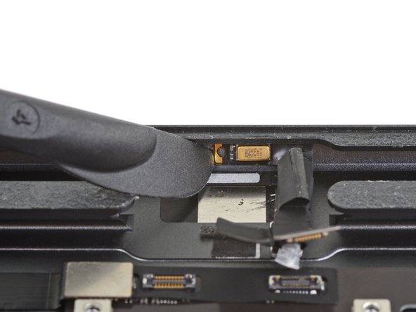

  29. iPad Air 3 Top Microphone Assembly Replacement, Peel up the lower microphone: passo 29, immagine 1 di 3 iPad Air 3 Top Microphone Assembly Replacement, Peel up the lower microphone: passo 29, immagine 2 di 3 iPad Air 3 Top Microphone Assembly Replacement, Peel up the lower microphone: passo 29, immagine 3 di 3
    • Insert an opening pick or a halberd spudger underneath the lower microphone and peel it up from the rear case.
  30. iPad Air 3 Top Microphone Assembly Replacement, Peel up the upper microphone: passo 30, immagine 1 di 3 iPad Air 3 Top Microphone Assembly Replacement, Peel up the upper microphone: passo 30, immagine 2 di 3 iPad Air 3 Top Microphone Assembly Replacement, Peel up the upper microphone: passo 30, immagine 3 di 3
    • Slide an opening pick or a halberd spudger behind the microphone located on the upper lip of the rear case.
    • Peel the upper microphone away from the rear case.
  31. iPad Air 3 Top Microphone Assembly Replacement, Remove the microphone assembly: passo 31, immagine 1 di 1
    • Remove the microphone assembly from the rear case.
