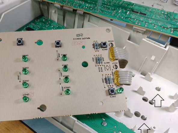

  10. Washing Machine Switch Replacement (fix control board), Unscrew the right circuit board: passo 10, immagine 1 di 3 Washing Machine Switch Replacement (fix control board), Unscrew the right circuit board: passo 10, immagine 2 di 3 Washing Machine Switch Replacement (fix control board), Unscrew the right circuit board: passo 10, immagine 3 di 3
    • Remove the four screws securing the right circuit board.
    • You can gently lift and flip the board to the left (as shown in the second picture). You can see the five switches on the front of the board.
    • It may be helpful to use a pen and draw a circle around each switch on the back (green side) of the board. This may save time when de-soldering the switches. Note: If any of your switches tested bad I'd change them all. At 20 cents each it's not worth opening the washing machine again later.

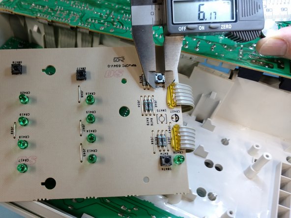

    • If you haven't measured the switches yet now is a good time. The third picture shows how I used a digital caliper to measure the switch so I knew what to order.

    • Try removing and replacing just one switch at first. This way you can compare the physical size, height, pin spacing, and actuator force between the new and old switch.
    • Once as much of the solder as possible is removed from the pins on the first switch I used a small flathead screwdriver to push on the pins to break them free from the board. If that doesn't work use the screw driver to gently pry the switch out from the front while heating the solder from the bottom.

    • Once the old switch is removed cut off one of the new switches (first picture) and compare the two switches. Leave enough pin length. You can always cut it shorter after soldering. Make sure it fits in the hole and that the button is roughly the same height as the old switch.
    • Note: The holes in my board are much larger than needed, even for the old switches. I found it helped to bend the pins to keep the switch from falling out of the board when I flip the board over to solder it.
    • Put the new switch in and hold it in place with one hand. Use your other hand to bend the leads in opposite directions. Bend it along the wide side of the rectangular leg (the easy way). The second picture shows the bent legs after one switch fell out before I could solder it.
    • Solder one of the switch legs to the board. Then flip the board over and see if the switch is lined up with the switch outline drawn on the front of the board. If it doesn't look centered, heat the solder and slide the switch a bit until centered.
    • Once the switch is centered put the board in place and hold it down while pressing the button on the front panel for the switch you just replaced. If you hear the switch click when the button is pressed then the switch is in the right place. If it clicked solder the remaining pin to the board.
    • If it doesn't click you probably need to move the switch a bit to line up with the plunger for that switch (arrows in third picture). Try looking at the plunger and the switch as you put the board in place to get an idea which way to move the switch. Re-heat the solder and slide the switch as needed and solder the remaining pin.
    • Once all the switches on the board have been replaced cut off excess lead length from the new switches.
    • Reinstall the board and screw it down.
    • Press each button one more time and listen for the click.

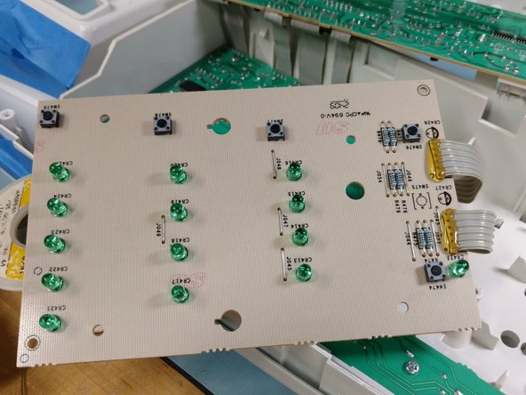

  13. Washing Machine Switch Replacement (fix control board), Unscrew the left circuit board: passo 14, immagine 1 di 3 Washing Machine Switch Replacement (fix control board), Unscrew the left circuit board: passo 14, immagine 2 di 3 Washing Machine Switch Replacement (fix control board), Unscrew the left circuit board: passo 14, immagine 3 di 3
    • Unscrew the left circuit board. Note: Mine had spots for 7 screws but only six were installed. Might not mater but I took a picture and made sure to put the screws back in the same holes.
    • The second picture shows two plastic tabs that have to be pressed towards each other to release the board. The tabs are far enough apart that I could press one at a time while lifting that side of the board.
    • Once the left board is loose change all the switches and check the alignment (listen for the click, same as the last board).
    • Trim the excess lead length.
    • Once all switches work screw the board back down and listen for clicks one last time.
