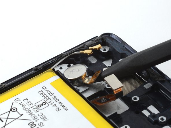

  36. Motorola Edge Screen Replacement, Weaken the vibrator's adhesive: passo 36, immagine 1 di 1
    • Use a drop or two of isopropyl alcohol to weaken the adhesive attaching the vibrator to the phone's frame.
    • Wait thirty seconds for the isopropyl alcohol to weaken the adhesive under the vibrator.
  37. Motorola Edge Screen Replacement, Detach the vibrator's ribbon cable: passo 37, immagine 1 di 3 Motorola Edge Screen Replacement, Detach the vibrator's ribbon cable: passo 37, immagine 2 di 3 Motorola Edge Screen Replacement, Detach the vibrator's ribbon cable: passo 37, immagine 3 di 3
    • Use an opening pick to carefully separate the vibrator's ribbon cable from the frame of the phone.
  38. Motorola Edge Screen Replacement, Remove the vibrator: passo 38, immagine 1 di 3 Motorola Edge Screen Replacement, Remove the vibrator: passo 38, immagine 2 di 3 Motorola Edge Screen Replacement, Remove the vibrator: passo 38, immagine 3 di 3
    • Use a spudger to carefully separate and remove the vibrator.
    • If there's any alcohol solution remaining in the phone, carefully wipe it off with a lint-free cloth or allow it to air dry before installing the vibrator.
    • During reassembly, follow this guide if you are using a pre-cut adhesive card to reinstall the vibrator.

    • Slide a plastic card under the battery, then carefully lift the battery up until the adhesive is loose enough to remove the battery.
  48. Motorola Edge Screen Replacement: passo 48, immagine 1 di 3 Motorola Edge Screen Replacement: passo 48, immagine 2 di 3 Motorola Edge Screen Replacement: passo 48, immagine 3 di 3
    • Separate and remove the battery from the midframe.
    • If the battery is deformed, dented, or damaged in any way, don't reinstall it. Reinstalling a damaged battery is a potential safety hazard. Replace it with a new one.
    • During reassembly, follow this guide if you are using a pre-cut adhesive card to reinstall the battery.
  49. Motorola Edge Screen Replacement, Replace the screen assembly: passo 49, immagine 1 di 1
    • The remainder of the components in the phone are included in the screen assembly. You can now re-assemble your device.
