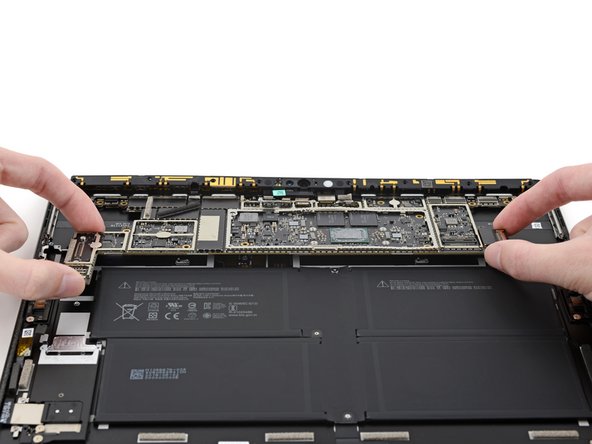

  15. Microsoft Surface Pro X Volume Button Cable Replacement, Open the Surface: passo 15, immagine 1 di 3 Microsoft Surface Pro X Volume Button Cable Replacement, Open the Surface: passo 15, immagine 2 di 3 Microsoft Surface Pro X Volume Button Cable Replacement, Open the Surface: passo 15, immagine 3 di 3
    • Do not remove the screen yet. It is still connected to the motherboard by the display cable. Keep the screen as close as possible to the Surface's frame to avoid straining the display cable.
    • Avoid hitting the battery with the screen during this procedure. A punctured or bent battery may leak dangerous chemicals or cause a thermal event.
    • Lift up the top edge of the screen so that it is at a 30° angle with the frame.
    • If you encounter any resistance, stop and check that all the adhesive is separated. Use an opening pick to cut through any remaining adhesive.
    • Rotate the screen so that its bottom edge is in the middle of the frame. The screen should be perpendicular to the frame.
    • Rotate the screen 90° so that it is facing down. Place the screen on the frame.

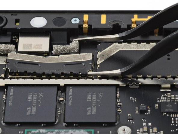

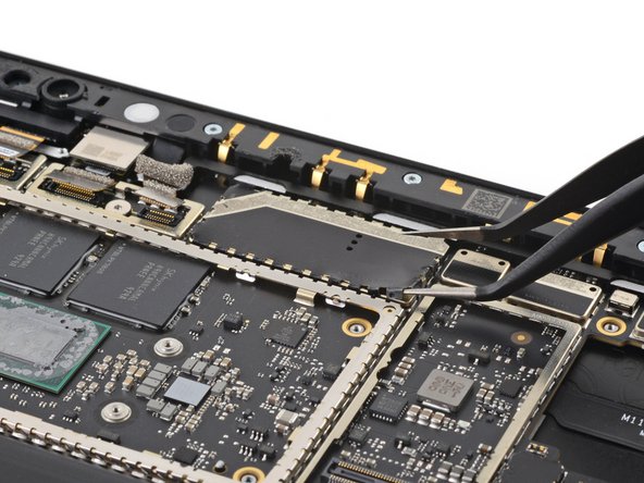

  16. Microsoft Surface Pro X Volume Button Cable Replacement, Remove the display cable shield: passo 16, immagine 1 di 3 Microsoft Surface Pro X Volume Button Cable Replacement, Remove the display cable shield: passo 16, immagine 2 di 3 Microsoft Surface Pro X Volume Button Cable Replacement, Remove the display cable shield: passo 16, immagine 3 di 3
    Attrezzo utilizzato in questo passaggio:
    • Insert a tine of a pair of pointed tweezers under the bottom right corner of the display cable shield (where the display cable is oriented down).
    • Lift up the corner to detach it from the screen.

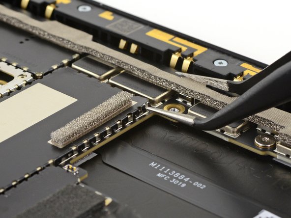

  17. Microsoft Surface Pro X Volume Button Cable Replacement: passo 17, immagine 1 di 2 Microsoft Surface Pro X Volume Button Cable Replacement: passo 17, immagine 2 di 2
    • Repeat the previous step for the bottom right corner.
  18. Microsoft Surface Pro X Volume Button Cable Replacement: passo 18, immagine 1 di 1
    • Remove the display cable shield from the screen.
    • If the display cable shield isn't completely detached from the screen, pry up additional areas around the edges of the shield.

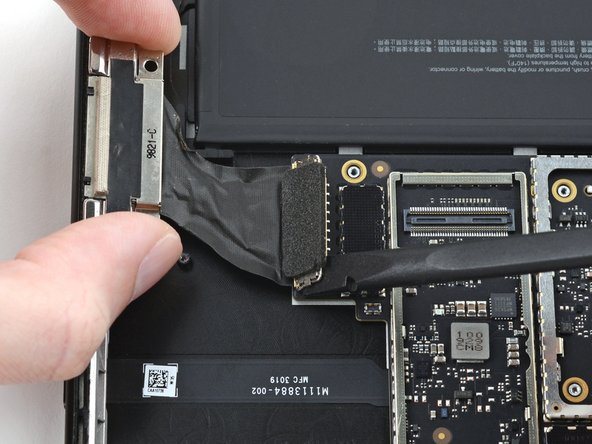

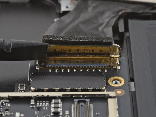

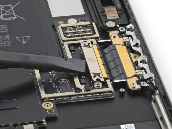

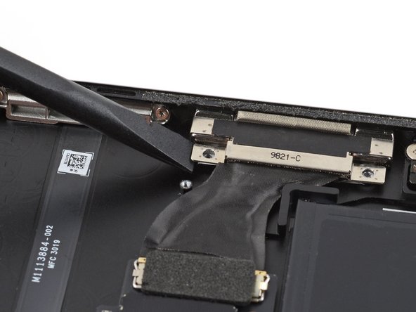

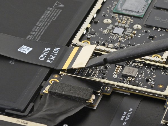

  19. Microsoft Surface Pro X Volume Button Cable Replacement, Disconnect the screen: passo 19, immagine 1 di 2 Microsoft Surface Pro X Volume Button Cable Replacement, Disconnect the screen: passo 19, immagine 2 di 2
    • Insert the pointed end of a spudger under the right side of the display cable press connector.
    • Lift up the right side of the press connector to detach it from the display cable socket on the screen.
  20. Microsoft Surface Pro X Volume Button Cable Replacement: passo 20, immagine 1 di 2 Microsoft Surface Pro X Volume Button Cable Replacement: passo 20, immagine 2 di 2
    • Repeat the previous step on the left side of the display cable connector to fully disconnect it from the screen.
    • To re-attach press connectors like this one, carefully align and press down on one side until it clicks into place, then repeat on the other side. Do not press down on the middle. If the connector is misaligned, the pins can bend, causing permanent damage.

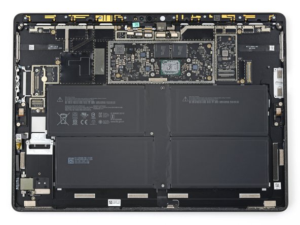

  21. Microsoft Surface Pro X Volume Button Cable Replacement, Remove the screen: passo 21, immagine 1 di 1
    • Remove the screen from the frame.

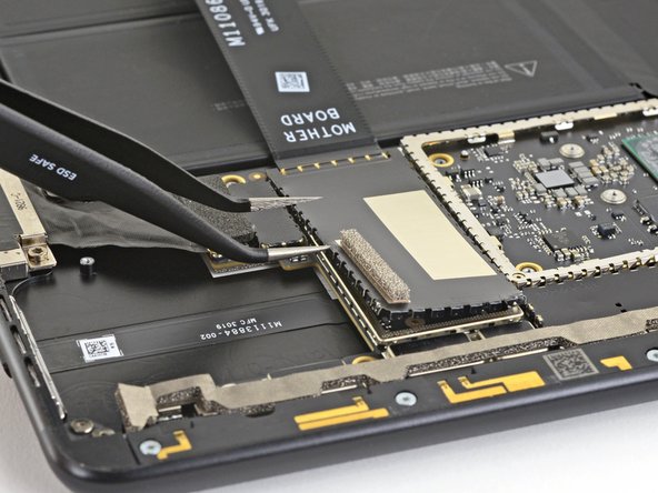

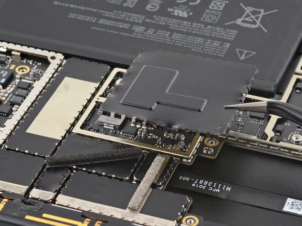

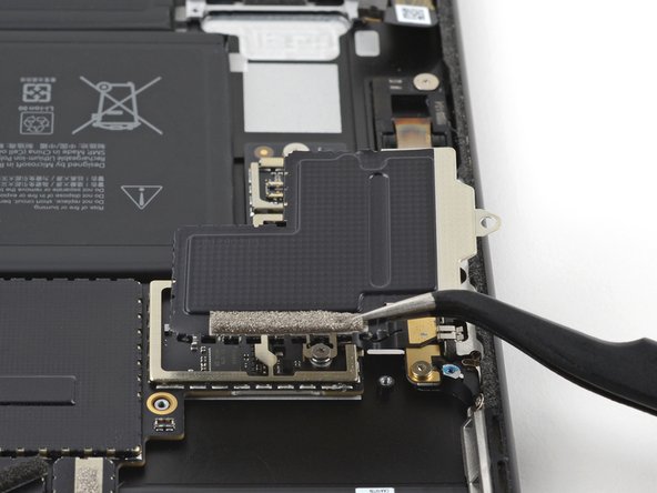

  25. Microsoft Surface Pro X Volume Button Cable Replacement, Remove the heat sink sticker: passo 25, immagine 1 di 2 Microsoft Surface Pro X Volume Button Cable Replacement, Remove the heat sink sticker: passo 25, immagine 2 di 2
    • If you are going to reinstall this sticker during reassembly, try to keep it as intact as possible.
    • Lift up the edge of the heat sink sticker closest to the bottom edge of the Surface.
  26. Microsoft Surface Pro X Volume Button Cable Replacement: passo 26, immagine 1 di 2 Microsoft Surface Pro X Volume Button Cable Replacement: passo 26, immagine 2 di 2
    • Lift up the center of the sticker.
  27. Microsoft Surface Pro X Volume Button Cable Replacement: passo 27, immagine 1 di 3 Microsoft Surface Pro X Volume Button Cable Replacement: passo 27, immagine 2 di 3 Microsoft Surface Pro X Volume Button Cable Replacement: passo 27, immagine 3 di 3
    • Lift up one side of the sticker attached to the heat sink.
    • Repeat for the other side. The sticker should now be fully detached.
    • Remove the sticker.

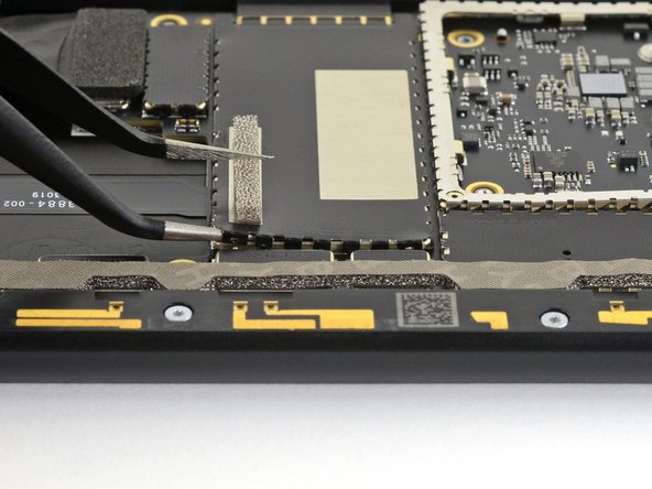

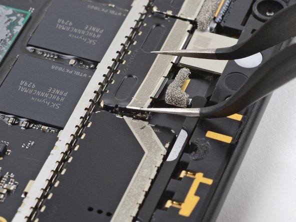

  28. Microsoft Surface Pro X Volume Button Cable Replacement, Remove the screw stickers: passo 28, immagine 1 di 2 Microsoft Surface Pro X Volume Button Cable Replacement, Remove the screw stickers: passo 28, immagine 2 di 2
    • If you are going to reinstall these stickers during reassembly, try to keep them as intact as possible. These stickers can tear easily during removal.
    • Use an opening tool to lift up the edge of one of the small black stickers covering the four screws in the center of the heat sink.
    • You only need to lift the edge enough to grip it with tweezers.
  29. Microsoft Surface Pro X Volume Button Cable Replacement: passo 29, immagine 1 di 2 Microsoft Surface Pro X Volume Button Cable Replacement: passo 29, immagine 2 di 2
    • Use a pair of blunt tweezers to remove the sticker covering the heat sink screw.
    • Repeat this process for the other three stickers.

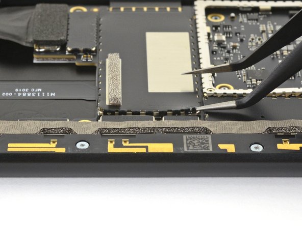

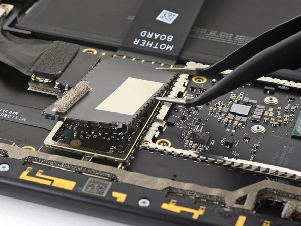

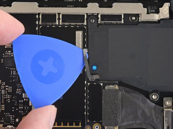

  31. Microsoft Surface Pro X Volume Button Cable Replacement, Remove the heat sink: passo 31, immagine 1 di 2 Microsoft Surface Pro X Volume Button Cable Replacement, Remove the heat sink: passo 31, immagine 2 di 2
    • The heat sink is adhered to the CPU with thermal paste.
    • Insert an opening pick about 2 mm under the heat sink at its bottom edge directly to the left of the display cable.
    • The opening pick should be between the heat sink and the frame surrounding the motherboard.
    • Slide the opening pick to the left toward the heat pipe to detach the heat sink from the CPU.
  32. Microsoft Surface Pro X Volume Button Cable Replacement: passo 32, immagine 1 di 2 Microsoft Surface Pro X Volume Button Cable Replacement: passo 32, immagine 2 di 2
    • Swing the bottom edge of the heat sink up so that it is at about a 10° angle with the frame.
  33. Microsoft Surface Pro X Volume Button Cable Replacement: passo 33, immagine 1 di 3 Microsoft Surface Pro X Volume Button Cable Replacement: passo 33, immagine 2 di 3 Microsoft Surface Pro X Volume Button Cable Replacement: passo 33, immagine 3 di 3

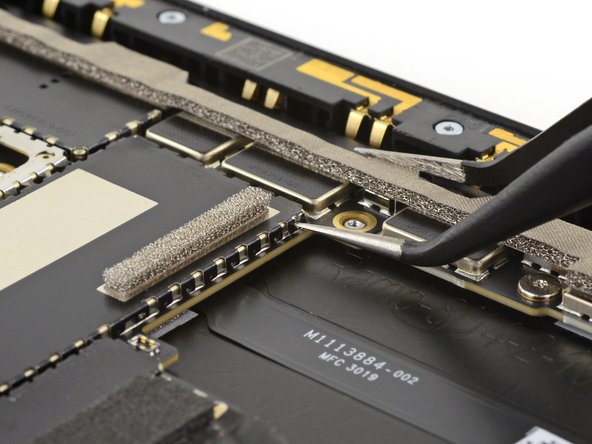

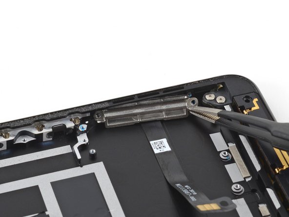

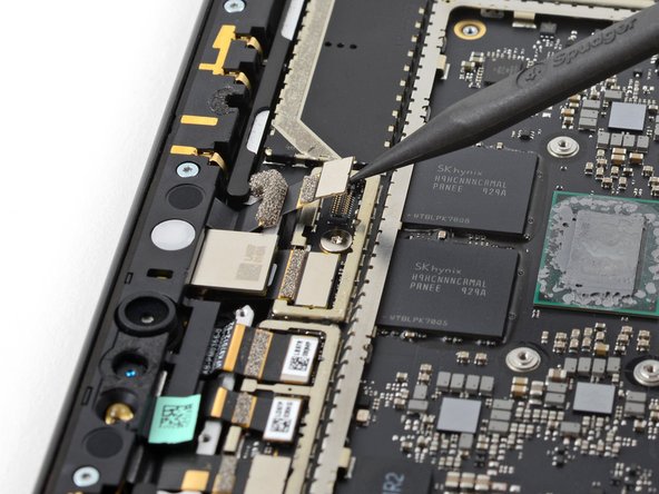

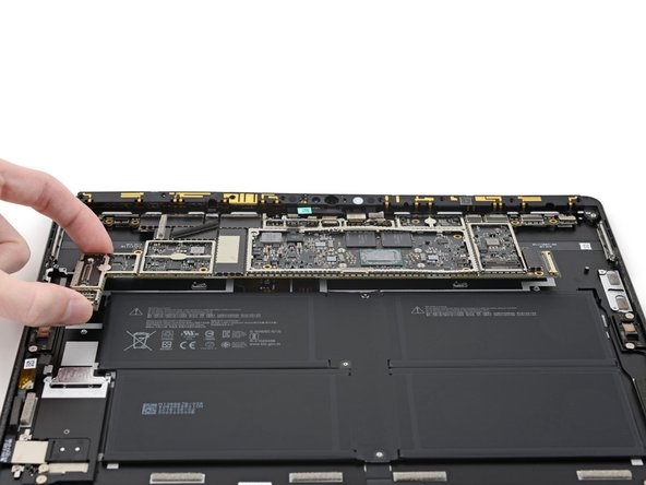

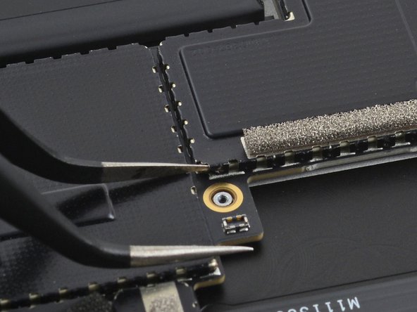

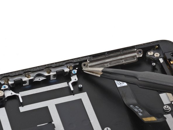

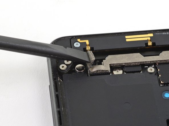

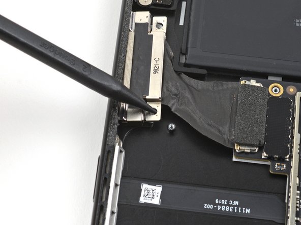

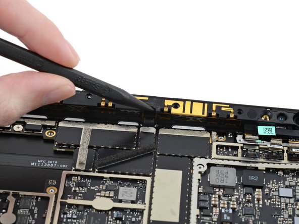

  34. Microsoft Surface Pro X Volume Button Cable Replacement, Disconnect the right speaker: passo 34, immagine 1 di 2 Microsoft Surface Pro X Volume Button Cable Replacement, Disconnect the right speaker: passo 34, immagine 2 di 2
    • Use the pointed end of a spudger to disconnect the right speaker's press connector from its socket.

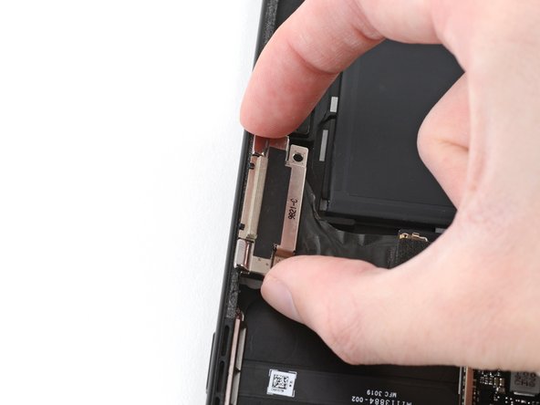

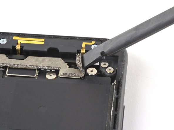

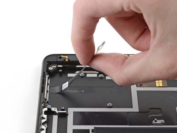

  35. Microsoft Surface Pro X Volume Button Cable Replacement, Detach the right speaker's cable: passo 35, immagine 1 di 2 Microsoft Surface Pro X Volume Button Cable Replacement, Detach the right speaker's cable: passo 35, immagine 2 di 2
    • Use an opening pick to cut through the adhesive under the right speaker's cable and detach it from the frame.
  36. Microsoft Surface Pro X Volume Button Cable Replacement, Lift up the foam adhesive: passo 36, immagine 1 di 2 Microsoft Surface Pro X Volume Button Cable Replacement, Lift up the foam adhesive: passo 36, immagine 2 di 2
    • Use the flat end of a spudger to lift up the foam adhesive covering the right speaker's top right screw.

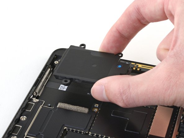

  37. Microsoft Surface Pro X Volume Button Cable Replacement, Remove the right speaker screws: passo 37, immagine 1 di 1
    • Remove the two screws securing the right speaker:

  39. Microsoft Surface Pro X Volume Button Cable Replacement, Remove the display cable shield: passo 39, immagine 1 di 3 Microsoft Surface Pro X Volume Button Cable Replacement, Remove the display cable shield: passo 39, immagine 2 di 3 Microsoft Surface Pro X Volume Button Cable Replacement, Remove the display cable shield: passo 39, immagine 3 di 3
    • Take care not to puncture or bend the battery with your tweezers—a punctured or bent battery may leak dangerous chemicals or cause a thermal event.
    • If you are going to reuse this shield, try to avoid excessively bending it during removal.
    • Note that the display cable is oriented down for this shield removal procedure.
    • Insert one tine of a pair of pointed tweezers into a divot on a tab in the top right corner of the display cable shield.
    • Lift up the corner to detach it from the frame.
  40. Microsoft Surface Pro X Volume Button Cable Replacement: passo 40, immagine 1 di 3 Microsoft Surface Pro X Volume Button Cable Replacement: passo 40, immagine 2 di 3 Microsoft Surface Pro X Volume Button Cable Replacement: passo 40, immagine 3 di 3
    • Slide one tine of a pair of pointed tweezers under the right side of the top edge of the shield to detach it from the frame.
    • Repeat for the left side of the top edge.
  41. Microsoft Surface Pro X Volume Button Cable Replacement: passo 41, immagine 1 di 3 Microsoft Surface Pro X Volume Button Cable Replacement: passo 41, immagine 2 di 3 Microsoft Surface Pro X Volume Button Cable Replacement: passo 41, immagine 3 di 3
    • Slide one tine of a pair of pointed tweezers under the right side of the top edge of the shield.
    • Lift up the top edge to further detach it from the frame.
  42. Microsoft Surface Pro X Volume Button Cable Replacement: passo 42, immagine 1 di 2 Microsoft Surface Pro X Volume Button Cable Replacement: passo 42, immagine 2 di 2
    • Slide one tine of a pair of pointed tweezers under the top side of the right edge of the shield.
    • Lift up to detach the top section of the shield from the frame.
    • Repeat for the top side of the left edge.
  43. Microsoft Surface Pro X Volume Button Cable Replacement: passo 43, immagine 1 di 2 Microsoft Surface Pro X Volume Button Cable Replacement: passo 43, immagine 2 di 2
    • Insert one tine of a pair of pointed tweezers under the right edge of the shield near the top right corner.
    • Lift up to further detach the shield from the frame.
  44. Microsoft Surface Pro X Volume Button Cable Replacement: passo 44, immagine 1 di 2 Microsoft Surface Pro X Volume Button Cable Replacement: passo 44, immagine 2 di 2
    • Repeat the previous step for the center of the right edge of the shield.
  45. Microsoft Surface Pro X Volume Button Cable Replacement: passo 45, immagine 1 di 2 Microsoft Surface Pro X Volume Button Cable Replacement: passo 45, immagine 2 di 2
    • Insert one tine of a pair of pointed tweezers under the left edge of the shield near the top left corner.
  46. Microsoft Surface Pro X Volume Button Cable Replacement: passo 46, immagine 1 di 2 Microsoft Surface Pro X Volume Button Cable Replacement: passo 46, immagine 2 di 2
    • Repeat the previous step for the center of the left edge of the shield.
  47. Microsoft Surface Pro X Volume Button Cable Replacement: passo 47, immagine 1 di 2 Microsoft Surface Pro X Volume Button Cable Replacement: passo 47, immagine 2 di 2
    • Insert one tine of a pair of pointed tweezers under the right edge of the shield near the bottom right corner.
    • Lift up the right edge to detach the shield from the frame.
  48. Microsoft Surface Pro X Volume Button Cable Replacement: passo 48, immagine 1 di 1
    • Remove the display cable shield.
    • If the shield isn't completely detached from the frame, pry up additional areas around the edges of the shield.

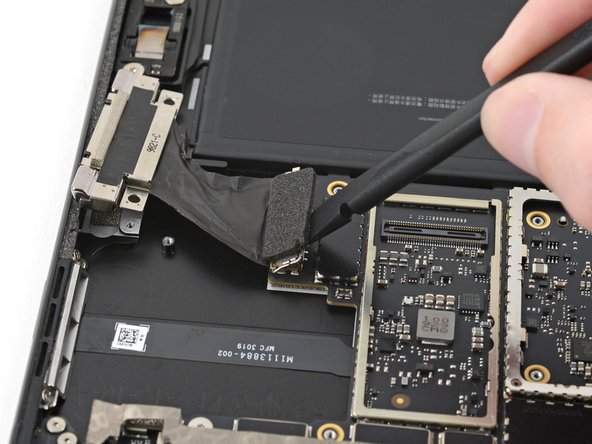

  49. Microsoft Surface Pro X Volume Button Cable Replacement, Disconnect the display cable: passo 49, immagine 1 di 2 Microsoft Surface Pro X Volume Button Cable Replacement, Disconnect the display cable: passo 49, immagine 2 di 2
    • Use the flat end of a spudger to disconnect the display cable press connector from its socket.
  50. Microsoft Surface Pro X Volume Button Cable Replacement, Remove the display cable: passo 50, immagine 1 di 1
    • Remove the display cable from the Surface.

  55. Microsoft Surface Pro X Volume Button Cable Replacement, Remove the left speaker: passo 55, immagine 1 di 3 Microsoft Surface Pro X Volume Button Cable Replacement, Remove the left speaker: passo 55, immagine 2 di 3 Microsoft Surface Pro X Volume Button Cable Replacement, Remove the left speaker: passo 55, immagine 3 di 3
    • Use the flat end of a spudger to lift the cable side of the left speaker enough to grab it with your fingers.
    • Remove the left speaker from the frame.
  56. Microsoft Surface Pro X Volume Button Cable Replacement, Lift the corner of the shield: passo 56, immagine 1 di 2 Microsoft Surface Pro X Volume Button Cable Replacement, Lift the corner of the shield: passo 56, immagine 2 di 2
    • Take care not to puncture or bend the battery with any tools while removing the SSD port—a punctured or bent battery may leak dangerous chemicals or cause a thermal event.
    • Insert one tine of a pair of pointed tweezers under the top left corner of the SSD port connector's shield (where the cable is oriented down).
  57. Microsoft Surface Pro X Volume Button Cable Replacement, Remove the shield: passo 57, immagine 1 di 2 Microsoft Surface Pro X Volume Button Cable Replacement, Remove the shield: passo 57, immagine 2 di 2
    • Remove the SSD port connector's shield.
    • If the shield isn't completely detached from the frame, pry up additional areas on the edges of the shield.

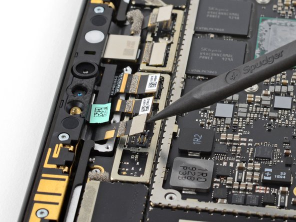

  67. Microsoft Surface Pro X Volume Button Cable Replacement, Remove the front camera shield: passo 67, immagine 1 di 2 Microsoft Surface Pro X Volume Button Cable Replacement, Remove the front camera shield: passo 67, immagine 2 di 2
    • Insert one tine of a pair of pointed tweezers under one corner of the shield covering the front camera connector.
  68. Microsoft Surface Pro X Volume Button Cable Replacement: passo 68, immagine 1 di 3 Microsoft Surface Pro X Volume Button Cable Replacement: passo 68, immagine 2 di 3 Microsoft Surface Pro X Volume Button Cable Replacement: passo 68, immagine 3 di 3
    • Repeat the previous step for the other three corners of the shield.

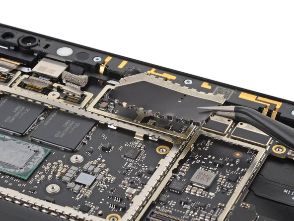

  73. Microsoft Surface Pro X Volume Button Cable Replacement, Remove the rear camera shield: passo 73, immagine 1 di 2 Microsoft Surface Pro X Volume Button Cable Replacement, Remove the rear camera shield: passo 73, immagine 2 di 2
    • Insert one tine of a pair of pointed tweezers under one corner of the shield covering the rear camera connector.
  74. Microsoft Surface Pro X Volume Button Cable Replacement: passo 74, immagine 1 di 3 Microsoft Surface Pro X Volume Button Cable Replacement: passo 74, immagine 2 di 3 Microsoft Surface Pro X Volume Button Cable Replacement: passo 74, immagine 3 di 3
    • Repeat the previous step for the remaining three corners of the shield.
  75. Microsoft Surface Pro X Volume Button Cable Replacement: passo 75, immagine 1 di 2 Microsoft Surface Pro X Volume Button Cable Replacement: passo 75, immagine 2 di 2
    • Use a pair of pointed tweezers to lift up the left side of the shield.
  76. Microsoft Surface Pro X Volume Button Cable Replacement: passo 76, immagine 1 di 2 Microsoft Surface Pro X Volume Button Cable Replacement: passo 76, immagine 2 di 2
    • Slide one tine of a pair of pointed tweezers under the bottom right edge of the shield to fully detach it from the frame.
  77. Microsoft Surface Pro X Volume Button Cable Replacement: passo 77, immagine 1 di 1
    • Remove the shield covering the rear camera connector.

  83. Microsoft Surface Pro X Volume Button Cable Replacement, Disconnect the Surface Connect port: passo 83, immagine 1 di 2 Microsoft Surface Pro X Volume Button Cable Replacement, Disconnect the Surface Connect port: passo 83, immagine 2 di 2
    • Insert the flat end of a spudger under the foam on top of the Surface Connect port's connector.
    • Lift up on the foam to open the connector's locking tab.
  84. Microsoft Surface Pro X Volume Button Cable Replacement: passo 84, immagine 1 di 3 Microsoft Surface Pro X Volume Button Cable Replacement: passo 84, immagine 2 di 3 Microsoft Surface Pro X Volume Button Cable Replacement: passo 84, immagine 3 di 3
    • Place the flat end of a spudger under the left edge of the connector's locking tab.
    • While holding the Surface Connect port with your fingers, push the connector out of its socket in the direction of the cable.
    • If this doesn't fully disconnect the connector, repeat this step for the right edge of the locking tab. Alternate between the left and right edge as needed.
  85. Microsoft Surface Pro X Volume Button Cable Replacement, Remove the Surface Connect port: passo 85, immagine 1 di 2 Microsoft Surface Pro X Volume Button Cable Replacement, Remove the Surface Connect port: passo 85, immagine 2 di 2
    • Remove the Surface Connect port from the frame.

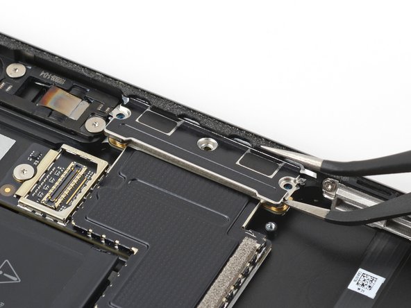

  86. Microsoft Surface Pro X Volume Button Cable Replacement, Remove the USB-C port shield screws: passo 86, immagine 1 di 1
    • Use a T3 Torx screwdriver to remove the three 2.9 mm screws securing the first USB-C port shield.
  87. Microsoft Surface Pro X Volume Button Cable Replacement, Remove the first USB-C port shield: passo 87, immagine 1 di 3 Microsoft Surface Pro X Volume Button Cable Replacement, Remove the first USB-C port shield: passo 87, immagine 2 di 3 Microsoft Surface Pro X Volume Button Cable Replacement, Remove the first USB-C port shield: passo 87, immagine 3 di 3
    • If you are going to reuse the USB-C port shields, try to avoid excessively bending them during removal.
    • Insert one tine of a pair of pointed tweezers into the gap in the first USB-C port shield next to the screw hole closest to the left speaker.
    • Lift up the shield to detach it from the frame.
  88. Microsoft Surface Pro X Volume Button Cable Replacement: passo 88, immagine 1 di 1
    • Remove the first USB-C port shield from the frame.
  89. Microsoft Surface Pro X Volume Button Cable Replacement, Remove the second USB-C port shield: passo 89, immagine 1 di 3 Microsoft Surface Pro X Volume Button Cable Replacement, Remove the second USB-C port shield: passo 89, immagine 2 di 3 Microsoft Surface Pro X Volume Button Cable Replacement, Remove the second USB-C port shield: passo 89, immagine 3 di 3
    • Don't pry up the USB-C port shield near the battery—a punctured or bent battery may leak dangerous chemicals or cause a thermal event.
    • Insert one tine of a pair of pointed tweezers under one of the shield's corners closest to the left speaker recess.
    • Slide the tine along the edge of the shield to detach the corner from the frame.
  90. Microsoft Surface Pro X Volume Button Cable Replacement: passo 90, immagine 1 di 3 Microsoft Surface Pro X Volume Button Cable Replacement: passo 90, immagine 2 di 3 Microsoft Surface Pro X Volume Button Cable Replacement: passo 90, immagine 3 di 3
    • Note that the second USB-C port shield may fling off of the frame when you detach it. You can place a finger on the shield to prevent it from flinging.
    • Repeat the previous step for the other corner of the shield closest to the left speaker recess.
    • Continue prying up the edge of the shield closest to the left speaker recess until the shield detaches from the frame.
    • Remove the shield from the frame.
  91. Microsoft Surface Pro X Volume Button Cable Replacement, Remove the USB-C port press connector screws: passo 91, immagine 1 di 1
    • Use a T3 Torx screwdriver to remove the two 2 mm screws securing the USB-C port press connector.
  92. Microsoft Surface Pro X Volume Button Cable Replacement: passo 92, immagine 1 di 2 Microsoft Surface Pro X Volume Button Cable Replacement: passo 92, immagine 2 di 2
    • Insert the flat end of a spudger under the long edge of the USB-C port press connector.
    • Rotate the flat end of the spudger to disconnect the press connector from its socket.

  95. Microsoft Surface Pro X Volume Button Cable Replacement, Disconnect the sensor bar components: passo 95, immagine 1 di 3 Microsoft Surface Pro X Volume Button Cable Replacement, Disconnect the sensor bar components: passo 95, immagine 2 di 3 Microsoft Surface Pro X Volume Button Cable Replacement, Disconnect the sensor bar components: passo 95, immagine 3 di 3
    • Use the pointed end of a spudger to disconnect the right microphone press connector from its socket.
    • Disconnect the rear camera.
  96. Microsoft Surface Pro X Volume Button Cable Replacement: passo 96, immagine 1 di 3 Microsoft Surface Pro X Volume Button Cable Replacement: passo 96, immagine 2 di 3 Microsoft Surface Pro X Volume Button Cable Replacement: passo 96, immagine 3 di 3
    • Use the pointed end of a spudger to disconnect the front camera, the Windows Hello face camera, and the left microphone.
  97. Microsoft Surface Pro X Volume Button Cable Replacement, Motherboard shield information: passo 97, immagine 1 di 2 Microsoft Surface Pro X Volume Button Cable Replacement, Motherboard shield information: passo 97, immagine 2 di 2
    • There are two shields on the motherboard covering screws that secure it to the frame:
    • One square shield to the right of the USB-C port.
    • One rectangular shield to the right of the camera connector sockets.

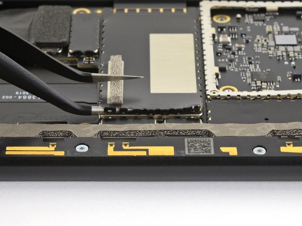

  98. Microsoft Surface Pro X Volume Button Cable Replacement, Remove the two shields: passo 98, immagine 1 di 3 Microsoft Surface Pro X Volume Button Cable Replacement, Remove the two shields: passo 98, immagine 2 di 3 Microsoft Surface Pro X Volume Button Cable Replacement, Remove the two shields: passo 98, immagine 3 di 3
    • Avoid prying near the battery while removing the shields—a punctured or bent battery may leak dangerous chemicals or cause a thermal event.
    • Note that the shields may fling off of the frame when you detach them. You can place a finger on the shield to prevent it from flinging.
    • Insert one tine of a pair of pointed tweezers under a corner of the square shield.
    • Continue to pry up additional areas around the edges of the shield until it detaches from the frame.
    • Remove the square shield.
    • If you are going to reuse these shields, try to avoid excessively bending them during removal.
  99. Microsoft Surface Pro X Volume Button Cable Replacement: passo 99, immagine 1 di 3 Microsoft Surface Pro X Volume Button Cable Replacement: passo 99, immagine 2 di 3 Microsoft Surface Pro X Volume Button Cable Replacement: passo 99, immagine 3 di 3
    • Repeat the previous step to remove the rectangular shield.

  101. Microsoft Surface Pro X Volume Button Cable Replacement, Dislodge the front-facing sensor bar: passo 101, immagine 1 di 2 Microsoft Surface Pro X Volume Button Cable Replacement, Dislodge the front-facing sensor bar: passo 101, immagine 2 di 2
    • Insert the pointed end of a spudger into the gap on the right side of the sensor bar between the rightmost screw hole and the adjacent screw hole.
    • Lift up the right side of the sensor bar to dislodge it from the frame.
    • You only need to lift the sensor bar so that it is loose in the frame. Don't try to remove the front sensor bar—it is still attached to the Surface by a cable that connects under the motherboard.
  102. Microsoft Surface Pro X Volume Button Cable Replacement: passo 102, immagine 1 di 2 Microsoft Surface Pro X Volume Button Cable Replacement: passo 102, immagine 2 di 2
    • Repeat the previous step for the gap in the sensor bar between the second and third screw hole from the left.
    • This gap is where the sensor bar's cable is located.
  103. Microsoft Surface Pro X Volume Button Cable Replacement, Lift the front-facing sensor bar: passo 103, immagine 1 di 1
    • The motherboard has spring connectors that fit under the front-facing sensor bar. Lifting the sensor bar makes it easier to remove and replace the motherboard.
    • Lift the sensor bar about 30° out of its recess.
    • Don't push the sensor bar past 90° and don't rotate it horizontally to avoid damaging the cable connecting it to the motherboard.

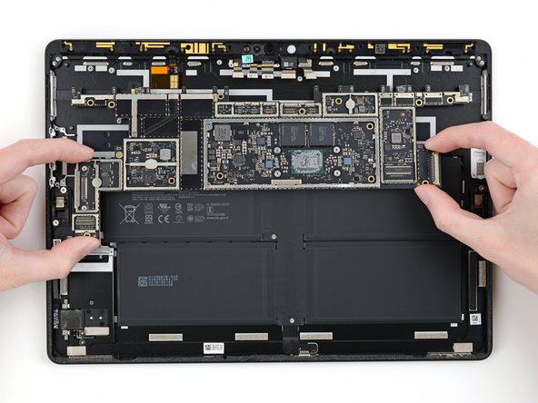

  104. Microsoft Surface Pro X Volume Button Cable Replacement, Remove the motherboard screws: passo 104, immagine 1 di 1
    • Use a T3 Torx screwdriver to remove the six 2 mm screws securing the motherboard.

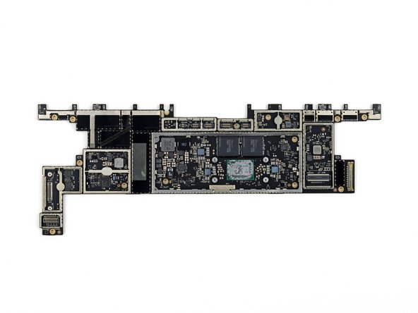

  105. Microsoft Surface Pro X Volume Button Cable Replacement, Remove the motherboard: passo 105, immagine 1 di 3 Microsoft Surface Pro X Volume Button Cable Replacement, Remove the motherboard: passo 105, immagine 2 di 3 Microsoft Surface Pro X Volume Button Cable Replacement, Remove the motherboard: passo 105, immagine 3 di 3
    • Lift the bottom edge of the motherboard about a half-centimeter above the frame.
    • You only need to lift the motherboard high enough for it to clear the battery as you slide it out.
    • Hold the motherboard on the left and right edge.
  106. Microsoft Surface Pro X Volume Button Cable Replacement: passo 106, immagine 1 di 3 Microsoft Surface Pro X Volume Button Cable Replacement: passo 106, immagine 2 di 3 Microsoft Surface Pro X Volume Button Cable Replacement: passo 106, immagine 3 di 3
    • Pull the motherboard down toward the bottom edge of the Surface to remove it from the frame.

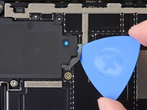

  107. Microsoft Surface Pro X Volume Button Cable Replacement, Detach the volume button cable: passo 107, immagine 1 di 3 Microsoft Surface Pro X Volume Button Cable Replacement, Detach the volume button cable: passo 107, immagine 2 di 3 Microsoft Surface Pro X Volume Button Cable Replacement, Detach the volume button cable: passo 107, immagine 3 di 3
    • The volume button cable is lightly adhered to the frame.
    • Use an opening pick to cut through the adhesive on the right side of the bottom edge of the volume button cable.
    • Slide the opening pick under the right side of the volume button cable to further detach it from the frame.

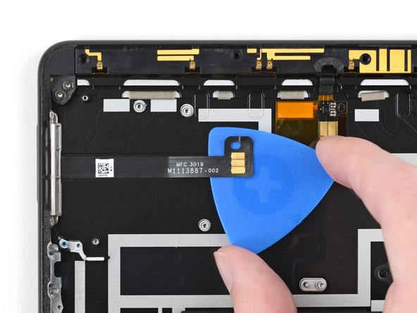

  108. Microsoft Surface Pro X Volume Button Cable Replacement: passo 108, immagine 1 di 1
    • Apply a few drops of high-concentration (90% or higher) isopropyl alcohol under the volume button cable.
    • Wait thirty seconds for the isopropyl alcohol to weaken the adhesive.
  109. Microsoft Surface Pro X Volume Button Cable Replacement: passo 109, immagine 1 di 2 Microsoft Surface Pro X Volume Button Cable Replacement: passo 109, immagine 2 di 2
    • Lift the volume button cable away from the frame.
    • If the volume button cable doesn't easily lift away, apply a few more drops of isopropyl alcohol before trying again.

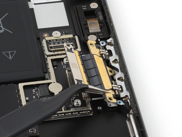

  110. Microsoft Surface Pro X Volume Button Cable Replacement, Remove the volume button bracket screws: passo 110, immagine 1 di 1
    • Use a T3 screwdriver to remove the two 2.4 mm screws securing the volume button bracket.

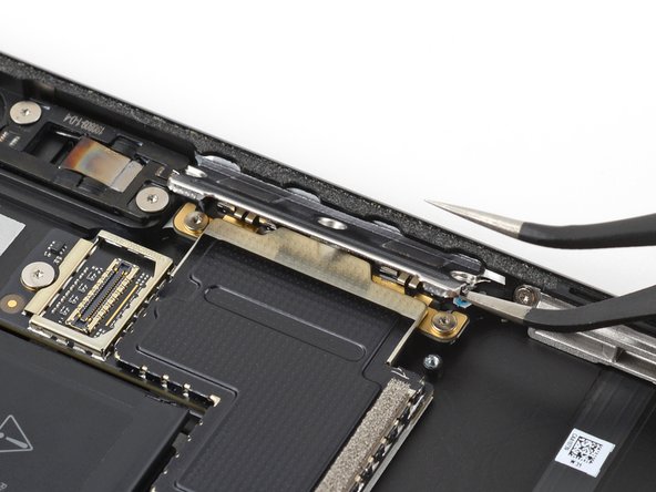

  111. Microsoft Surface Pro X Volume Button Cable Replacement, Detach the volume button bracket: passo 111, immagine 1 di 2 Microsoft Surface Pro X Volume Button Cable Replacement, Detach the volume button bracket: passo 111, immagine 2 di 2
    • Use a pair of blunt tweezers to pull the right side of the volume button bracket straight out of the frame.
  112. Microsoft Surface Pro X Volume Button Cable Replacement: passo 112, immagine 1 di 2 Microsoft Surface Pro X Volume Button Cable Replacement: passo 112, immagine 2 di 2
    • Repeat the previous step for the left side of the volume button bracket.
  113. Microsoft Surface Pro X Volume Button Cable Replacement, Remove the volume button bracket: passo 113, immagine 1 di 1
    • The volume button cable is adhered to the volume button bracket.
    • Remove the volume button bracket from the frame.

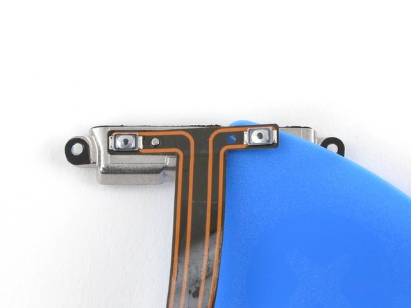

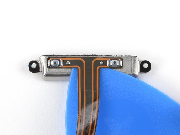

  116. Microsoft Surface Pro X Volume Button Cable Replacement: passo 116, immagine 1 di 3 Microsoft Surface Pro X Volume Button Cable Replacement: passo 116, immagine 2 di 3 Microsoft Surface Pro X Volume Button Cable Replacement: passo 116, immagine 3 di 3
    • Use an opening pick to cut through the adhesive between the two buttons under the volume button cable.
    • Slide the opening pick right to detach the right button from the bracket.
  117. Microsoft Surface Pro X Volume Button Cable Replacement: passo 117, immagine 1 di 2 Microsoft Surface Pro X Volume Button Cable Replacement: passo 117, immagine 2 di 2
    • Slide the opening pick left to cut through the adhesive under the left button and detach the cable from the bracket.
  118. Microsoft Surface Pro X Volume Button Cable Replacement: passo 118, immagine 1 di 1
    • Only the volume button cable remains.
    • If there's any alcohol solution remaining in the Surface or on the bracket, carefully wipe it off with a lint-free cloth or allow it to air dry before installing your volume button cable.
