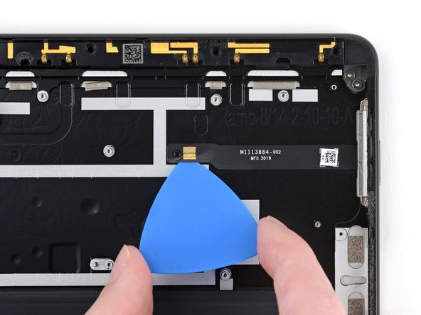

  107. Microsoft Surface Pro X Power Button Cable Replacement, Detach the power button cable: passo 107, immagine 1 di 2 Microsoft Surface Pro X Power Button Cable Replacement, Detach the power button cable: passo 107, immagine 2 di 2
    • The power button cable is lightly adhered to the frame.
    • Use an opening pick to cut through the adhesive on the left side of the bottom edge of the power button cable.

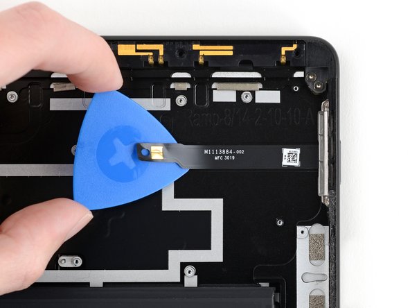

  108. Microsoft Surface Pro X Power Button Cable Replacement: passo 108, immagine 1 di 2 Microsoft Surface Pro X Power Button Cable Replacement: passo 108, immagine 2 di 2
    • Slide the opening pick under the left side of the power button cable to further detach it from the frame.

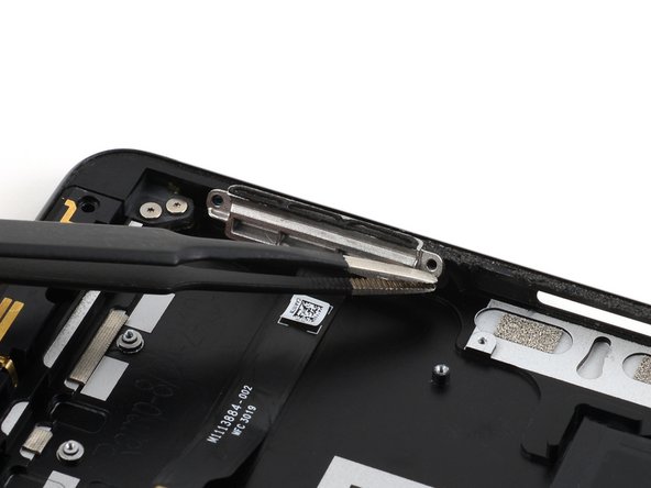

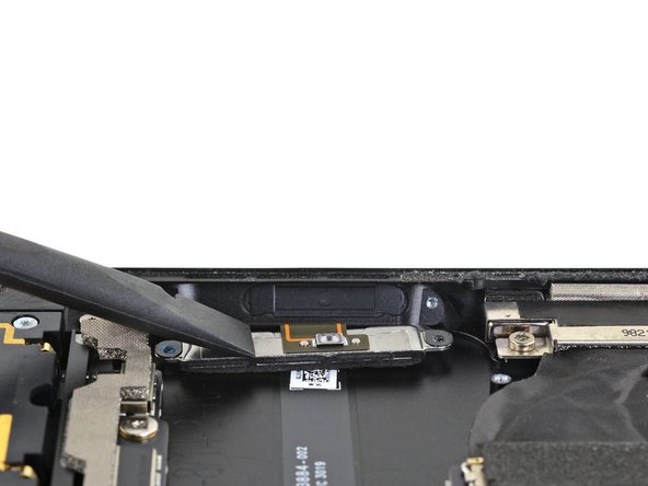

  112. Microsoft Surface Pro X Power Button Cable Replacement, Detach the power button bracket: passo 112, immagine 1 di 2 Microsoft Surface Pro X Power Button Cable Replacement, Detach the power button bracket: passo 112, immagine 2 di 2
    Attrezzo utilizzato in questo passaggio:
    • Use a pair of blunt tweezers to pull the left side of the power button bracket straight out of the frame.
  113. Microsoft Surface Pro X Power Button Cable Replacement: passo 113, immagine 1 di 2 Microsoft Surface Pro X Power Button Cable Replacement: passo 113, immagine 2 di 2
    • Repeat the previous step for the right side of the power button bracket.
