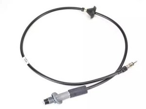

After looking at parts on the Mopar website, here's what you should be looking for. This is the antenna cable going from the back of the radio to the fender.

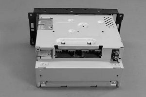

No idea how easy the back of the radio is to get to; on older model cars you could usually reach up from under the dash, but you might have to take some kind of panel off to get to it. Anyway, there appear to be two antenna plugs on the back of your radio; I don't know which one it goes into, but you mentioned satellite radio so I suspect one is for the over-the-air radio and the other is for satellite radio. Look for the two circular plugs on the right hand side, one above the other; that's where the antenna should be plugged into.
