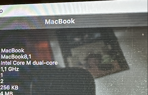

Update (12/28/23)
@danj , I've found this side effect in the monitor: there are "rows" in whole monitor... (see the attached image)
I've seen this defect only once on a Macbook Pro 2011 on the Radeon GPU... I've forced the use of the internal gpu and the defect disappear (so the gpu was faulty...)
can be that the gpu IRIS 5300 on this macbook have some problem and a side effect of this problem is the high frequency noise?

Well.. almost! The high pitched sound is coming from one of the inductors or power MOSFET’s within the logic board.
This is quite repairable! But it will take someone with good board level diagnosis and micro soldering skills to identify and replace the bad component.

@danj - Oh nice! I learn something new everyday. I had a MacBook Unibody A1278 that did the same thing, and the logic board was defective. I guess that’s slightly different on the newer models. Cool.
da
@jadonlyon - The unibodies use basically the same circuit! I’ve fixed many logic-boards with high frequency squeal issues. Some are easier to fix than others. The MacBooks are so tightly packed it does take a bit more work to get to the failing component.
da
