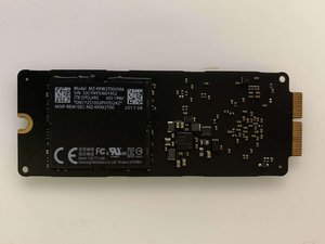

I am not aware of any adapters or enclosures for Apple's 2017 and later PCIe NVMe SSD blades. OWC makes some Envoy USB enclosures for 2013 to 2015 Apple SSD blades, but when I asked them (just two days ago in fact) if they had models for the more recent blades, the answer was "no".
da
@lazy_atom & @pppappas - OWC offers cases for the custom Apple blade SSD's OWC Envoy Pro
da
OWC does not make Envoy Pro enclosures that work with Apple's 2017 and later SSD blades. I just had this conversation with them last week.
da
I have put a Gen. 5 Apple 512GB SSPOLARIS SSD from a 2017 iMac (https://beetstech.com/product/solid-stat...) into the OWC Envoy Pro (https://eshop.macsales.com/item/OWC/MAU3...). This is only a USB 3.0 solution, so only 5Gbps, but at least you can read and write to your drive. I don't think the OWC Envoy can boot a Mac, but I could be wrong. So OWC are wrong that none of their enclosures work, but right that they are not designed for them and certainly don't run at anywhere near the speed the SSDs are capable of.

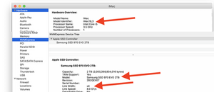

The first thing is Apple > About this Mac > More Information > Hardware > NVMEexpress.
English: If it doesn't appear enabled, it's because you haven't completed the Firmware Update that adds Apple's NVMe support. It comes with macOS High Sierra onwards: you'll need to install it from scratch on a clean partition of the original SSD (or external drive). Only after completing that Firmware Update will your Mac know how to recognize M.2 NVMe SSD
On the other hand, the adapter is almost never the cause: it's not a controller chip, it's just a pin rearranger from Apple's proprietary socket to the industry-standard M.2 socket.

I have just done this upgrade on 2x 2017 iMacs using exactly the same components you are proposing - all worked flawlessly.
da

In the system information, under hardware, I have the NVMexpress tab, which when selected says "this computer does not have any NVMexpress device. If you installed any NVMExpress devices, make sure they are properly connected and powered on. BTW, Im using OS BigSur.

Hi, just wanted to jump in here and say I have also replaced the Apple PCIe NVMe SSDs using the Syntech adapters on three 2015 MacBook Pro's, a 2015 iMac 27 5K and a 2017 iMac 27 5K. I have used the Crucial P3, Samsung 970 EVO Plus and WD Black SN750 SE SSDs. All have worked with no problems and I used then stock right out of the package. I did have a problem trying to use a Sabrent Rocket NVMe 4.0 in my 2017 iMac, it would not stay "connected" when trying to boot from it. I don't know if it is something specific to the Sabrent or the fact that it is a PCIe 4.0 drive. All the others that I have used are PCIe 3.0. I have not tried any other PCIe 4.0 SSDs and I am curious if anyone else has had success with these newer 4.0 SSDs with these older Macs. As a side note, the 2015 MacBook Pro 15 and 2017 iMac 5K are my personal machines and they also run Windows 10 in Bootcamp partitions.
da
