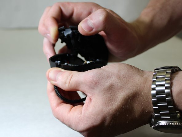

  3. Repairing Rattling Sensor in Logitech G303 Computer Mouse: passo 3, immagine 1 di 2 Repairing Rattling Sensor in Logitech G303 Computer Mouse: passo 3, immagine 2 di 2
    • Grip the mouse cable with one had and the top buttons with the other and apply force in opposite directions to separate the two halves of the mouse.
    • Try lightly squeezing the top buttons together while separating the two halves of the mouse.

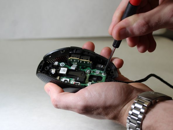

  4. Repairing Rattling Sensor in Logitech G303 Computer Mouse: passo 4, immagine 1 di 2 Repairing Rattling Sensor in Logitech G303 Computer Mouse: passo 4, immagine 2 di 2
    • Using the Phillips #00 screwdriver, unscrew the three internal screws.

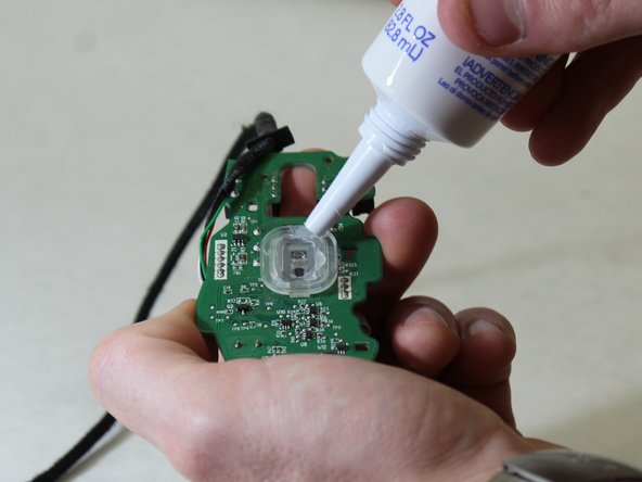

  6. Repairing Rattling Sensor in Logitech G303 Computer Mouse: passo 6, immagine 1 di 2 Repairing Rattling Sensor in Logitech G303 Computer Mouse: passo 6, immagine 2 di 2
    • First Adhesive Method:
    • Apply a thin bead of the Silicon caulk to the rim of the sensor component.
    • Ensure that no Silicon is covering the center where the sensor is located.
    • The Silicon takes 30 minutes to set. This allows slight adjustments to be made if the Silicon initially covers the sensor.
