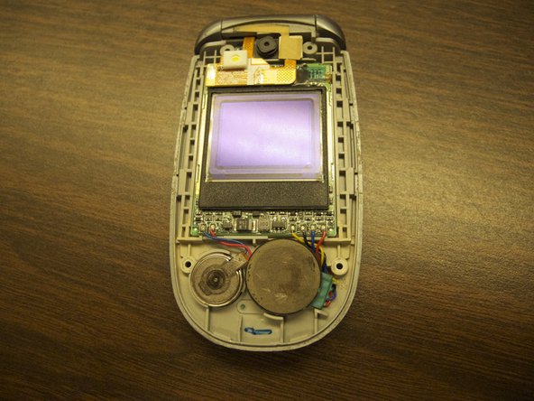

  1. LG VX5300 outer LCD screen replacement, Front LCD Screen: passo 1, immagine 1 di 1
    • Remove the rubber stoppers from the four corners of the front screen.
  2. LG VX5300 outer LCD screen replacement: passo 2, immagine 1 di 1
    • Using the Phillips screwdriver, carefully remove all four screws.
  3. LG VX5300 outer LCD screen replacement: passo 3, immagine 1 di 2 LG VX5300 outer LCD screen replacement: passo 3, immagine 2 di 2
    • To pry open the face plate, place the iFixit Opener tool in the crease of the phone.
  4. LG VX5300 outer LCD screen replacement, LCD Screen: passo 4, immagine 1 di 2 LG VX5300 outer LCD screen replacement, LCD Screen: passo 4, immagine 2 di 2
    • Carefully lift off the black frame around the LCD screen and set it aside.
  5. LG VX5300 outer LCD screen replacement: passo 5, immagine 1 di 1
    Attrezzo utilizzato in questo passaggio:
    • Lift the speaker out by using tweezers.
    • Next, lift the battery out using the tweezers.
  6. LG VX5300 outer LCD screen replacement: passo 6, immagine 1 di 1
    • Using tweezers, carefully disconnect the orange ribbon from the computer chip.
  7. LG VX5300 outer LCD screen replacement: passo 7, immagine 1 di 1
    • Remove the LCD screen and replace with a new one.
    • Finally, replace the battery and the speaker.
