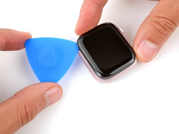

  2. Apple Watch Series 9 Screen Replacement, Disassembly information: passo 2, immagine 1 di 3 Apple Watch Series 9 Screen Replacement, Disassembly information: passo 2, immagine 2 di 3 Apple Watch Series 9 Screen Replacement, Disassembly information: passo 2, immagine 3 di 3
    • Throughout the rest of your repair:
    • Attach and remove the watch bands as needed to get a better grip or stabilize your watch.
    • To remove a band, firmly press in the small, oval button on the underside of the watch and slide the band out of its groove.
    • Consider placing your watch on something soft like a clean cloth to help stabilize it and prevent damage.

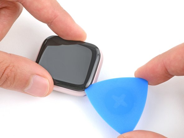

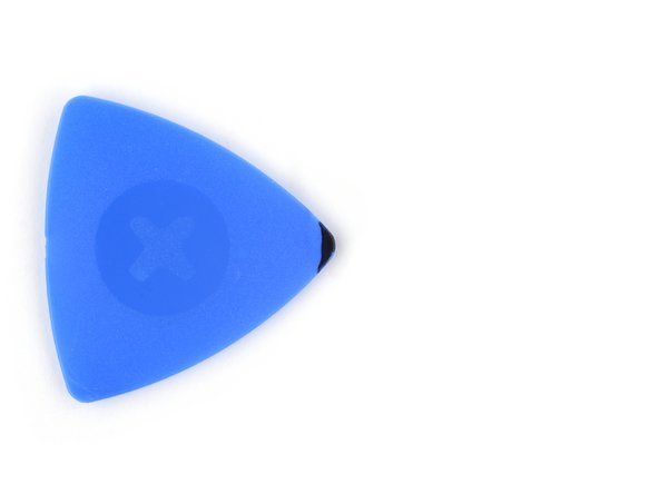

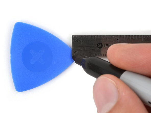

  3. Apple Watch Series 9 Screen Replacement, Mark your opening picks: passo 3, immagine 1 di 3 Apple Watch Series 9 Screen Replacement, Mark your opening picks: passo 3, immagine 2 di 3 Apple Watch Series 9 Screen Replacement, Mark your opening picks: passo 3, immagine 3 di 3
    • If inserted too far, an opening pick can damage your watch. Follow this step to mark your pick and prevent damage.
    • Measure 3 mm from the tip and mark the opening pick with a permanent marker.
    • Alternatively, tape a coin to a pick 3 mm from the tip.

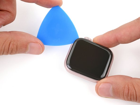

  4. Apple Watch Series 9 Screen Replacement, Heat the screen: passo 4, immagine 1 di 1
    • Strong adhesive secures the perimeter of the screen to the frame. Heating the screen softens the adhesive, making it easier to separate.
    • Heat an iOpener and lay it on the screen for two minutes to soften its adhesive.
    • Alternatively, you can use a hair dryer or heat gun—but be careful as extreme heat can damage the screen and/or battery.

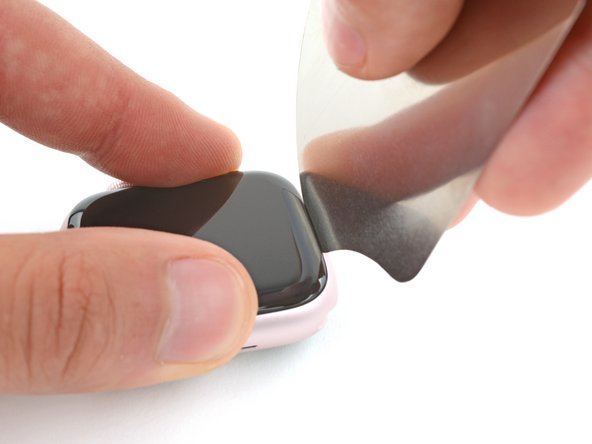

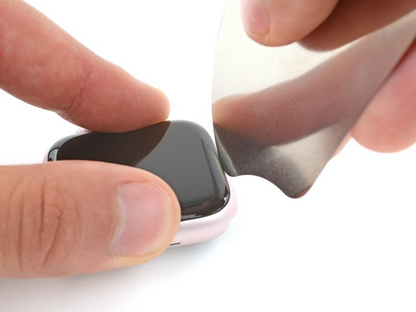

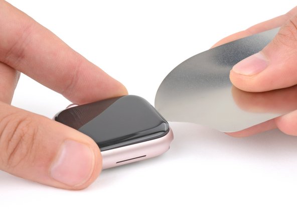

  5. Apple Watch Series 9 Screen Replacement, Insert an iFlex: passo 5, immagine 1 di 3 Apple Watch Series 9 Screen Replacement, Insert an iFlex: passo 5, immagine 2 di 3 Apple Watch Series 9 Screen Replacement, Insert an iFlex: passo 5, immagine 3 di 3
    Attrezzo utilizzato in questo passaggio:
    iFlex Opening Tool
    $11.99
    • The gap between the screen and frame is extremely small. You'll need a thin tool such as an iFlex to create an initial gap.
    • Don't grip the iFlex or similar metal tools by the edges—they're very sharp. Consider wearing gloves to protect your hands.
    • Insert the iFlex at a downward angle between the bottom edge of the screen and frame.
  6. Apple Watch Series 9 Screen Replacement, Pry up the screen: passo 6, immagine 1 di 2 Apple Watch Series 9 Screen Replacement, Pry up the screen: passo 6, immagine 2 di 2
    • Prying up the screen may take multiple attempts. If you're having trouble, apply more heat and try again.
    • With one hand, push down firmly on the watch's frame to secure it in place.
    • With your free hand, hold the iFlex and push the edges up to make it more rigid.
    • The iFlex should be slightly "U" shaped.
    • Pry up the screen enough for the iFlex to lay flat on its own.
    • The iFlex doesn't need to be inserted far, as it can easily damage the screen cables near the bottom right corner of the watch.
    • Leave the iFlex inserted under the screen.

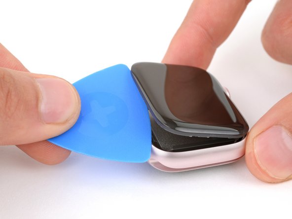

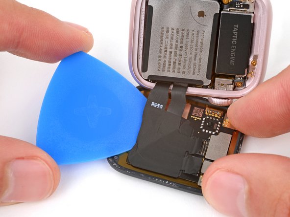

  7. Apple Watch Series 9 Screen Replacement, Insert an opening pick: passo 7, immagine 1 di 3 Apple Watch Series 9 Screen Replacement, Insert an opening pick: passo 7, immagine 2 di 3 Apple Watch Series 9 Screen Replacement, Insert an opening pick: passo 7, immagine 3 di 3
    • Do not insert your opening pick more than 3 mm under the screen when separating the adhesive, as you risk damaging your watches internals.
    • Keep the iFlex flat to maintain a gap between the screen and frame while inserting an opening pick.
    • Insert an opening pick between the screen and iFlex.
    • Remove the iFlex.

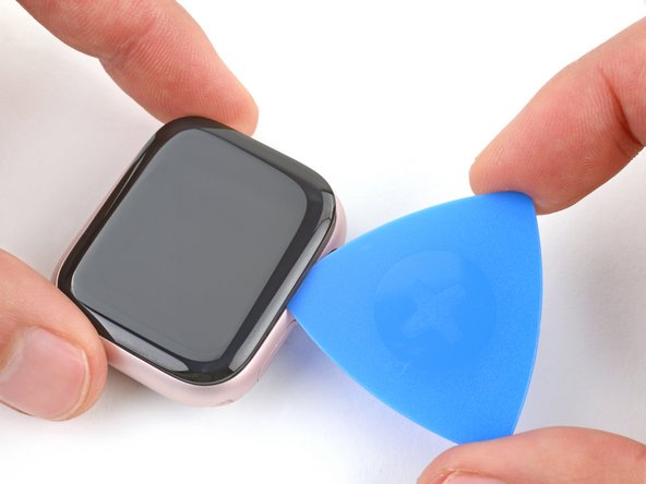

  8. Apple Watch Series 9 Screen Replacement, Separate the bottom edge adhesive: passo 8, immagine 1 di 2 Apple Watch Series 9 Screen Replacement, Separate the bottom edge adhesive: passo 8, immagine 2 di 2
    • Slide the opening pick along the bottom edge to separate the adhesive securing it.

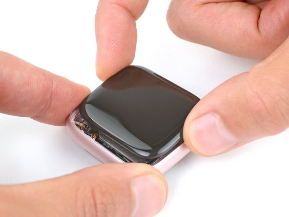

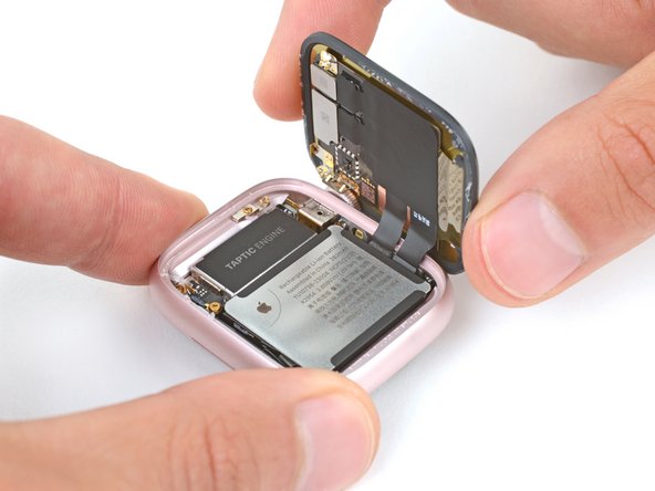

  13. Apple Watch Series 9 Screen Replacement, Swing open the screen: passo 13, immagine 1 di 3 Apple Watch Series 9 Screen Replacement, Swing open the screen: passo 13, immagine 2 di 3 Apple Watch Series 9 Screen Replacement, Swing open the screen: passo 13, immagine 3 di 3
    • Pull the right edge of the screen over the digital crown.
    • If the screen feels stuck, go back around it with an opening pick to separate any adhesive.
    • Swing up the left edge of the screen so it's upright. The screen should be to the right of the digital crown.
    • During reassembly:
    • This is a good point to plug in your watch and test all functions before sealing it up. Be sure to power it back down completely before you continue working.
    • Follow this guide to apply new screen adhesive and reseal your watch.

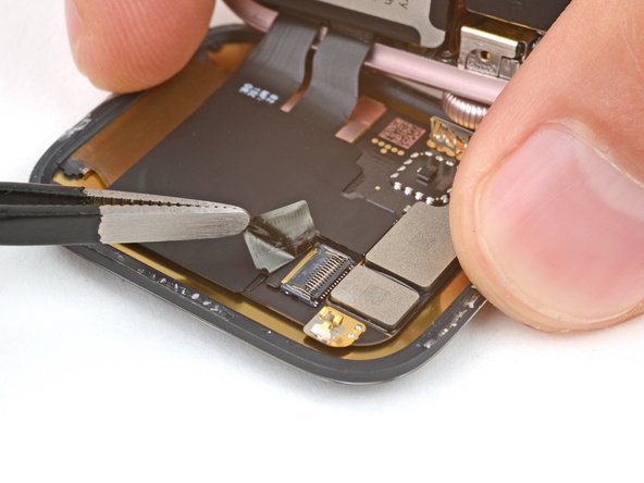

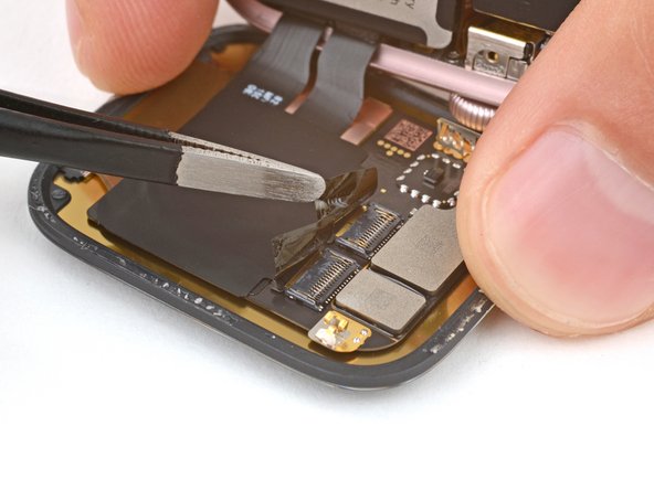

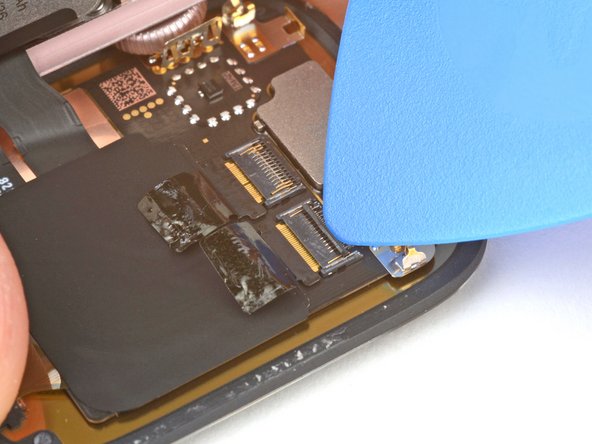

  15. Apple Watch Series 9 Screen Replacement, Peel up the screen cable tape: passo 15, immagine 1 di 3 Apple Watch Series 9 Screen Replacement, Peel up the screen cable tape: passo 15, immagine 2 di 3 Apple Watch Series 9 Screen Replacement, Peel up the screen cable tape: passo 15, immagine 3 di 3
    • Use tweezers to peel up the tape covering the two screen cable ZIF connectors.
  16. Apple Watch Series 9 Screen Replacement, Flip up the locking flaps: passo 16, immagine 1 di 3 Apple Watch Series 9 Screen Replacement, Flip up the locking flaps: passo 16, immagine 2 di 3 Apple Watch Series 9 Screen Replacement, Flip up the locking flaps: passo 16, immagine 3 di 3
    • Use the tip of an opening pick to pry up the small, hinged locking flaps on both screen cable ZIF connectors.

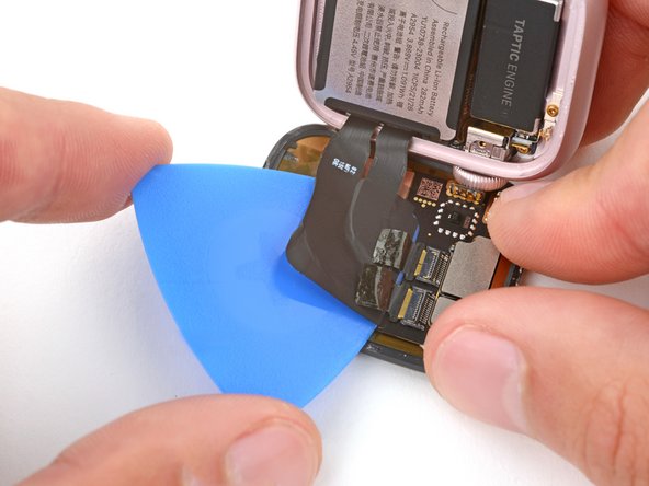

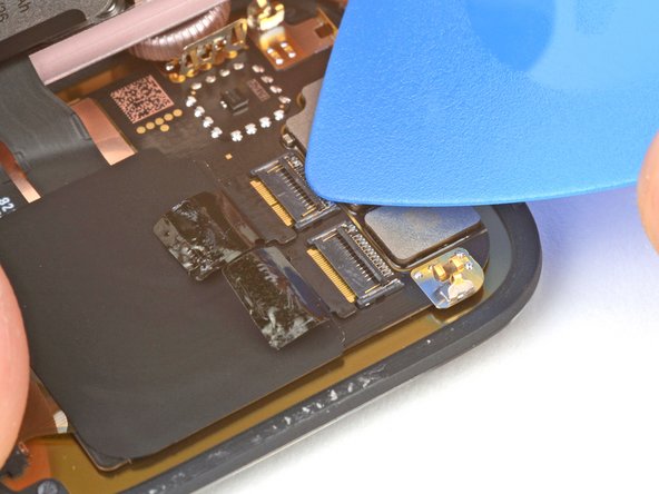

  18. Apple Watch Series 9 Screen Replacement, Separate the screen cable adhesive: passo 18, immagine 1 di 2 Apple Watch Series 9 Screen Replacement, Separate the screen cable adhesive: passo 18, immagine 2 di 2
    • Slide an opening pick under the lower screen cable to begin separating it from the screen.
    • If you're having trouble, apply more heat and try again. Don't use excessive force.
  19. Apple Watch Series 9 Screen Replacement: passo 19, immagine 1 di 3 Apple Watch Series 9 Screen Replacement: passo 19, immagine 2 di 3 Apple Watch Series 9 Screen Replacement: passo 19, immagine 3 di 3
    • Continue sliding the opening pick under the cables until they completely separate from the screen.
    • You can gently peel the cables up with your fingers when you're able to grab them.
