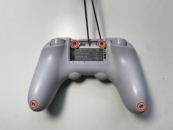

  3. 8BitDo SN30 Pro+ Controller Buttons Replacement, Remove Screws: passo 3, immagine 1 di 2 8BitDo SN30 Pro+ Controller Buttons Replacement, Remove Screws: passo 3, immagine 2 di 2
    Attrezzo utilizzato in questo passaggio:
    • Use Tweezers to uncover two screws under the label in the battery compartment.
    • Use a T6 screwdriver to remove the four 7.3 mm screws securing the rear cover.

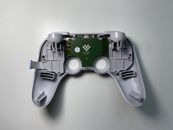

  5. 8BitDo SN30 Pro+ Controller Buttons Replacement, Separate Covers: passo 5, immagine 1 di 1
    • Carefully move the rear cover away and from the front cover. Place it to the left.
    • Do not completely separate. The two halves are still attached via a white ribbon cable.
    I just used this guide to open a Pro2 controller, the only difference was the ribbon cable was between the analog sticks. Otherwise it went perfectly.
    Dunch - Replica
    You have to be careful not to break the clip on the middle bottom (between the analog sticks)
    Kelvie Wong - Replica
