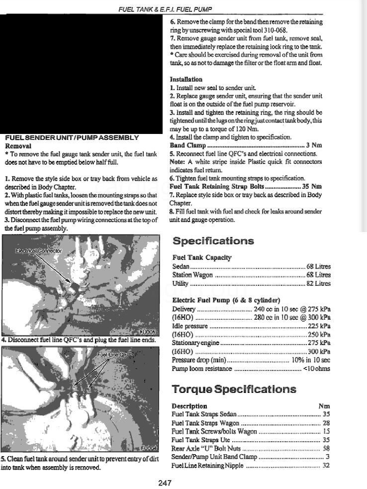

extract and replace fuel module in au ford ute

Hi @rebeccacook
Here's an image from the repair manual that shows what to do.
(click on image)
