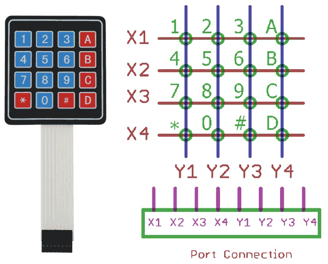

Physical keypads and keyboards work on a matrix principle; you have a series of wires going horizontally and a series going vertically, and pressing the button shorts them together, which the keyboard controller then uses to detect a keypress and knows which one it is. Here's a drawing showing what I mean.
Immagine
In your case the two vertical lines supporting the first two columns of buttons on your calculator have somehow gotten shorted together, so anything being pressed in the second column is being detected as being in the first column.
About all you can do is open up the calculator and look at the circuit board or flex that the buttons are connected to. Trace out the first two columns and see if you can find a spot that is either damaged or corroded and somehow bridging the circuit traces together.
