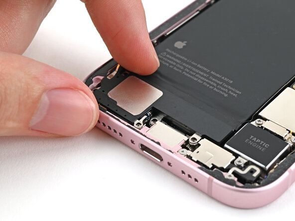

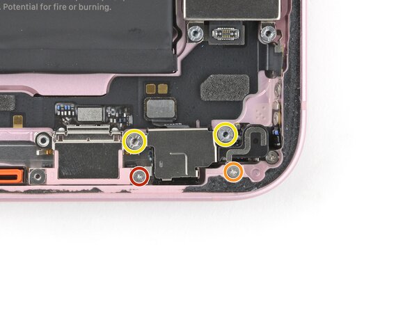

  32. iPhone 15 Microphone Replacement, Disconnect the microphone: passo 32, immagine 1 di 2 iPhone 15 Microphone Replacement, Disconnect the microphone: passo 32, immagine 2 di 2
    • Use the point of your spudger to pry up and disconnect the microphone press connector.
  33. iPhone 15 Microphone Replacement, Unfasten the microphone: passo 33, immagine 1 di 1
    Attrezzo utilizzato in questo passaggio:
    Standoff Screwdriver for iPhones
    $5.49
    • Use your tri-point Y000 driver to remove the 1.3 mm‑long screw securing the grounding clip and microphone.
    • Use your Phillips #000 driver to remove the 1.3 mm‑long screw securing the bottom right of the microphone.
    • Use a standoff driver to remove the two 3.0 mm‑long standoff screws securing top of the microphone.
    • If you don't have a standoff driver, you may use a thin flathead driver—but be careful not to strip the shallow notches in the screw heads.

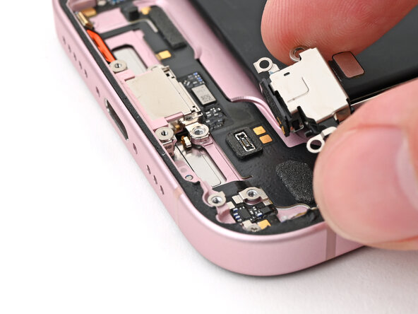

  35. iPhone 15 Microphone Replacement, Remove the microphone: passo 35, immagine 1 di 2 iPhone 15 Microphone Replacement, Remove the microphone: passo 35, immagine 2 di 2
    • Use your fingers or tweezers to peel up and remove the microphone.

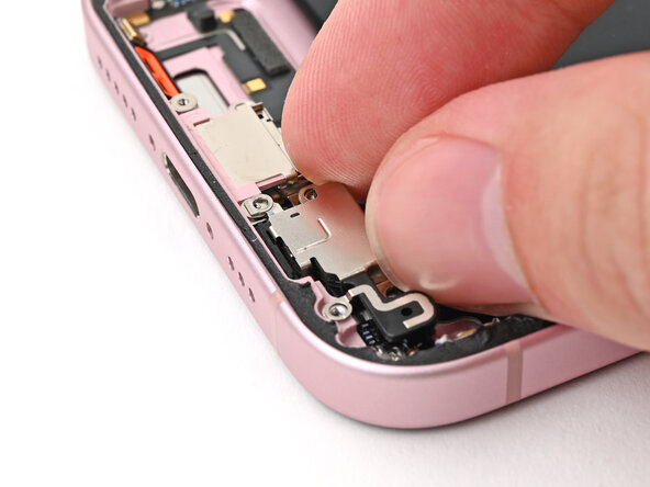

  36. iPhone 15 Microphone Replacement, End of disassembly: passo 36, immagine 1 di 1
    • Congratulations on completing disassembly! The remaining steps will show you how to reassemble your device.
    • When reconnecting press connectors, align the connector carefully over its socket and press down with your fingertip or spudger—first on one side, then the other—until it clicks into place. Don't try to force the connector into place. If you're having trouble, reposition it and try again.

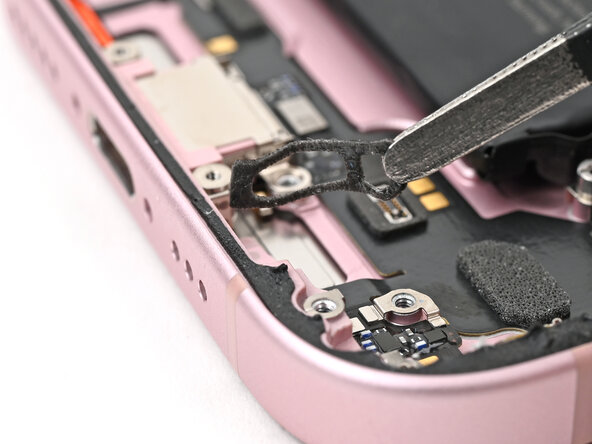

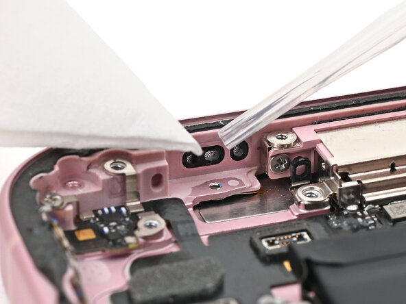

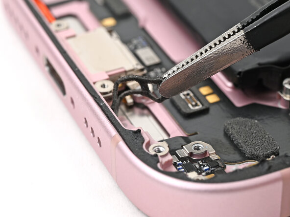

  37. iPhone 15 Microphone Replacement, Remove the old adhesive: passo 37, immagine 1 di 3 iPhone 15 Microphone Replacement, Remove the old adhesive: passo 37, immagine 2 di 3 iPhone 15 Microphone Replacement, Remove the old adhesive: passo 37, immagine 3 di 3
    • Use tweezers or your fingers to remove the old adhesive from the bottom of the frame.
    • If there's adhesive residue on the frame, use high concentration isopropyl alcohol (greater than 90%) and a coffee filter or lint-free cloth to clean it.

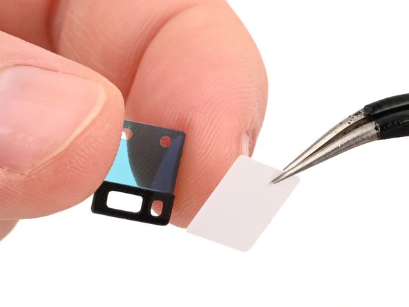

  38. iPhone 15 Microphone Replacement, Remove the white liner: passo 38, immagine 1 di 2 iPhone 15 Microphone Replacement, Remove the white liner: passo 38, immagine 2 di 2
    • If your microphone comes with adhesive installed, skip the next two steps.
    • While holding the microphone adhesive with one hand, use your fingers or a pair of tweezers to remove the white liner from the adhesive.

    • Use a Phillips #000 driver to install the 1.3 mm screw securing the bottom right of the microphone.
    • Use a standoff driver to install the two 3 mm standoff screws securing top of the microphone.
