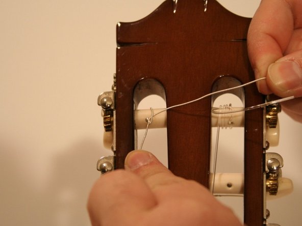

  4. Yamaha APX-6N Guitar Strings Replacement: passo 4, immagine 1 di 2 Yamaha APX-6N Guitar Strings Replacement: passo 4, immagine 2 di 2
    • Insert the end of the string into the hole on the correct tuning peg.
    • Pull the end over the tuning peg and loop under the string. Then push the end of the string under the loop.
    • Put the end of the string through the loop and pull both ends until the knot is tight.
  5. Yamaha APX-6N Guitar Strings Replacement: passo 5, immagine 1 di 2 Yamaha APX-6N Guitar Strings Replacement: passo 5, immagine 2 di 2
    • Repeat Step 4 for all other strings. Strings should be placed in the tuning pegs in clockwise order. Refer to string packaging for more details.
