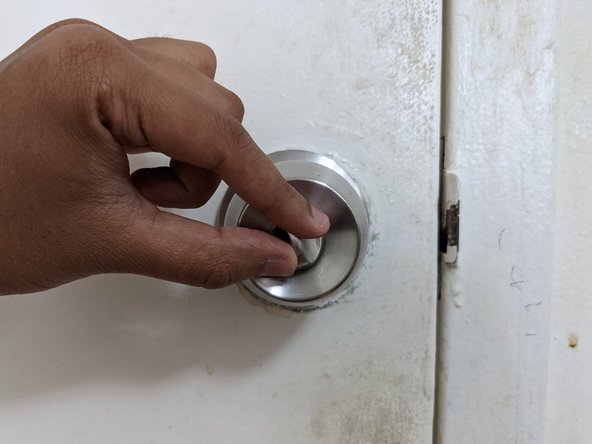

    • Hold both sides of the current doorknob with a hand to prevent it from falling out in the removal process.
  2. Replace a Passage Doorknob with a Privacy Doorknob: passo 2, immagine 1 di 2 Replace a Passage Doorknob with a Privacy Doorknob: passo 2, immagine 2 di 2
    • Using a Phillips #2 screwdriver, remove the two screws from the passage doorknob.
    • Make sure to rotate the screwdriver counter clockwise when removing screws.

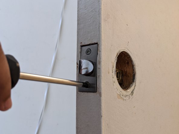

    • Remove the screws off the existing latch that comes with the passage doorknob.
    • These screws are located on the plate of the latch.
  5. Replace a Passage Doorknob with a Privacy Doorknob: passo 5, immagine 1 di 1
    • Pull the latch out of the hole it is secured in.

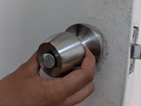

    • Grab the exterior knob and align it with the holes of the latch and push it in from the side of the door that is outside your room.
    • Make sure it is being secured with one hand to prevent it from falling.

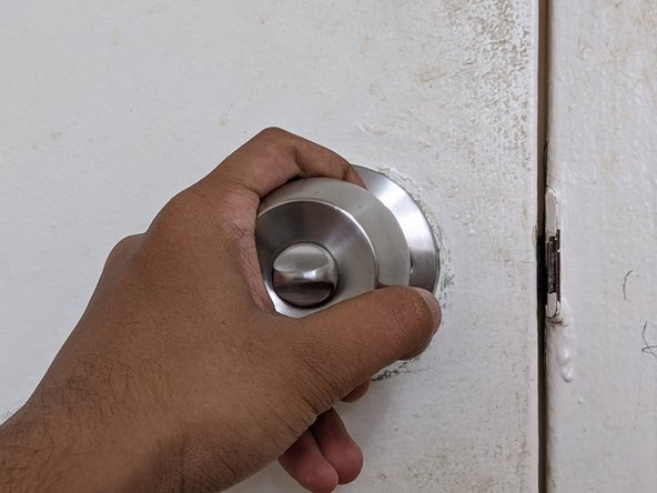

    • Test if the lock has been installed correctly.
    • After the lock clicks, try to rotate the knob.
    • If the knob does not rotate, then the installation of the privacy doorknob is successful.
