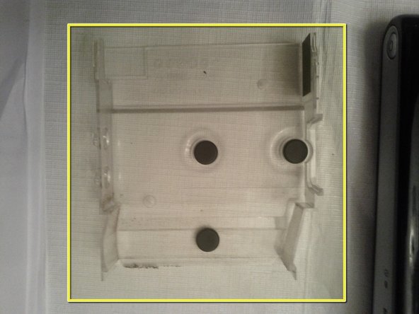

    • Next we'll be removing this panel.
    • Put your finger under the plastic panel and left up with your finger. The panel should put up a bit, then do the same thing on the other side.
    • Panel once removed.

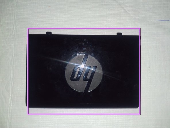

  7. Removing back panel and components to to get to CPU: passo 7, immagine 1 di 2 Removing back panel and components to to get to CPU: passo 7, immagine 2 di 2
    • Now remove the last panel, just like you did with the last one. It should pop up with your figner and be removed.
    • Put one of your fingers under the plastic and pull up.
    • What the panel looks like once removed.

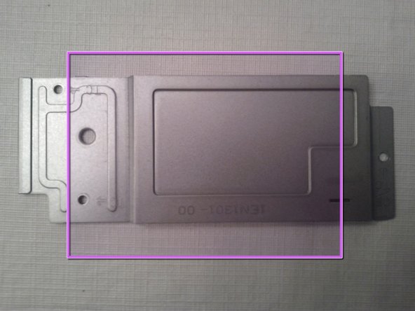

    • Now remove the three TC screws to remove the heatsink cover.
    • Note: I took the picture after I removed the three screws. Also side note, the TC screws are the same size at the CB screws removed later.
    • What heatsink cover looks like removed.
    • The back of the HP Touchsmart 300 after the heatsink cover was removed.

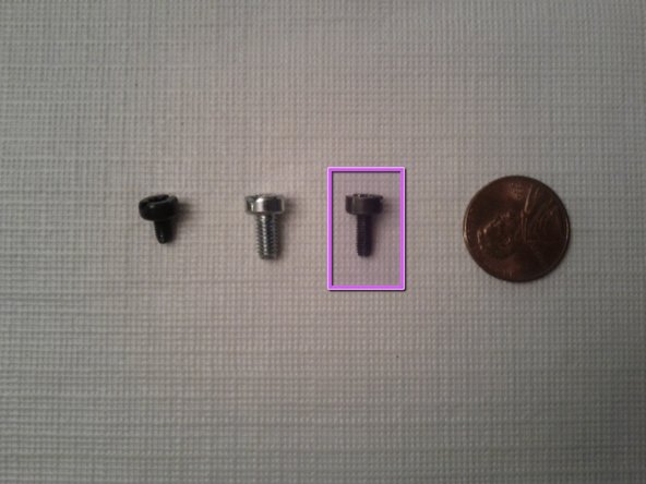

  14. Removing back panel and components to to get to CPU: passo 14, immagine 1 di 1
    • Types of screws that have been removed. This is to help when putting back together everything.
    • TC and CB screws. For the heatsink cover and fans cover metal panels. 11 total
    • HB screws. For the kickstand. 4 total
    • Screws for the side panels. 2 total
    • The penny is to help with scale.
