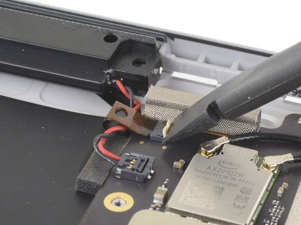

  31. Microsoft Surface Pro 7 Volume and Power Button Cover Replacement, Remove the left speaker: passo 31, immagine 1 di 3 Microsoft Surface Pro 7 Volume and Power Button Cover Replacement, Remove the left speaker: passo 31, immagine 2 di 3 Microsoft Surface Pro 7 Volume and Power Button Cover Replacement, Remove the left speaker: passo 31, immagine 3 di 3
    Attrezzo utilizzato in questo passaggio:
    • Use the flat end of a spudger to flip up the white plastic locking flap of the ZIF connector at the top-left corner of the motherboard.
    • Be sure to pry up on the hinged flap, not the connector itself.
    • Use your fingers or a pair of tweezers to pull the cable out.

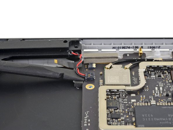

  32. Microsoft Surface Pro 7 Volume and Power Button Cover Replacement: passo 32, immagine 1 di 3 Microsoft Surface Pro 7 Volume and Power Button Cover Replacement: passo 32, immagine 2 di 3 Microsoft Surface Pro 7 Volume and Power Button Cover Replacement: passo 32, immagine 3 di 3
    • Gently slide the flat end of a spudger between the speaker wires and the motherboard until it is resting against the connector.
    • Carefully pry straight up on the connector to disconnect it from the motherboard.
    • Be gentle—the speaker wires are delicate.
    • During reassembly, place the new speaker wire harness on top of the connector on the motherboard and gently press it straight down with your finger to reconnect it.

    • Grab the speaker by the end of the top edge and lift it slightly.
    • Pull the speaker out from the case horizontally to remove it.

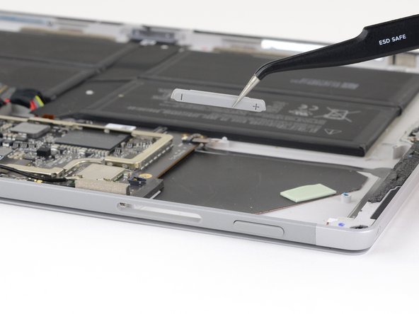

    • Push the volume and power buttons into the inside of the case and remove them.
