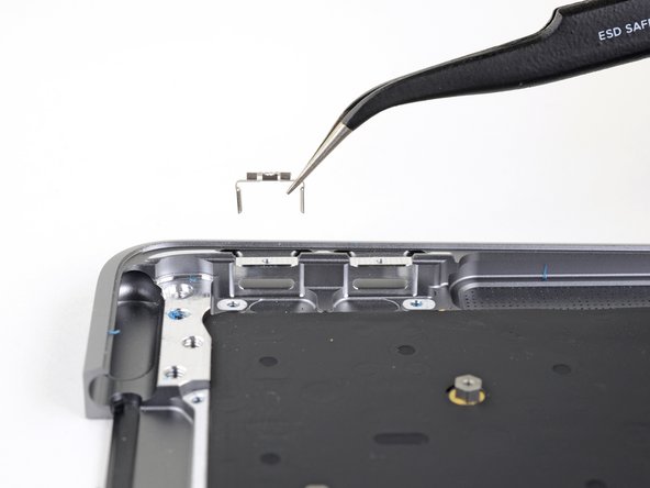

  34. MacBook Air 13" Retina Display 2019 Upper Case Replacement, Remove the Touch ID sensor: passo 34, immagine 1 di 2 MacBook Air 13" Retina Display 2019 Upper Case Replacement, Remove the Touch ID sensor: passo 34, immagine 2 di 2
    • Use a T3 Torx driver to remove the six 1.6 mm screws securing the Touch ID sensor and its bracket.
    • Remove the Touch ID bracket.
  35. MacBook Air 13" Retina Display 2019 Upper Case Replacement: passo 35, immagine 1 di 1
    • Turn the MacBook right-side up and open the display.
    • Lift the Touch ID sensor sensor out of its recess and remove it.

  62. MacBook Air 13" Retina Display 2019 Upper Case Replacement, Remove the USB-C port brackets: passo 62, immagine 1 di 1
    • Use a P2 pentalobe driver to remove the two 1.1 mm screws securing the USB-C port brackets.
  63. MacBook Air 13" Retina Display 2019 Upper Case Replacement: passo 63, immagine 1 di 2 MacBook Air 13" Retina Display 2019 Upper Case Replacement: passo 63, immagine 2 di 2
    • Lift the USB-C port brackets out of their recesses in the upper case and remove them.
    • Compare your new upper case to your old one and transfer over any remaining parts.
