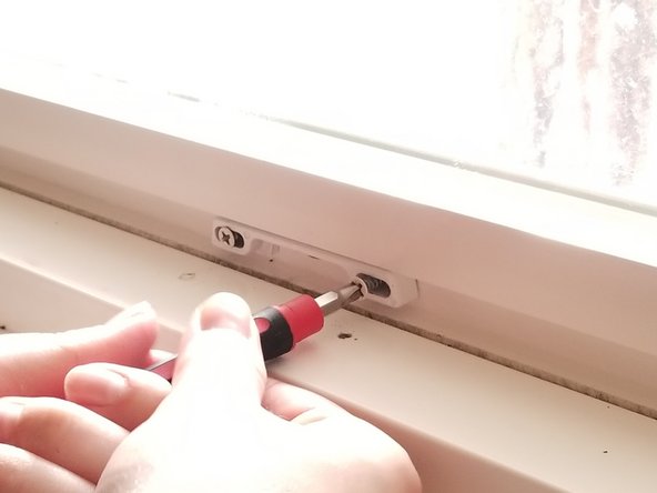

    • Measure the length between the two screws on the lock.
    • Measure the width of the lock from the screw to the keeper.
    • These measurements help determine the size of lock you will need.

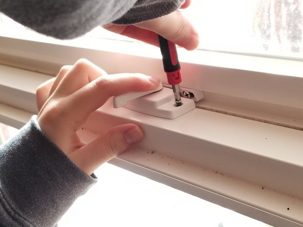

    • Move the lock into a neutral position.
    • Remove the 12.7 mm screw on the left side of the lock with a Phillips #2 screwdriver.

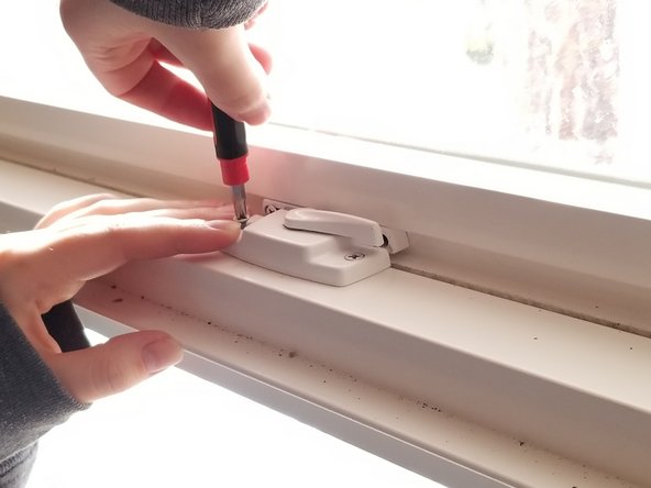

    • Remove the 12.7 mm Phillips #2 screw on the right side of the lock.
    • Remove the lock.

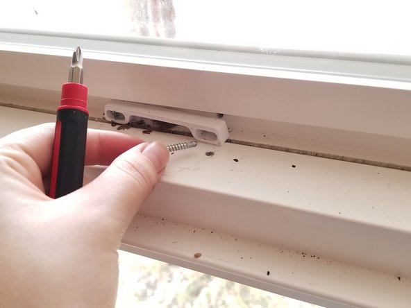

    • Remove the left 12.7 mm screw on the lock keeper with a Phillips #2 screwdriver.

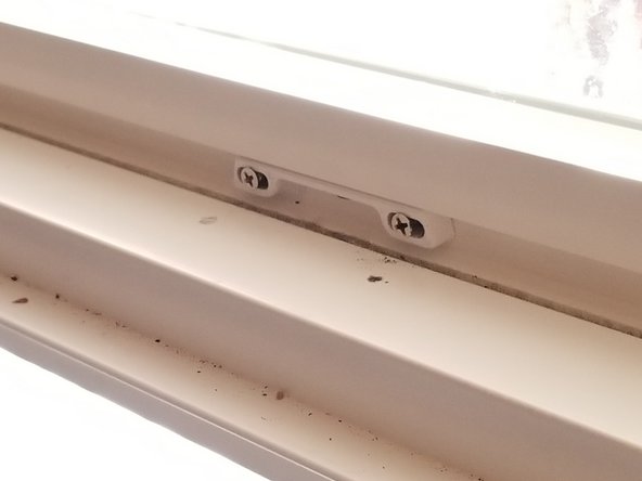

    • Remove the right 12.7 mm Phillips #2 screw on the lock keeper.
    • The lock keeper will fall off of the window once the last screw is removed. Be ready to catch it!

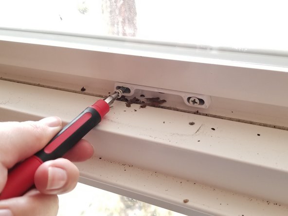

    • Line up the new lock keeper with the existing holes in the window.
    • Hold the keeper in place while inserting and tightening both the left and right 12.7 mm Phillips screws with a Phillips #2 screwdriver.
