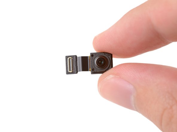

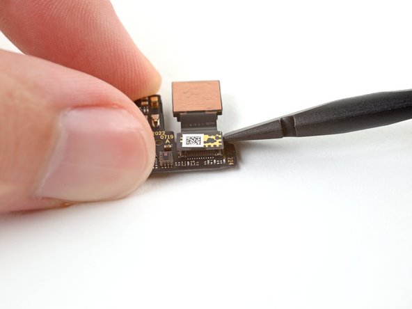

  32. Google Pixel Fold Flip Front Camera Replacement, Remove the front camera: passo 32, immagine 1 di 3 Google Pixel Fold Flip Front Camera Replacement, Remove the front camera: passo 32, immagine 2 di 3 Google Pixel Fold Flip Front Camera Replacement, Remove the front camera: passo 32, immagine 3 di 3
    • Support the upper board with one hand.
    • Use your other hand to pry up and disconnect the front camera press connector with the flat end of the spudger.
    • Remove the front camera.
