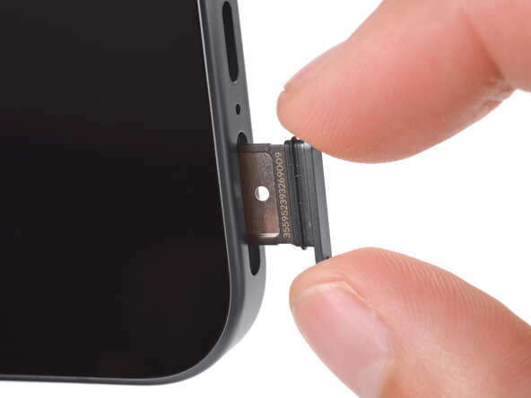

  2. Google Pixel 9a Logic Board Replacement, Remove the SIM card tray: passo 2, immagine 1 di 3 Google Pixel 9a Logic Board Replacement, Remove the SIM card tray: passo 2, immagine 2 di 3 Google Pixel 9a Logic Board Replacement, Remove the SIM card tray: passo 2, immagine 3 di 3
    • Firmly press a SIM eject tool, bit, or straightened paper clip into the SIM card tray hole on the bottom edge of your phone until the tray ejects.
    • A small mic hole is next to the SIM tray—don't confuse the two!
    • Remove the SIM card tray.

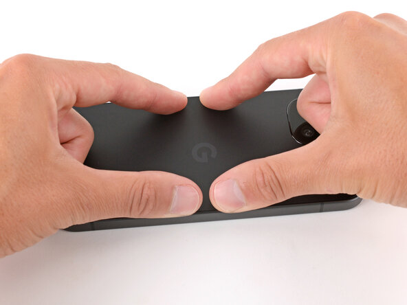

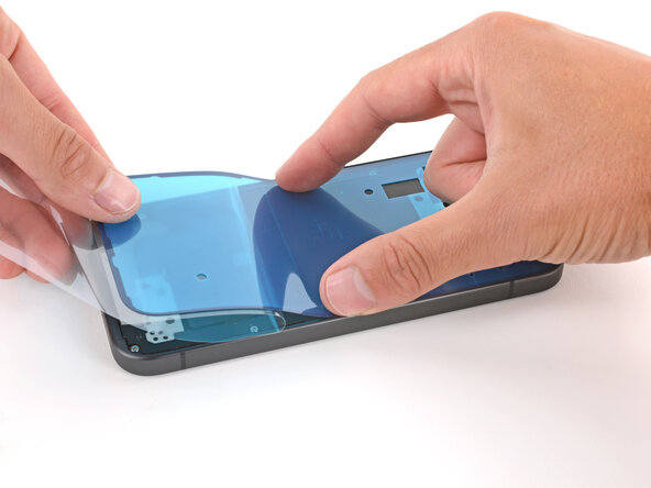

  3. Google Pixel 9a Logic Board Replacement, Heat the rear cover: passo 3, immagine 1 di 3 Google Pixel 9a Logic Board Replacement, Heat the rear cover: passo 3, immagine 2 di 3 Google Pixel 9a Logic Board Replacement, Heat the rear cover: passo 3, immagine 3 di 3
    • Adhesive secures the rear cover to the frame. Heating the cover softens the adhesive, making it easier to separate.
    • Use a hair dryer to heat the entire rear cover.
    • Only heat your phone so it's just hot to the touch. Extreme heat can damage the rear cover, screen, or battery.

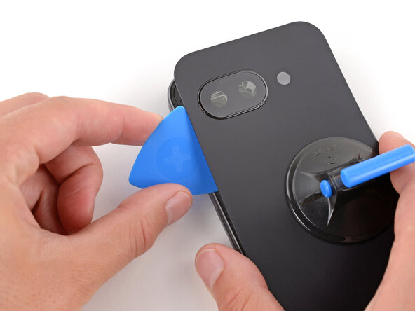

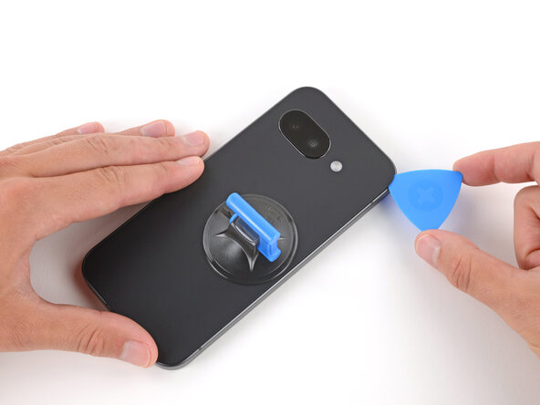

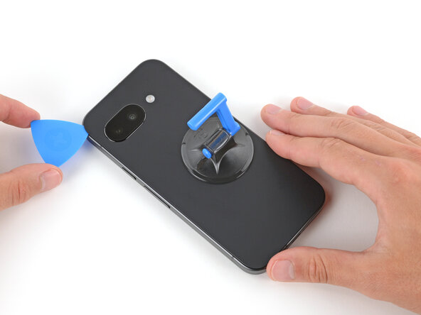

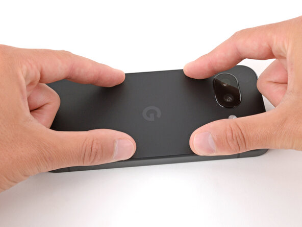

  4. Google Pixel 9a Logic Board Replacement, Apply a suction handle: passo 4, immagine 1 di 2 Google Pixel 9a Logic Board Replacement, Apply a suction handle: passo 4, immagine 2 di 2
    • Apply a suction handle near the center of the rear cover's right edge, as close to the edge as possible.
  5. Google Pixel 9a Logic Board Replacement, Insert an opening pick: passo 5, immagine 1 di 3 Google Pixel 9a Logic Board Replacement, Insert an opening pick: passo 5, immagine 2 di 3 Google Pixel 9a Logic Board Replacement, Insert an opening pick: passo 5, immagine 3 di 3
    • Pull up on the suction handle with strong, steady force until a gap forms between the cover and frame.
    • Insert the tip of an opening pick into the gap.

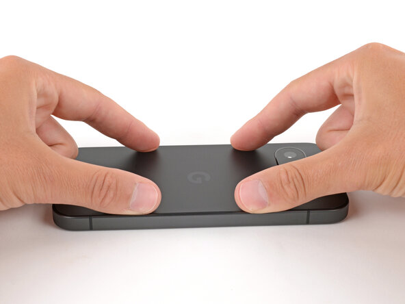

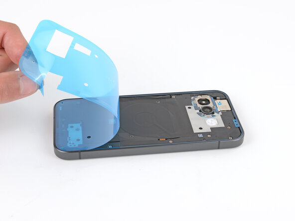

  6. Google Pixel 9a Logic Board Replacement, Adhesive information: passo 6, immagine 1 di 3 Google Pixel 9a Logic Board Replacement, Adhesive information: passo 6, immagine 2 di 3 Google Pixel 9a Logic Board Replacement, Adhesive information: passo 6, immagine 3 di 3
    • The rear cover is secured with adhesive around the perimeter of the frame and near the cameras. Use this picture as a reference while you separate the adhesive.
    • When separating the left and right edge adhesive, don't insert your pick more than 3 mm to avoid damaging the wireless charging coil and its graphite film.
  7. Google Pixel 9a Logic Board Replacement, Separate the rear cover adhesive: passo 7, immagine 1 di 3 Google Pixel 9a Logic Board Replacement, Separate the rear cover adhesive: passo 7, immagine 2 di 3 Google Pixel 9a Logic Board Replacement, Separate the rear cover adhesive: passo 7, immagine 3 di 3
    • If you ever have trouble separating the adhesive, apply more heat and try again.
    • Slide the opening pick up the right edge, around the top right corner, and along the top edge to separate the adhesive securing the rear cover.
  8. Google Pixel 9a Logic Board Replacement: passo 8, immagine 1 di 3 Google Pixel 9a Logic Board Replacement: passo 8, immagine 2 di 3 Google Pixel 9a Logic Board Replacement: passo 8, immagine 3 di 3
    • Insert an opening pick in the initial gap you created near the center of the rear cover's right edge.
    • Slide the opening pick down the right edge, along the bottom edge, and up the left edge to separate the adhesive securing the cover.

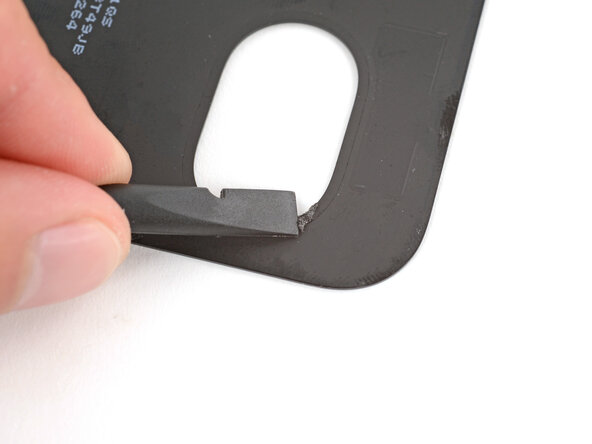

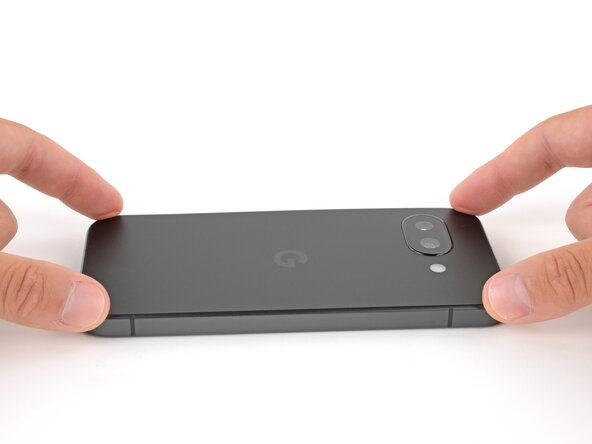

  9. Google Pixel 9a Logic Board Replacement, Separate the camera bezel adhesive: passo 9, immagine 1 di 3 Google Pixel 9a Logic Board Replacement, Separate the camera bezel adhesive: passo 9, immagine 2 di 3 Google Pixel 9a Logic Board Replacement, Separate the camera bezel adhesive: passo 9, immagine 3 di 3
    • Insert the flat edge of an opening pick under the top of the rear cover's left edge, near the camera bezel.
    • Twist the pick and apply constant pressure to separate the adhesive around the camera bezel.

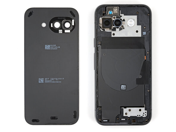

  10. Google Pixel 9a Logic Board Replacement, Remove the rear cover: passo 10, immagine 1 di 2 Google Pixel 9a Logic Board Replacement, Remove the rear cover: passo 10, immagine 2 di 2
    • Remove the rear cover.

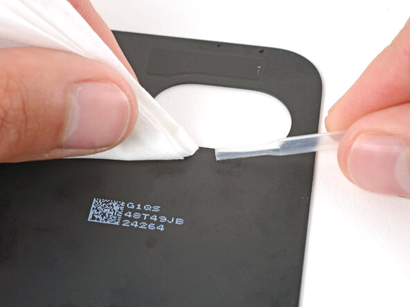

    • If you feel resistance, go back around the perimeter of the cover and use a pick to separate any remaining adhesive.

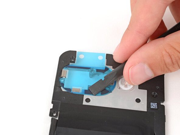

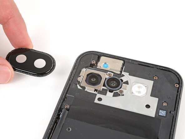

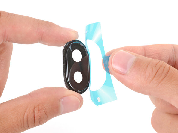

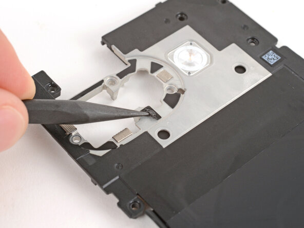

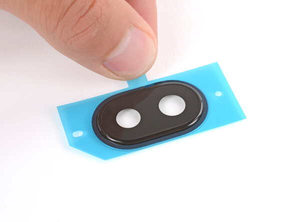

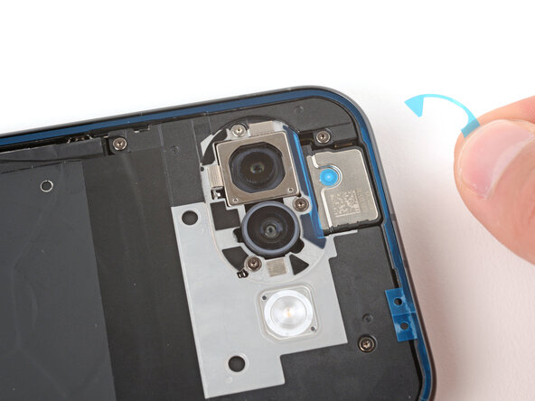

  11. Google Pixel 9a Logic Board Replacement, Remove the camera bezel: passo 11, immagine 1 di 3 Google Pixel 9a Logic Board Replacement, Remove the camera bezel: passo 11, immagine 2 di 3 Google Pixel 9a Logic Board Replacement, Remove the camera bezel: passo 11, immagine 3 di 3
    • If the camera bezel detached from the rear cover and stayed stuck to your phone, follow this step to remove it. Otherwise, skip this step.
    • Slide an opening pick under the camera bezel and pry up to remove it.
    • Only insert the pick a few millimeters under the bezel, or you risk damaging the cameras.
    • If you're having trouble, lightly heat the camera bezel.

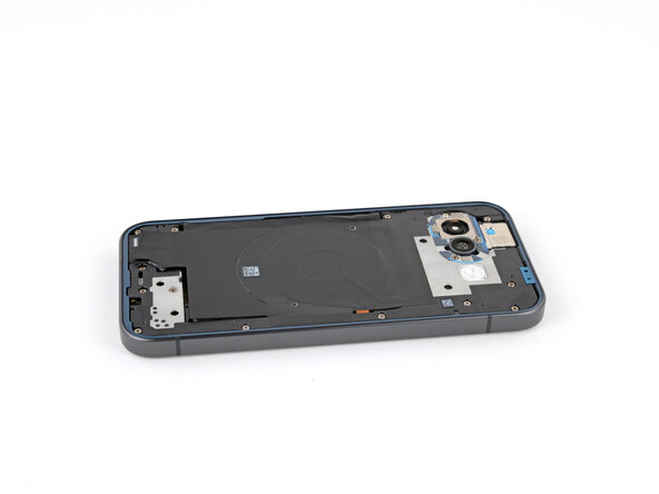

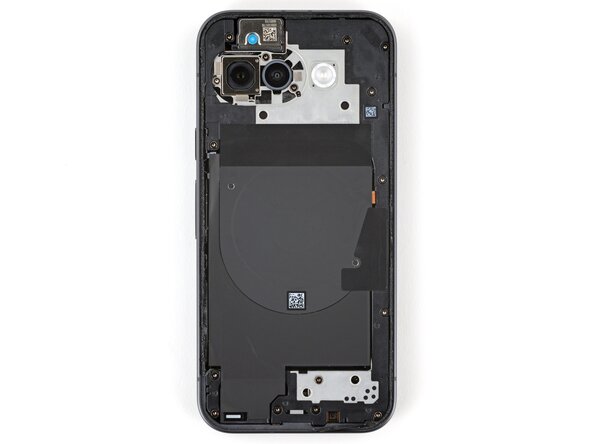

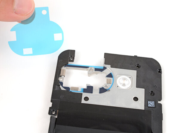

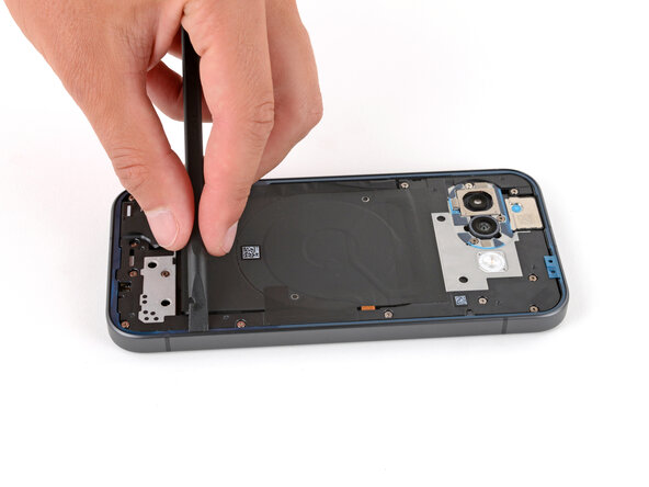

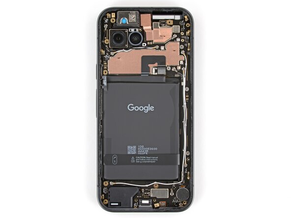

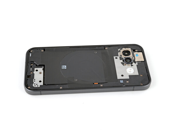

  12. Google Pixel 9a Logic Board Replacement, Remove the wireless charging assembly screws: passo 12, immagine 1 di 2 Google Pixel 9a Logic Board Replacement, Remove the wireless charging assembly screws: passo 12, immagine 2 di 2
    Attrezzo utilizzato in questo passaggio:
    Magnetic Project Mat
    $16.96
    • Use a Torx Plus 3IP screwdriver to remove the 16 screws securing the wireless charging assembly:
    • Thirteen 5.0 mm‑long screws
    • Three 2.2 mm‑long screws
    • Throughout this repair, keep track of each screw and make sure it goes back exactly where it came from to avoid damaging your phone.

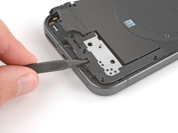

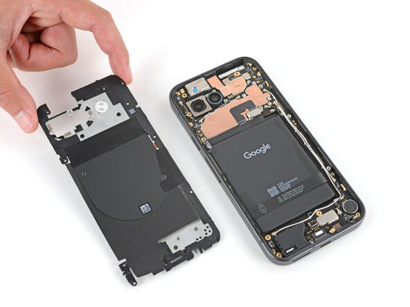

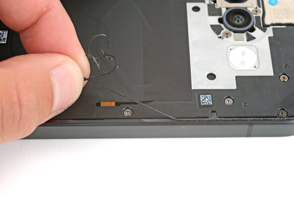

  13. Google Pixel 9a Logic Board Replacement, Unclip the wireless charging assembly: passo 13, immagine 1 di 3 Google Pixel 9a Logic Board Replacement, Unclip the wireless charging assembly: passo 13, immagine 2 di 3 Google Pixel 9a Logic Board Replacement, Unclip the wireless charging assembly: passo 13, immagine 3 di 3
  14. Google Pixel 9a Logic Board Replacement, Remove the wireless charging assembly: passo 14, immagine 1 di 2 Google Pixel 9a Logic Board Replacement, Remove the wireless charging assembly: passo 14, immagine 2 di 2
    • Remove the wireless charging assembly.

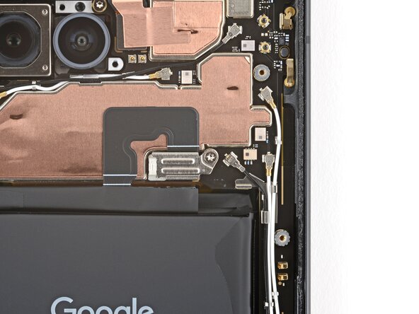

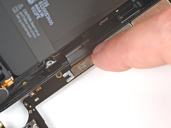

  15. Google Pixel 9a Logic Board Replacement, Remove the connector cover screw: passo 15, immagine 1 di 2 Google Pixel 9a Logic Board Replacement, Remove the connector cover screw: passo 15, immagine 2 di 2
    • Be careful not to damage the battery with your tools while disconnecting it.
    • Use a Torx Plus 3IP screwdriver to remove the 1.7 mm‑long screw securing the battery connector cover.

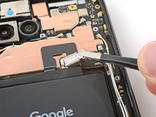

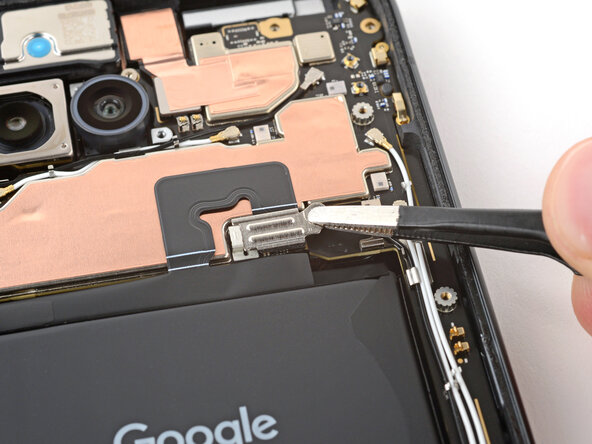

  16. Google Pixel 9a Logic Board Replacement, Remove the battery connector cover: passo 16, immagine 1 di 3 Google Pixel 9a Logic Board Replacement, Remove the battery connector cover: passo 16, immagine 2 di 3 Google Pixel 9a Logic Board Replacement, Remove the battery connector cover: passo 16, immagine 3 di 3
    • Use tweezers to lift and remove the battery connector cover.
  17. Google Pixel 9a Logic Board Replacement, Disconnect the battery: passo 17, immagine 1 di 2 Google Pixel 9a Logic Board Replacement, Disconnect the battery: passo 17, immagine 2 di 2
    • Use a spudger to pry up and disconnect the battery cable press connector.

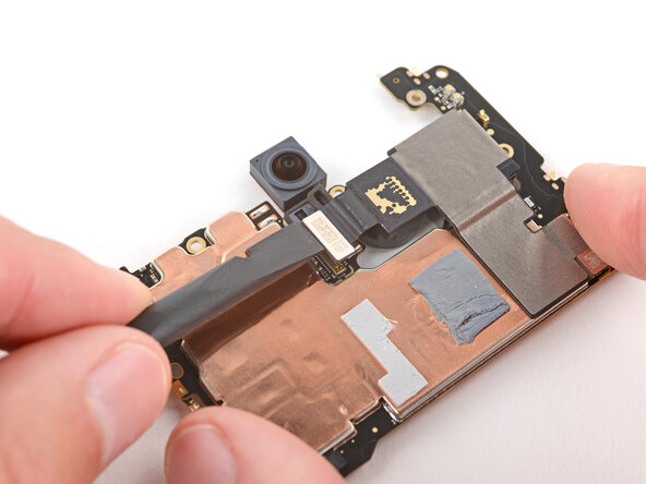

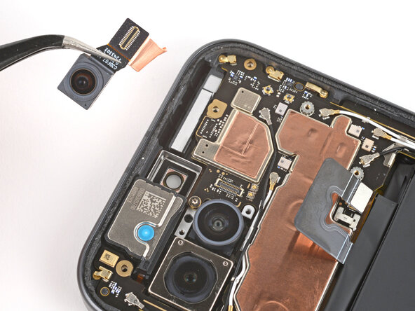

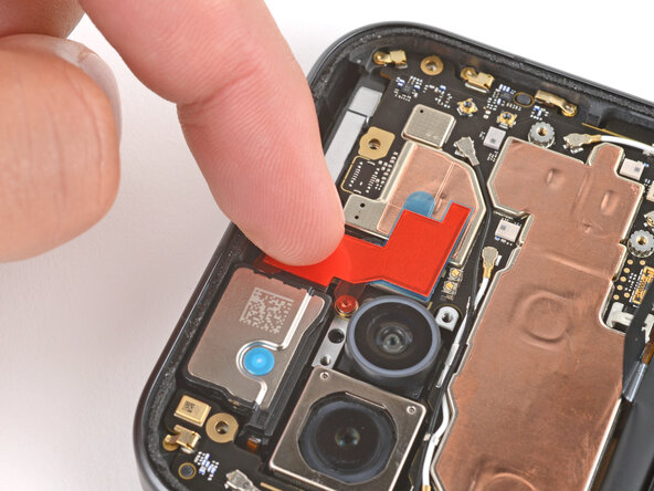

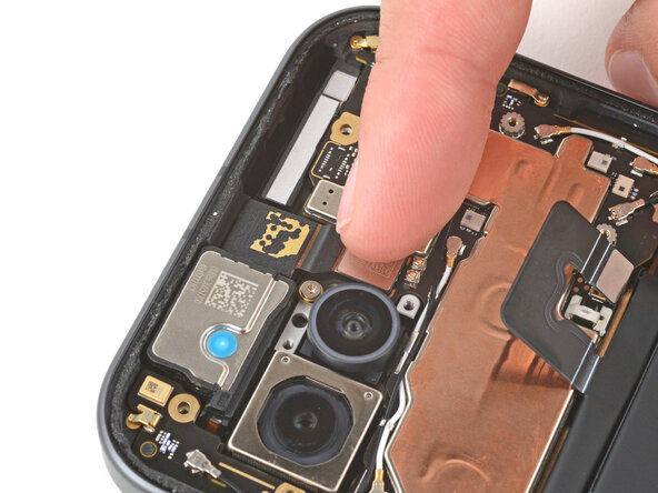

  18. Google Pixel 9a Logic Board Replacement, Disconnect the front camera: passo 18, immagine 1 di 2 Google Pixel 9a Logic Board Replacement, Disconnect the front camera: passo 18, immagine 2 di 2
    • Be very careful not to touch the camera lenses when removing the front camera. If you accidentally do, use a clean cloth to wipe them off.
    • Use the point of a spudger to pry up and disconnect the front camera press connector, prying under the top left corner.

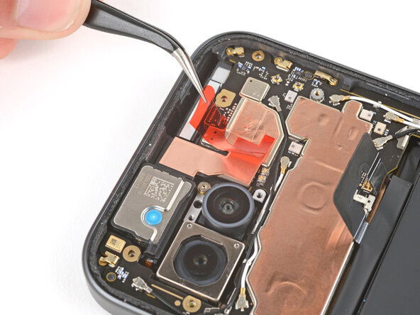

  19. Google Pixel 9a Logic Board Replacement, Remove the front camera: passo 19, immagine 1 di 3 Google Pixel 9a Logic Board Replacement, Remove the front camera: passo 19, immagine 2 di 3 Google Pixel 9a Logic Board Replacement, Remove the front camera: passo 19, immagine 3 di 3
    • Use tweezers to grip the center of the front camera, between the press connector and the camera itself.
    • Flip the camera towards the right edge and gently peel it off the copper foil.

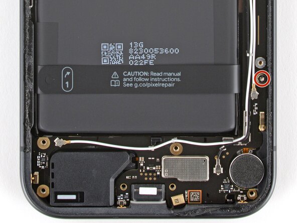

  20. Google Pixel 9a Logic Board Replacement, Remove the logic board screws: passo 20, immagine 1 di 3 Google Pixel 9a Logic Board Replacement, Remove the logic board screws: passo 20, immagine 2 di 3 Google Pixel 9a Logic Board Replacement, Remove the logic board screws: passo 20, immagine 3 di 3
    • Use a 3IP Torx Plus screwdriver to remove the two 2.8 mm‑long screws securing the logic board.

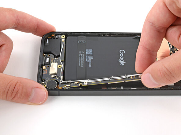

  21. Google Pixel 9a Logic Board Replacement, Lift the logic board: passo 21, immagine 1 di 3 Google Pixel 9a Logic Board Replacement, Lift the logic board: passo 21, immagine 2 di 3 Google Pixel 9a Logic Board Replacement, Lift the logic board: passo 21, immagine 3 di 3
    • Be careful not to smudge the cameras when handling the logic board.
    • Before trying to remove the logic board, double‑check that you removed the SIM card tray.
    • Insert the point of a spudger under the screw hole near the cameras and lift the board until you can grip it with your fingers.

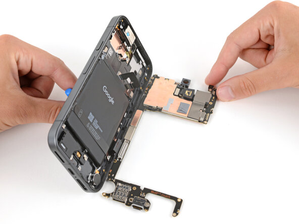

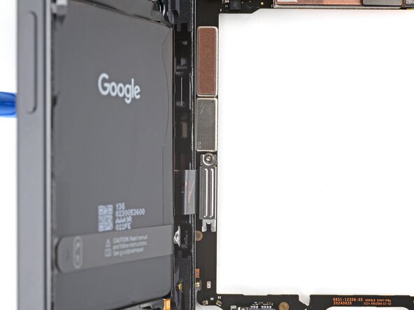

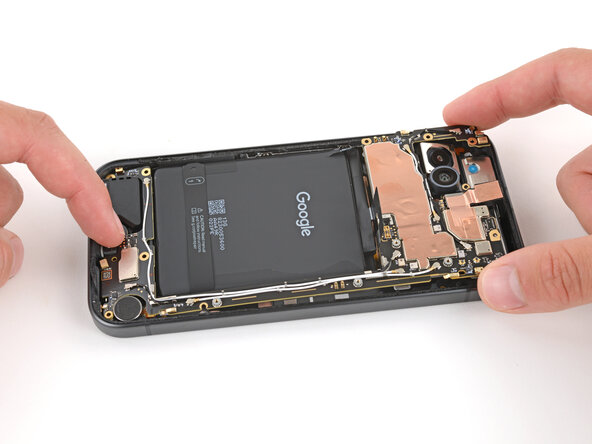

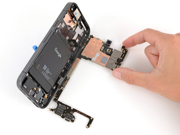

  22. Google Pixel 9a Logic Board Replacement, Free the bottom edge of the logic board: passo 22, immagine 1 di 3 Google Pixel 9a Logic Board Replacement, Free the bottom edge of the logic board: passo 22, immagine 2 di 3 Google Pixel 9a Logic Board Replacement, Free the bottom edge of the logic board: passo 22, immagine 3 di 3
    • Don't try to fully remove the logic board yet, as it's still connected to the frame by the screen cable.
    • Grip the skinny section of the board with your fingers and lift until the clip near the bottom edge of the battery releases.
    • Pull the top edge of the board to the right of the frame until the charge port slides fully out of its recess.

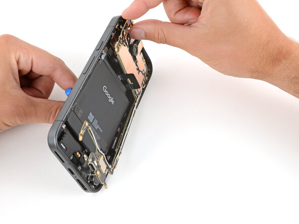

  23. Google Pixel 9a Logic Board Replacement, Lay the logic board down: passo 23, immagine 1 di 3 Google Pixel 9a Logic Board Replacement, Lay the logic board down: passo 23, immagine 2 di 3 Google Pixel 9a Logic Board Replacement, Lay the logic board down: passo 23, immagine 3 di 3
    • The logic board may fall out of place during this step. Hold it steady, but don't grip any of the camera lenses or connectors.
    • Apply a suction handle to the screen and use it to prop up your phone.
    • Gently lay the logic board down flat against your work surface, being careful not to strain the screen cable.

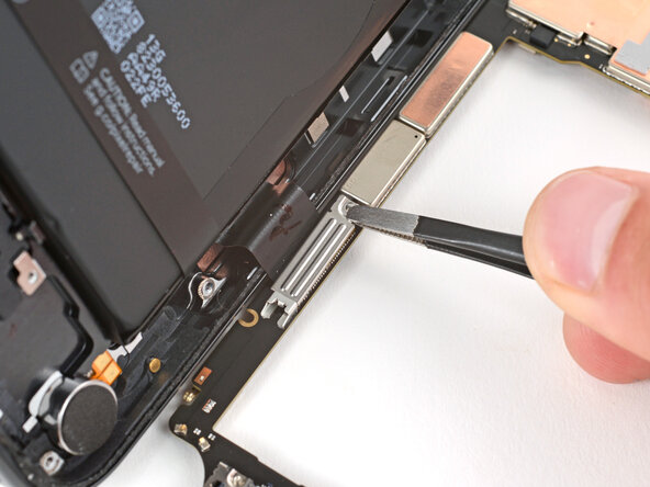

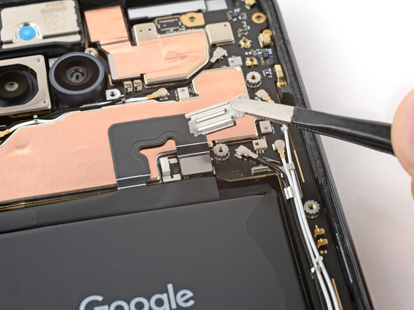

  24. Google Pixel 9a Logic Board Replacement, Remove the logic board connector cover: passo 24, immagine 1 di 2 Google Pixel 9a Logic Board Replacement, Remove the logic board connector cover: passo 24, immagine 2 di 2
    • Use a Torx Plus 3IP screwdriver to remove the 1.7 mm‑long screw securing the screen cable cover.
  25. Google Pixel 9a Logic Board Replacement, Remove the connector cover: passo 25, immagine 1 di 3 Google Pixel 9a Logic Board Replacement, Remove the connector cover: passo 25, immagine 2 di 3 Google Pixel 9a Logic Board Replacement, Remove the connector cover: passo 25, immagine 3 di 3
    • Use tweezers to lift and remove the screen cable cover.

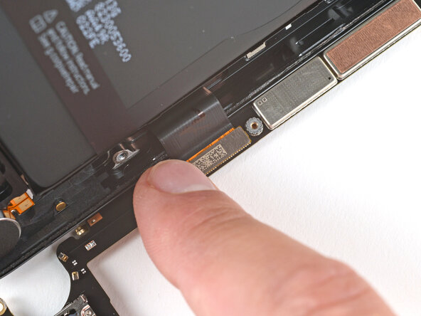

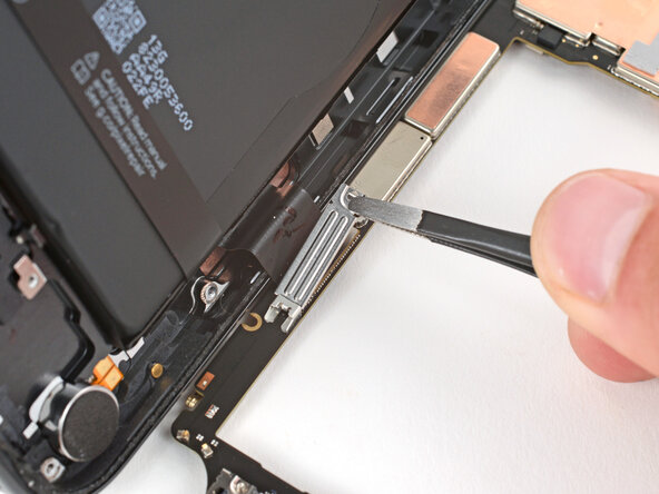

  26. Google Pixel 9a Logic Board Replacement, Disconnect the logic board: passo 26, immagine 1 di 2 Google Pixel 9a Logic Board Replacement, Disconnect the logic board: passo 26, immagine 2 di 2
    • Use the flat end of a spudger to pry up and disconnect the screen cable press connector.
  27. Google Pixel 9a Logic Board Replacement, Remove the logic board: passo 27, immagine 1 di 2 Google Pixel 9a Logic Board Replacement, Remove the logic board: passo 27, immagine 2 di 2
    • Slide the logic board away from the frame and remove it.

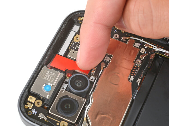

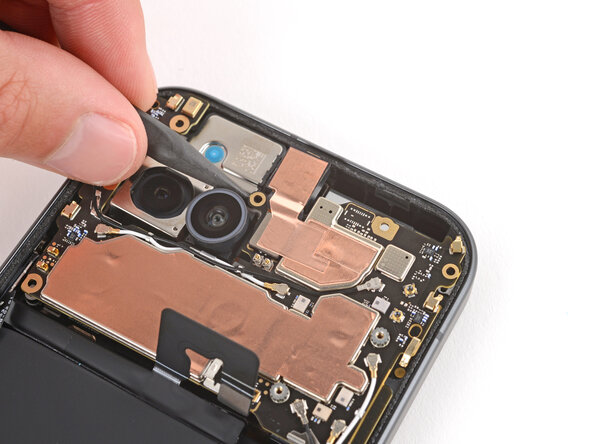

  28. Google Pixel 9a Logic Board Replacement, Remove the rear cameras: passo 28, immagine 1 di 3 Google Pixel 9a Logic Board Replacement, Remove the rear cameras: passo 28, immagine 2 di 3 Google Pixel 9a Logic Board Replacement, Remove the rear cameras: passo 28, immagine 3 di 3
    • Be careful not to smudge the camera lenses when removing and installing them. If you accidentally do, wipe them with a clean cloth.
    • Hold the logic board slightly above your work surface while working on the cameras—don't press the board against your work surface, or you may damage fragile components.
    • Use the flat end of a spudger to pry up and disconnect the ultrawide camera press connector.
    • Remove the ultrawide camera.
  29. Google Pixel 9a Logic Board Replacement: passo 29, immagine 1 di 3 Google Pixel 9a Logic Board Replacement: passo 29, immagine 2 di 3 Google Pixel 9a Logic Board Replacement: passo 29, immagine 3 di 3
    • Repeat the previous step to disconnect and remove the wide camera.

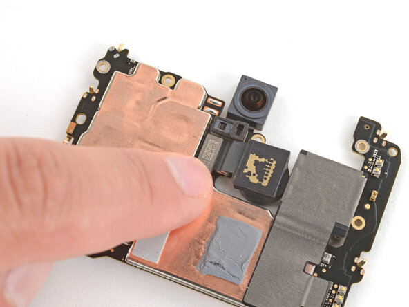

  30. Google Pixel 9a Logic Board Replacement, The logic board remains: passo 30, immagine 1 di 1
    • Congratulations on completing disassembly! The remaining steps will show how to reassemble your phone.
    • You'll need to transfer the cameras to your replacement logic board.
    • Compare your replacement logic board to the original—you may need to transfer remaining components (such as the black and white coaxial cables) or remove adhesive backings from the new part before you install it.

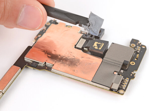

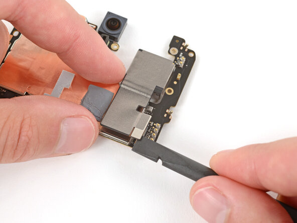

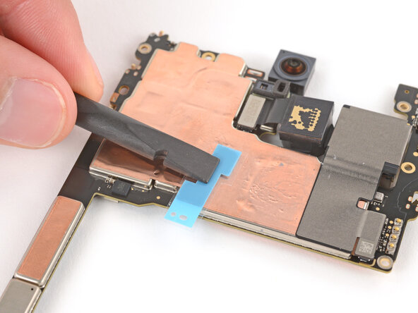

  33. Google Pixel 9a Logic Board Replacement, Check the thermal pads: passo 33, immagine 1 di 2 Google Pixel 9a Logic Board Replacement, Check the thermal pads: passo 33, immagine 2 di 2
    • Check the condition of the logic board thermal pads—they'll either be on the bottom of the board or stuck to the corresponding spot on the frame.
    • If the pads are ripped, torn, or otherwise damaged, follow the next five steps to replace them. If they aren't, skip ahead five steps.

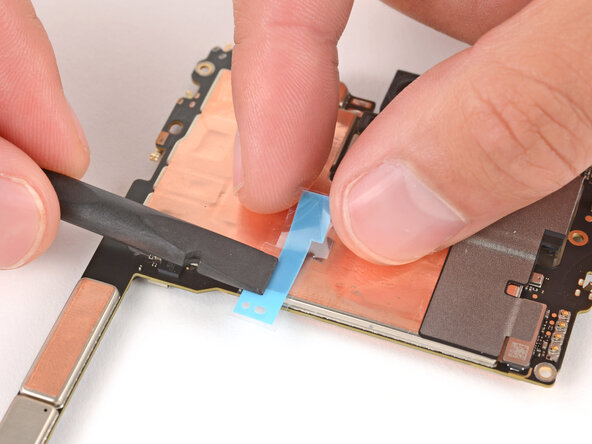

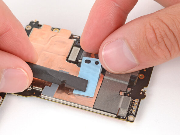

  34. Google Pixel 9a Logic Board Replacement, Remove the thermal pads: passo 34, immagine 1 di 3 Google Pixel 9a Logic Board Replacement, Remove the thermal pads: passo 34, immagine 2 di 3 Google Pixel 9a Logic Board Replacement, Remove the thermal pads: passo 34, immagine 3 di 3
    • Use the flat end of a spudger to scrape up and remove the damaged thermal pads.
  35. Google Pixel 9a Logic Board Replacement: passo 35, immagine 1 di 1
    • Use high‑concentration (>90%) isopropyl alcohol and a coffee filter to clean up and remove any residue where the thermal pads were.

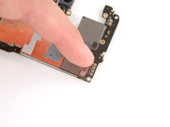

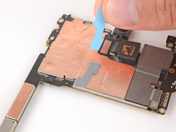

  36. Google Pixel 9a Logic Board Replacement, Apply the thermal pads: passo 36, immagine 1 di 3 Google Pixel 9a Logic Board Replacement, Apply the thermal pads: passo 36, immagine 2 di 3 Google Pixel 9a Logic Board Replacement, Apply the thermal pads: passo 36, immagine 3 di 3
    • The thermal pads are very delicate and can easily be misaligned when placing them and removing liners. Take your time when applying them—good placement will ensure proper heat dissipation.
    • Remove the textured liner from the smaller thermal pad.
    • Carefully place the pad onto the board.
    • Use this photo as a reference to help align the pad.
    • Use the flat end of a spudger or your finger to press down lightly on the entire surface of the thermal pad, securing it in place without deforming it.

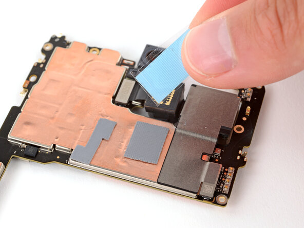

  37. Google Pixel 9a Logic Board Replacement: passo 37, immagine 1 di 2 Google Pixel 9a Logic Board Replacement: passo 37, immagine 2 di 2
    • Slowly lift and remove the remaining liners from the top of the thermal pad.
    • If the thermal pad start to lift up with the liners, lay it back down and press again to secure it.
  38. Google Pixel 9a Logic Board Replacement: passo 38, immagine 1 di 3 Google Pixel 9a Logic Board Replacement: passo 38, immagine 2 di 3 Google Pixel 9a Logic Board Replacement: passo 38, immagine 3 di 3
    • Repeat the previous two steps to apply the remaining, larger thermal pad.

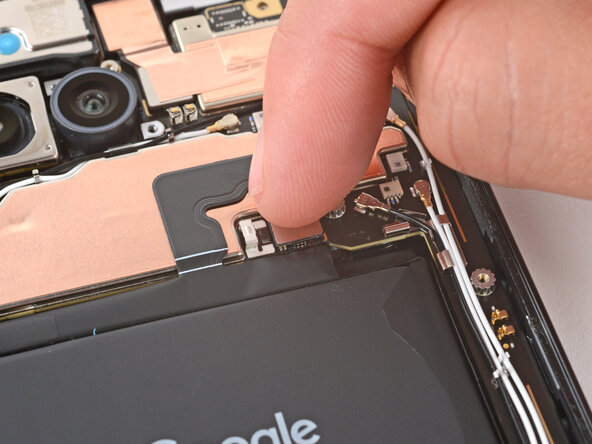

  40. Google Pixel 9a Logic Board Replacement, Connect the screen cable: passo 40, immagine 1 di 3 Google Pixel 9a Logic Board Replacement, Connect the screen cable: passo 40, immagine 2 di 3 Google Pixel 9a Logic Board Replacement, Connect the screen cable: passo 40, immagine 3 di 3
    • Align the screen cable press connector over its socket and press down with your fingertip—first on one side, then the other—until it clicks into place.

  44. Google Pixel 9a Logic Board Replacement, Put the logic board into place: passo 44, immagine 1 di 3 Google Pixel 9a Logic Board Replacement, Put the logic board into place: passo 44, immagine 2 di 3 Google Pixel 9a Logic Board Replacement, Put the logic board into place: passo 44, immagine 3 di 3
    • When inserting the logic board, make sure the battery cable doesn't get caught underneath. You may need to gently bend it out of the way.
    • Push the logic board toward the bottom of the frame and press the charging port down until it snaps into its cutout.
    • Press down on the center of the logic board's bottom edge until the clip near the battery engages.
  45. Google Pixel 9a Logic Board Replacement: passo 45, immagine 1 di 1
    • Push down on the top edge of the logic board so it goes into its recess. Make sure the cameras are sitting flush and not at odd angles.
  46. Google Pixel 9a Logic Board Replacement, Install the logic board screws: passo 46, immagine 1 di 2 Google Pixel 9a Logic Board Replacement, Install the logic board screws: passo 46, immagine 2 di 2
    • Use a 3IP Torx Plus screwdriver to install the two 2.8 mm‑long screws securing the logic board.
    • Make sure the logic board lays flat, with nothing caught underneath, before tightening these screws.
  47. Google Pixel 9a Logic Board Replacement, Install the front camera: passo 47, immagine 1 di 2 Google Pixel 9a Logic Board Replacement, Install the front camera: passo 47, immagine 2 di 2
    • Carefully peel up and remove the old copper foil from your front camera.
    • Place the camera into its recess.
    • Use your finger to press down and reconnect the camera press connector.
  48. Google Pixel 9a Logic Board Replacement, Apply new copper foil: passo 48, immagine 1 di 3 Google Pixel 9a Logic Board Replacement, Apply new copper foil: passo 48, immagine 2 di 3 Google Pixel 9a Logic Board Replacement, Apply new copper foil: passo 48, immagine 3 di 3
    • Remove the copper foil from its large clear liner and place it onto the front camera.
    • Don't remove any of the other liners yet.
    • Gently press down on the top section of the foil to secure it to the camera (the bottom section still has a plastic liner under it).
  49. Google Pixel 9a Logic Board Replacement: passo 49, immagine 1 di 3 Google Pixel 9a Logic Board Replacement: passo 49, immagine 2 di 3 Google Pixel 9a Logic Board Replacement: passo 49, immagine 3 di 3
    • Hold the top section of the copper foil in place with your finger, and use tweezers to slide the liner out from the bottom section of foil.
    • Gently press the bottom section of copper foil into place to secure it to the front camera press connector.
  50. Google Pixel 9a Logic Board Replacement: passo 50, immagine 1 di 3 Google Pixel 9a Logic Board Replacement: passo 50, immagine 2 di 3 Google Pixel 9a Logic Board Replacement: passo 50, immagine 3 di 3
    • Use tweezers to remove the remaining liner from the top of the copper foil.
  51. Google Pixel 9a Logic Board Replacement, Remove the old adhesive: passo 51, immagine 1 di 2 Google Pixel 9a Logic Board Replacement, Remove the old adhesive: passo 51, immagine 2 di 2
    • Use a spudger to scrape up and remove the six small pieces of adhesive around the rear cameras.
    • Use high‑concentration (>90%) isopropyl alcohol and a lint‑free cloth (or coffee filter) to clean up and remove any residue from the adhesives that were removed.
  52. Google Pixel 9a Logic Board Replacement, Apply the adhesive: passo 52, immagine 1 di 3 Google Pixel 9a Logic Board Replacement, Apply the adhesive: passo 52, immagine 2 di 3 Google Pixel 9a Logic Board Replacement, Apply the adhesive: passo 52, immagine 3 di 3
    • Remove the larger, clear liner from the inner housing adhesive and lay it in place around the camera holes.
    • Use the cutouts for the small silver pads to help align the adhesive.
    • Use the flat end of a spudger to firmly push down on each piece of adhesive, securing them in place.
    • Remove the colored liner using the pull tab on the top edge.
    • If the adhesive starts to pull up with the liner, lay it back in place and use your spudger to secure it again.

  54. Google Pixel 9a Logic Board Replacement, Connect the battery press connector: passo 54, immagine 1 di 2 Google Pixel 9a Logic Board Replacement, Connect the battery press connector: passo 54, immagine 2 di 2
    • Use your finger to align the battery press connector over its socket and press down to connect it.
    • Don't try to force the connector into place. If you're having trouble, reposition it and try again.
  55. Google Pixel 9a Logic Board Replacement, Install the battery connector cover: passo 55, immagine 1 di 3 Google Pixel 9a Logic Board Replacement, Install the battery connector cover: passo 55, immagine 2 di 3 Google Pixel 9a Logic Board Replacement, Install the battery connector cover: passo 55, immagine 3 di 3
    • Use tweezers to hook the left edge of the battery connector cover into place, then lay the cover down flat.
  56. Google Pixel 9a Logic Board Replacement: passo 56, immagine 1 di 2 Google Pixel 9a Logic Board Replacement: passo 56, immagine 2 di 2
    • Use a 3IP Torx Plus screwdriver to install the 1.7 mm‑long screw securing the battery connector cover.
  57. Google Pixel 9a Logic Board Replacement, Install the wireless charging assembly: passo 57, immagine 1 di 2 Google Pixel 9a Logic Board Replacement, Install the wireless charging assembly: passo 57, immagine 2 di 2
    • Place the wireless charging assembly onto the frame.
  58. Google Pixel 9a Logic Board Replacement: passo 58, immagine 1 di 3 Google Pixel 9a Logic Board Replacement: passo 58, immagine 2 di 3 Google Pixel 9a Logic Board Replacement: passo 58, immagine 3 di 3
    • Use your fingers to firmly press around the perimeter of the wireless charging assembly to re‑engage all of its clips.
  59. Google Pixel 9a Logic Board Replacement, Install the wireless charging assembly screws: passo 59, immagine 1 di 2 Google Pixel 9a Logic Board Replacement, Install the wireless charging assembly screws: passo 59, immagine 2 di 2
    • Use a Torx Plus 3IP screwdriver to install the 16 screws securing the wireless charging assembly:
  60. Google Pixel 9a Logic Board Replacement, Remove the old rear cover adhesive: passo 60, immagine 1 di 3 Google Pixel 9a Logic Board Replacement, Remove the old rear cover adhesive: passo 60, immagine 2 di 3 Google Pixel 9a Logic Board Replacement, Remove the old rear cover adhesive: passo 60, immagine 3 di 3
    • Take your time during the next two steps. A clean frame allows replacement adhesive to lay evenly, ensuring a better bond.
    • Use a spudger and tweezers to scrape up and remove all the old rear cover adhesive from the perimeter of your phone.
    • If you scrape up a piece big enough to grip with your fingers, you can pull long sections of the adhesive up. Pull slowly and straight in the opposite direction of the adhesive.
  61. Google Pixel 9a Logic Board Replacement, Clean the frame: passo 61, immagine 1 di 1
    • Using some high-concentration (>90%) isopropyl alcohol and a lint‑free cloth (or coffee filter), clean the areas of the frame where the adhesive was.

  63. Google Pixel 9a Logic Board Replacement, Peel the liner halfway down: passo 63, immagine 1 di 1
    • Peel down the top half of the large, clear liner to expose the adhesive—don't fully remove the liner yet.
  64. Google Pixel 9a Logic Board Replacement, Apply the adhesive: passo 64, immagine 1 di 3 Google Pixel 9a Logic Board Replacement, Apply the adhesive: passo 64, immagine 2 di 3 Google Pixel 9a Logic Board Replacement, Apply the adhesive: passo 64, immagine 3 di 3
    • Take your time aligning the adhesive with the frame—it's very sticky and can't be moved once you apply it.
    • With the larger, clear liner folded towards the bottom of the phone, lay the exposed top edge of the adhesive onto the frame.
    • Use the lip of the frame to help align the adhesive.
    • Once the top edge is properly aligned, gently press down on the top corners with your fingers to secure the adhesive.
  65. Google Pixel 9a Logic Board Replacement: passo 65, immagine 1 di 3 Google Pixel 9a Logic Board Replacement: passo 65, immagine 2 di 3 Google Pixel 9a Logic Board Replacement: passo 65, immagine 3 di 3
    • Slowly lay the rest of the adhesive onto the frame, pressing it into place and peeling away the larger liner as you go.

  68. Google Pixel 9a Logic Board Replacement, Remove the old camera bezel adhesive: passo 68, immagine 1 di 2 Google Pixel 9a Logic Board Replacement, Remove the old camera bezel adhesive: passo 68, immagine 2 di 2
    • If the camera bezel detached when removing the rear cover, follow the next five steps to install it. Otherwise, skip down five steps.
    • Use a spudger to scrape up and remove any of the old adhesive from the camera bezel and its corresponding spot on the rear cover.
  69. Google Pixel 9a Logic Board Replacement, Remove the adhesive residue: passo 69, immagine 1 di 2 Google Pixel 9a Logic Board Replacement, Remove the adhesive residue: passo 69, immagine 2 di 2
    • Use high-concentration (>90%) isopropyl alcohol and a lint‑free cloth (or coffee filter) to clean up and remove any adhesive residue from the camera bezel and its corresponding spot on the rear cover.
  70. Google Pixel 9a Logic Board Replacement, Apply the adhesive: passo 70, immagine 1 di 2 Google Pixel 9a Logic Board Replacement, Apply the adhesive: passo 70, immagine 2 di 2
    • Remove the large, clear liner from the camera bezel adhesive.
    • Put the adhesive over the top of the camera bezel and set it in place.
  71. Google Pixel 9a Logic Board Replacement: passo 71, immagine 1 di 3 Google Pixel 9a Logic Board Replacement: passo 71, immagine 2 di 3 Google Pixel 9a Logic Board Replacement: passo 71, immagine 3 di 3
    • Use a spudger to firmly press around the perimeter of the camera bezel to secure the adhesive.
    • Remove the second, colored liner from the camera bezel adhesive.

  73. Google Pixel 9a Logic Board Replacement, Remove the old rear cover adhesive: passo 73, immagine 1 di 2 Google Pixel 9a Logic Board Replacement, Remove the old rear cover adhesive: passo 73, immagine 2 di 2
    • Use the flat end of a spudger to scrape up and remove any all the old adhesive that stayed on the back cover, including the five pieces of small, oval‑shaped adhesive.
    • If you don't see all the oval adhesives, some might've stuck to the phone frame.
  74. Google Pixel 9a Logic Board Replacement: passo 74, immagine 1 di 1
    • Use high‑concentration (>90%) isopropyl alcohol and a lint‑free cloth (or coffee filter) to clean up and remove any residue from the adhesives you removed.

  79. Google Pixel 9a Logic Board Replacement, Install the rear cover: passo 79, immagine 1 di 3 Google Pixel 9a Logic Board Replacement, Install the rear cover: passo 79, immagine 2 di 3 Google Pixel 9a Logic Board Replacement, Install the rear cover: passo 79, immagine 3 di 3
    • Align the rear cover over the frame and press it into place.
