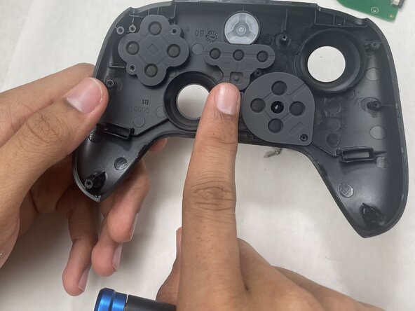

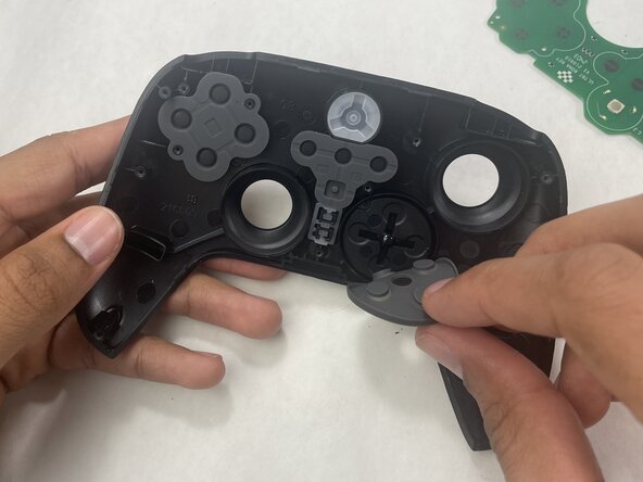

  6. 8BitDo Ultimate Wireless Button Conductive Pad Replacement: passo 6, immagine 1 di 2 8BitDo Ultimate Wireless Button Conductive Pad Replacement: passo 6, immagine 2 di 2
    • Lift button conductive pads out of the shell with your hands.
    • Replace or clean as needed.
    • If cleaning with water, make sure pads are fully dry before replacing.
