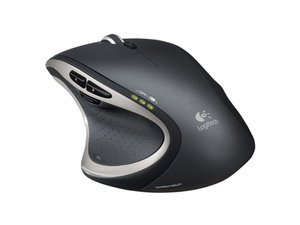

Double click when single left click function is used
Anyone know a solution to this? I try to click with the left button and it ends up double clicking. It also has trouble when click + hold is performed.

I know this thread is dead, but your mouse likely just has a a dirty/damaged microswitch on that button. Just clean it or replace it.

"Press the right click button and hold-it, turn the mouse off and on, leave the right mouse button pressed while clicking on the left click button 5 times Quit pressing the right click button and turn the mouse off. Click and hold the right mouse button, turn the mouse on and finally release the right mouse button." it works!!!!

I have also had this problem with several Logitech mice, including the performance MX
I fixed mine by desoldering and replacing the left microswitch with another (stolen from another, broken mouse). This is reasonably straightforward if you're comfortable with soldering, it just requires quite a lot of disassembly to get to the underneath of the logic board.
Alternatively, and much more simply, you can try opening up the microswitch and bending the internal spring back into shape. This is described in detail here (not my video).

Much easier solution is to take the microswitch apart and replace the spring from a working microswitch!

Just open the microswitch. Remove the faulty spring. Replace spring from a working microswitch. This is much less hassle than desoldering the microswitch!

Even easier: I've found that you can actually bend the spring and it will work just as good as new. I performed this repair and the mouse is still working well years later.

just replace the omorn switch in mouse it cost less than 2 bucks with shipping.
