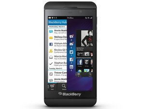

Replacement LCD Touch Screen
Hey,
I cracked lcd screen, after the fall of the hand
Now, the screen can still come up with an image, but can not touch that.
so, what should I replace

It looks to me that the digitiser/touchscreen is part of the LCD so you probably need to replace that entire assembly
Step 12 from the guide
The display unit is ultra thin, a feat achieved by some serious fusing. The digitizer is applied directly to the glass and fused in turn to the LCD.

I also cracked my LCD screen, resulting in an intangible interface. This is because Blackberry only uses one layer of screen, whereas Apple uses two layers so that the phone can still be used after being cracked. I tried to replace it myself but it turns out you need very specific tools to separate the LCD from the screen. I ended up doing more damage than repair by trying to just replace the screen. A full replacement is needed unfortunately. It cost me about a hundred dollars.

Touch screen and digitizer..they come as 1 unit..roughly 15 $...yes 15...they're is step by step you tube repair vid...you also need the tiny screwdriver s too.
