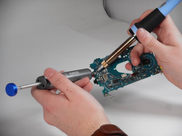

  9. Sony TCM-450 Microphone Input and Audio Output Replacement, Microphone Input and Audio Output: passo 9, immagine 1 di 2 Sony TCM-450 Microphone Input and Audio Output Replacement, Microphone Input and Audio Output: passo 9, immagine 2 di 2
    • For both the microphone input and audio output, use a desoldering pump for all three solder points. Use the technique here for all of the soldering points.
    • To use the desoldering pump create a suction over the solder point and after the solder has melted press the button on the pump like shown in pictures.
    • If you are unfamiliar with desoldering pumps, please consult the iFixit Desoldering Pump Guide.
