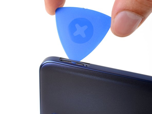

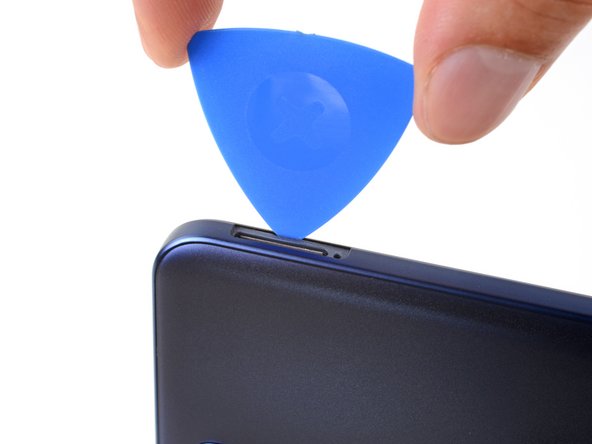

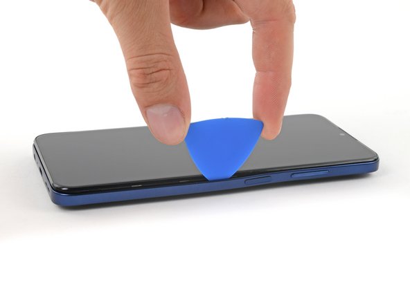

  3. Nokia G310 5G Back Cover Replacement, Insert an opening pick: passo 3, immagine 1 di 3 Nokia G310 5G Back Cover Replacement, Insert an opening pick: passo 3, immagine 2 di 3 Nokia G310 5G Back Cover Replacement, Insert an opening pick: passo 3, immagine 3 di 3
    • The back cover is held in place by plastic clips.
    • Insert an opening pick under the small notch in the SIM card tray slot.

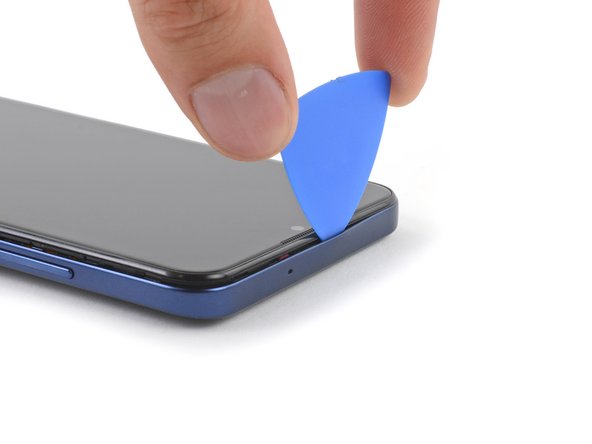

  4. Nokia G310 5G Back Cover Replacement, Release the plastic clips: passo 4, immagine 1 di 3 Nokia G310 5G Back Cover Replacement, Release the plastic clips: passo 4, immagine 2 di 3 Nokia G310 5G Back Cover Replacement, Release the plastic clips: passo 4, immagine 3 di 3
    • Position the opening pick at a steep downward angle between the back cover and the screen assembly.
    • Slide the opening pick down the left edge of the phone to release the plastic clips.

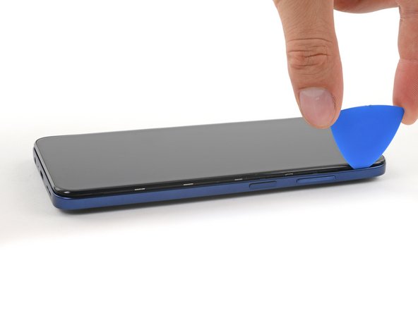

  6. Nokia G310 5G Back Cover Replacement: passo 6, immagine 1 di 3 Nokia G310 5G Back Cover Replacement: passo 6, immagine 2 di 3 Nokia G310 5G Back Cover Replacement: passo 6, immagine 3 di 3
    • Slide the opening pick up the right edge to continue releasing the plastic clips.

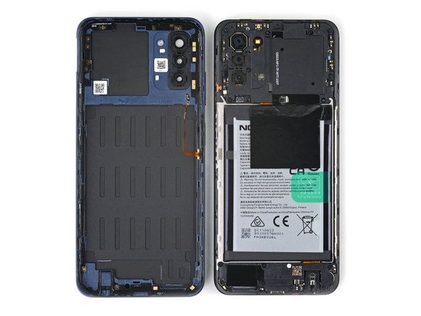

  8. Nokia G310 5G Back Cover Replacement, Flip open the back cover: passo 8, immagine 1 di 3 Nokia G310 5G Back Cover Replacement, Flip open the back cover: passo 8, immagine 2 di 3 Nokia G310 5G Back Cover Replacement, Flip open the back cover: passo 8, immagine 3 di 3
    • With the phone laying screen-side down, carefully lift the right edge of the back cover, opening it like a book.
    • Take care not to strain or tear the attached fingerprint reader cable during this procedure.
    • Lay the back cover next to the phone.

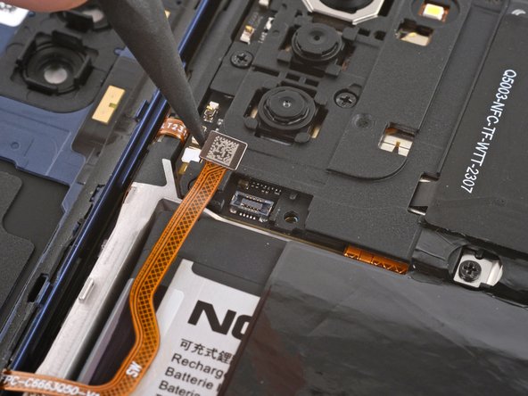

  11. Nokia G310 5G Back Cover Replacement, Disconnect the fingerprint reader: passo 11, immagine 1 di 3 Nokia G310 5G Back Cover Replacement, Disconnect the fingerprint reader: passo 11, immagine 2 di 3 Nokia G310 5G Back Cover Replacement, Disconnect the fingerprint reader: passo 11, immagine 3 di 3
    • Use the pointed end of a spudger to disconnect the fingerprint reader by prying the connector straight up from its socket.
    • To re-attach press connectors like this one, carefully align and press down on one side until it clicks into place, then repeat on the other side. Don't press down on the middle. If the connector is misaligned, the pins can bend and cause permanent damage.
    • Remove the back cover.

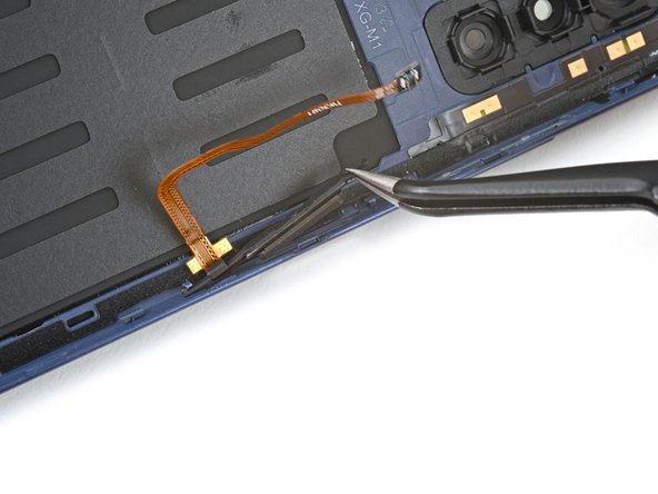

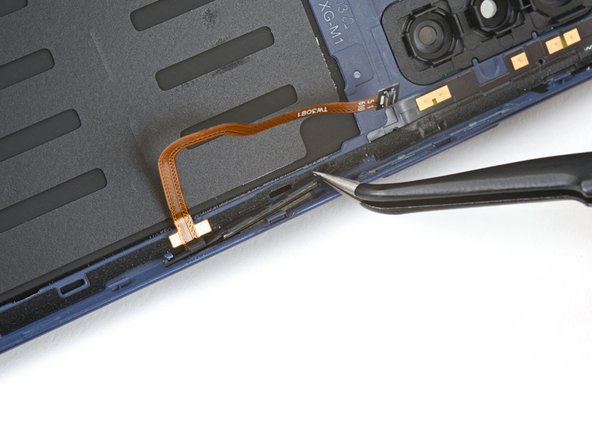

  12. Nokia G310 5G Back Cover Replacement, Release the fingerprint reader: passo 12, immagine 1 di 3 Nokia G310 5G Back Cover Replacement, Release the fingerprint reader: passo 12, immagine 2 di 3 Nokia G310 5G Back Cover Replacement, Release the fingerprint reader: passo 12, immagine 3 di 3
    • Using a pair of tweezers, grip the top of the fingerprint reader and lift it out and around the top plastic tab, separating it from the back cover.
