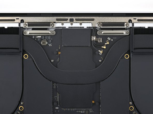

  21. MacBook Pro 16" Late 2023 Logic Board Replacement, Unfasten the antenna bar's connector bracket: passo 21, immagine 1 di 2 MacBook Pro 16" Late 2023 Logic Board Replacement, Unfasten the antenna bar's connector bracket: passo 21, immagine 2 di 2
    • Use a 3IP Torx Plus screwdriver to remove the three 2.1 mm screws securing the antenna bar bracket and coaxial cable cover to the frame.
  22. MacBook Pro 16" Late 2023 Logic Board Replacement: passo 22, immagine 1 di 2 MacBook Pro 16" Late 2023 Logic Board Replacement: passo 22, immagine 2 di 2
    Attrezzo utilizzato in questo passaggio:
    • Use tweezers, or your fingers, to remove the cover on top of the antenna bar's coaxial cables.
  23. MacBook Pro 16" Late 2023 Logic Board Replacement, Disconnect the antenna bar: passo 23, immagine 1 di 2 MacBook Pro 16" Late 2023 Logic Board Replacement, Disconnect the antenna bar: passo 23, immagine 2 di 2
    • Use the tip of a spudger to pry up and disconnect the antenna bar's coaxial cable.
    • Repeat for the two other cables.
    • During reassembly, these can be tricky to reconnect. Hold each connector in place over its socket and press down with the flat end of a spudger. The connector should snap into place.

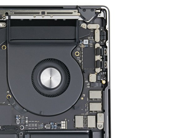

  31. MacBook Pro 16" Late 2023 Logic Board Replacement, Unfasten the right-side cable covers: passo 31, immagine 1 di 2 MacBook Pro 16" Late 2023 Logic Board Replacement, Unfasten the right-side cable covers: passo 31, immagine 2 di 2
    • Use a 3IP Torx driver to remove the 11 screws securing the right cable covers to the frame:
    • Ten 2.1 mm screws
    • One 3.6 mm screw
  32. MacBook Pro 16" Late 2023 Logic Board Replacement, Remove the right cable covers: passo 32, immagine 1 di 2 MacBook Pro 16" Late 2023 Logic Board Replacement, Remove the right cable covers: passo 32, immagine 2 di 2
    • Use tweezers, or your fingers, to remove the five right cable covers.
  33. MacBook Pro 16" Late 2023 Logic Board Replacement, Disconnect the right speaker: passo 33, immagine 1 di 2 MacBook Pro 16" Late 2023 Logic Board Replacement, Disconnect the right speaker: passo 33, immagine 2 di 2
    • Use the flat end of a spudger to pry up and disconnect the right speaker's press connector.
  34. MacBook Pro 16" Late 2023 Logic Board Replacement, Disconnect the headphone jack: passo 34, immagine 1 di 2 MacBook Pro 16" Late 2023 Logic Board Replacement, Disconnect the headphone jack: passo 34, immagine 2 di 2
    • Use a spudger to pry up and disconnect the headphone jack's press connector.
  35. MacBook Pro 16" Late 2023 Logic Board Replacement, Disconnect the right USB-C ports: passo 35, immagine 1 di 3 MacBook Pro 16" Late 2023 Logic Board Replacement, Disconnect the right USB-C ports: passo 35, immagine 2 di 3 MacBook Pro 16" Late 2023 Logic Board Replacement, Disconnect the right USB-C ports: passo 35, immagine 3 di 3
    • Use a spudger to pry up and disconnect the right USB-C ports' two press connectors.
  36. MacBook Pro 16" Late 2023 Logic Board Replacement, Disconnect the MagSafe port: passo 36, immagine 1 di 2 MacBook Pro 16" Late 2023 Logic Board Replacement, Disconnect the MagSafe port: passo 36, immagine 2 di 2
    • Use a spudger to pry up and disconnect the MagSafe port's press connector.
  37. MacBook Pro 16" Late 2023 Logic Board Replacement, Disconnect the lid angle sensor cable: passo 37, immagine 1 di 2 MacBook Pro 16" Late 2023 Logic Board Replacement, Disconnect the lid angle sensor cable: passo 37, immagine 2 di 2
    • Use a spudger to pry up and disconnect the lid angle sensor's press connector.
  38. MacBook Pro 16" Late 2023 Logic Board Replacement, Unfasten the left cable covers: passo 38, immagine 1 di 2 MacBook Pro 16" Late 2023 Logic Board Replacement, Unfasten the left cable covers: passo 38, immagine 2 di 2
    • Use a 3IP Torx Plus driver to remove the six screws securing the left cable covers to the frame:
    • Five 2.1 mm screws
    • One 3.6 mm screw
  39. MacBook Pro 16" Late 2023 Logic Board Replacement, Remove the left cable covers: passo 39, immagine 1 di 1
    • Use tweezers, or your fingers, to remove the three left cable covers.

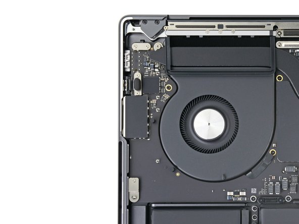

  40. MacBook Pro 16" Late 2023 Logic Board Replacement, Disconnect the left speaker: passo 40, immagine 1 di 2 MacBook Pro 16" Late 2023 Logic Board Replacement, Disconnect the left speaker: passo 40, immagine 2 di 2
    • Use the flat end of a spudger to pry up and disconnect the left speaker's press connector.
  41. MacBook Pro 16" Late 2023 Logic Board Replacement, Disconnect the left USB-C port: passo 41, immagine 1 di 2 MacBook Pro 16" Late 2023 Logic Board Replacement, Disconnect the left USB-C port: passo 41, immagine 2 di 2
    • Use a spudger to pry up and disconnect the left USB-C port's press connector.
  42. MacBook Pro 16" Late 2023 Logic Board Replacement, Disconnect the Touch ID sensor: passo 42, immagine 1 di 2 MacBook Pro 16" Late 2023 Logic Board Replacement, Disconnect the Touch ID sensor: passo 42, immagine 2 di 2
    • Use a spudger to pry up and disconnect the Touch ID sensor's press connector.

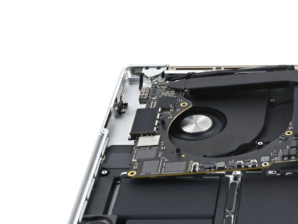

  43. MacBook Pro 16" Late 2023 Logic Board Replacement, Disconnect the keyboard: passo 43, immagine 1 di 3 MacBook Pro 16" Late 2023 Logic Board Replacement, Disconnect the keyboard: passo 43, immagine 2 di 3 MacBook Pro 16" Late 2023 Logic Board Replacement, Disconnect the keyboard: passo 43, immagine 3 di 3
  44. MacBook Pro 16" Late 2023 Logic Board Replacement: passo 44, immagine 1 di 3 MacBook Pro 16" Late 2023 Logic Board Replacement: passo 44, immagine 2 di 3 MacBook Pro 16" Late 2023 Logic Board Replacement: passo 44, immagine 3 di 3
    • Use a spudger to gently pry up the locking flap on the two ZIF connectors for the keyboard cables.
  45. MacBook Pro 16" Late 2023 Logic Board Replacement: passo 45, immagine 1 di 3 MacBook Pro 16" Late 2023 Logic Board Replacement: passo 45, immagine 2 di 3 MacBook Pro 16" Late 2023 Logic Board Replacement: passo 45, immagine 3 di 3
    • Disconnect the keyboard and keyboard backlight cables by sliding them out from their sockets on the logic board.
  46. MacBook Pro 16" Late 2023 Logic Board Replacement, Disconnect the fans: passo 46, immagine 1 di 3 MacBook Pro 16" Late 2023 Logic Board Replacement, Disconnect the fans: passo 46, immagine 2 di 3 MacBook Pro 16" Late 2023 Logic Board Replacement, Disconnect the fans: passo 46, immagine 3 di 3
    • Peel back any tape covering the right fan cable connector.
  47. MacBook Pro 16" Late 2023 Logic Board Replacement: passo 47, immagine 1 di 2 MacBook Pro 16" Late 2023 Logic Board Replacement: passo 47, immagine 2 di 2
    • Use a spudger to gently pry up the locking flap on the ZIF connector for the right fan cable.
  48. MacBook Pro 16" Late 2023 Logic Board Replacement: passo 48, immagine 1 di 2 MacBook Pro 16" Late 2023 Logic Board Replacement: passo 48, immagine 2 di 2
    • Disconnect the right fan cable by sliding it out from its socket on the logic board.
  49. MacBook Pro 16" Late 2023 Logic Board Replacement, Reposition the right fan cable: passo 49, immagine 1 di 2 MacBook Pro 16" Late 2023 Logic Board Replacement, Reposition the right fan cable: passo 49, immagine 2 di 2
    • The right fan cable is lightly adhered to the logic board.
    • Use tweezers to pull the fan cable away from the logic board and separate the adhesive.
    • The fan cables are incredibly delicate and prone to tearing; use caution when bending them with tools.

    • Repeat the previous disconnection and reposition procedure for the left fan cable.
  51. MacBook Pro 16" Late 2023 Logic Board Replacement, Unfasten the logic board: passo 51, immagine 1 di 2 MacBook Pro 16" Late 2023 Logic Board Replacement, Unfasten the logic board: passo 51, immagine 2 di 2
    • Use a 5IP Torx driver to remove the ten screws securing the logic board to the frame:
    • Six 3.9 mm screws
    • Four 4.7 mm screws
    • Use a 4 mm Hex driver to remove the two 6 mm screws securing the logic board to the frame.
    • Use a T6 Torx driver to remove the two 6 mm screws securing the heat sink to the logic board and frame.
  52. MacBook Pro 16" Late 2023 Logic Board Replacement, Release the logic board's clips: passo 52, immagine 1 di 2 MacBook Pro 16" Late 2023 Logic Board Replacement, Release the logic board's clips: passo 52, immagine 2 di 2
    • Insert a spudger between the right side of the logic board and the frame.
    • Pry up with the spudger to release the logic board from its clips.
  53. MacBook Pro 16" Late 2023 Logic Board Replacement: passo 53, immagine 1 di 2 MacBook Pro 16" Late 2023 Logic Board Replacement: passo 53, immagine 2 di 2
    • Insert a spudger between the bottom of the logic board and the frame.
  54. MacBook Pro 16" Late 2023 Logic Board Replacement, Remove the logic board: passo 54, immagine 1 di 3 MacBook Pro 16" Late 2023 Logic Board Replacement, Remove the logic board: passo 54, immagine 2 di 3 MacBook Pro 16" Late 2023 Logic Board Replacement, Remove the logic board: passo 54, immagine 3 di 3
    • Gently lift up the logic board by its right side to release it from its alignment pegs.
    • If it feels like it's not coming out, check that all the cables are disconnected.
    • Pull the logic board away from the left side of the device to separate the HDMI and SDXC ports from their slots in the frame.
    • Remove the logic board.
  55. MacBook Pro 16" Late 2023 Logic Board Replacement, Reassembly information: passo 55, immagine 1 di 3 MacBook Pro 16" Late 2023 Logic Board Replacement, Reassembly information: passo 55, immagine 2 di 3 MacBook Pro 16" Late 2023 Logic Board Replacement, Reassembly information: passo 55, immagine 3 di 3
    • During reassembly, perform the following:
    • Make sure all 17 connectors are above the logic board before securing it back into the frame.
    • If you're having trouble positioning the connectors, use tape to keep them out of the way.
    • Hold the rubber spacers out of the way so the fins can drop into their recesses.
    • When reinstalling the logic board, insert the left side first to reposition the HMDI and SDXC ports.
    • Use your fingers to slightly compress the HDMI port to fit it into its recess. Otherwise, the logic board won't sit correctly.
