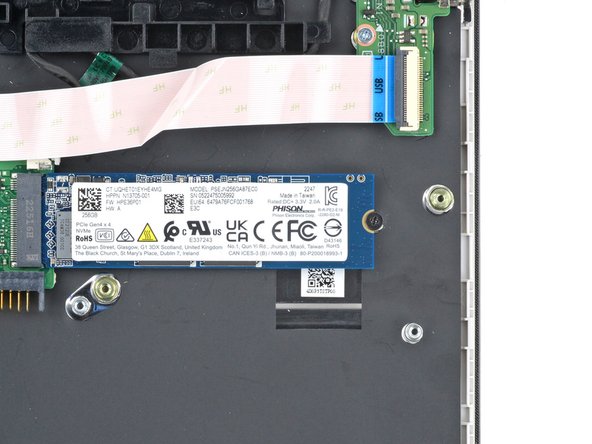

  16. HP 15-dy SSD Replacement, Remove the SSD screw: passo 16, immagine 1 di 2 HP 15-dy SSD Replacement, Remove the SSD screw: passo 16, immagine 2 di 2
    • Use a Phillips screwdriver to remove the 2.5 mm-long screw securing the SSD.

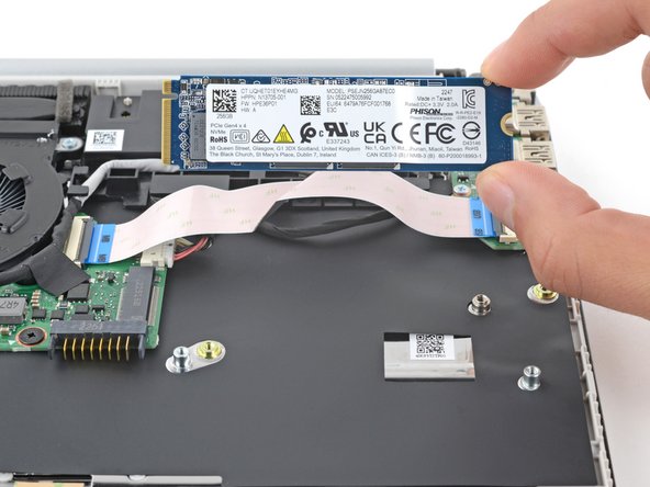

  17. HP 15-dy SSD Replacement, Remove the SSD: passo 17, immagine 1 di 3 HP 15-dy SSD Replacement, Remove the SSD: passo 17, immagine 2 di 3 HP 15-dy SSD Replacement, Remove the SSD: passo 17, immagine 3 di 3
    • Grip the SSD by its edges and pull it straight out of its socket to remove it.
    • Don't pull up at a sharp angle, as this could damage the SSD and its socket.
    • During reassembly, if your model has an SSD thermal pad, make sure it's transferred to the replacement SSD.
