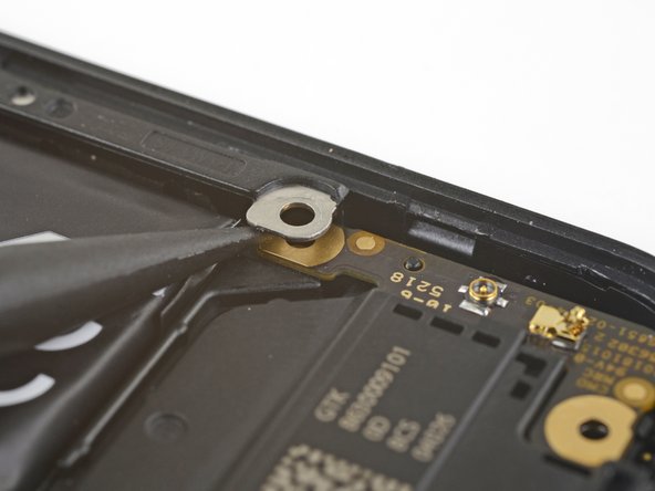

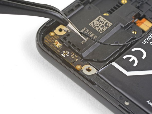

  25. Google Pixel 3a Loudspeaker Replacement, Loudspeaker: passo 25, immagine 1 di 3 Google Pixel 3a Loudspeaker Replacement, Loudspeaker: passo 25, immagine 2 di 3 Google Pixel 3a Loudspeaker Replacement, Loudspeaker: passo 25, immagine 3 di 3
    • Use the point of a spudger the pry up and disconnect the black antenna cable from its board socket.
    • De-route the black antenna cable from the retaining clips and bend it out of the way.

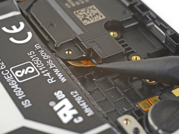

  26. Google Pixel 3a Loudspeaker Replacement: passo 26, immagine 1 di 2 Google Pixel 3a Loudspeaker Replacement: passo 26, immagine 2 di 2
    • Slide the point of a spudger underneath the loudspeaker's flex contact pad and pry it loose from the phone frame.

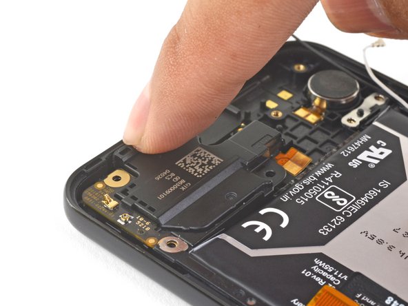

  29. Google Pixel 3a Loudspeaker Replacement: passo 29, immagine 1 di 3 Google Pixel 3a Loudspeaker Replacement: passo 29, immagine 2 di 3 Google Pixel 3a Loudspeaker Replacement: passo 29, immagine 3 di 3

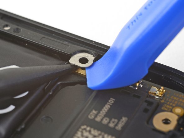

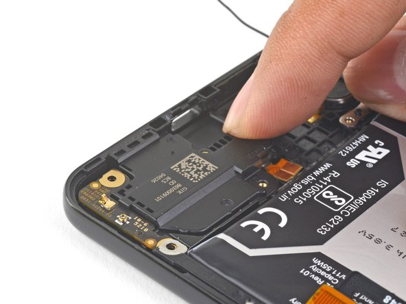

    • The loudspeaker itself is adhered to the phone frame near the right edge of the phone.
    • Slide the flat end of a spudger 1/2" (13 mm) underneath the loudspeaker's top-left screw hole and keep it there.

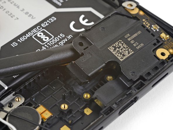

  30. Google Pixel 3a Loudspeaker Replacement: passo 30, immagine 1 di 3 Google Pixel 3a Loudspeaker Replacement: passo 30, immagine 2 di 3 Google Pixel 3a Loudspeaker Replacement: passo 30, immagine 3 di 3
    • Insert the edge of an opening tool behind the loudspeaker's bottom edge.
    • Pry with the opening tool to loosen the loudspeaker enough to wiggle it out of its recess.
    • Remove the loudspeaker.
  31. Google Pixel 3a Loudspeaker Replacement: passo 31, immagine 1 di 3 Google Pixel 3a Loudspeaker Replacement: passo 31, immagine 2 di 3 Google Pixel 3a Loudspeaker Replacement: passo 31, immagine 3 di 3
    • This step shows how to reinstall the loudspeaker back into its recess.
    • Slide the top-right corner of the loudspeaker underneath the right support bracket's screw hole.
    • Use your fingers to push the bottom edge of the loudspeaker in place.
    • Push the remaining edges into place. The loudspeaker should pop into its recess and sit flush against the bottom of the phone.
    • The loudspeaker is a tight fit and may require some wiggling and light pressure to snap it in place.
  32. Google Pixel 3a Loudspeaker Replacement: passo 32, immagine 1 di 2 Google Pixel 3a Loudspeaker Replacement: passo 32, immagine 2 di 2
    • If your replacement loudspeaker did not come with an antenna board, transfer the old one to your replacement.
    • The antenna board is adhered lightly in place. Gently bend the antenna board's right edge slightly upwards to break the adhesive and clear the alignment peg.
    • Slide the antenna board away from the loudspeaker and transfer it to your replacement.
