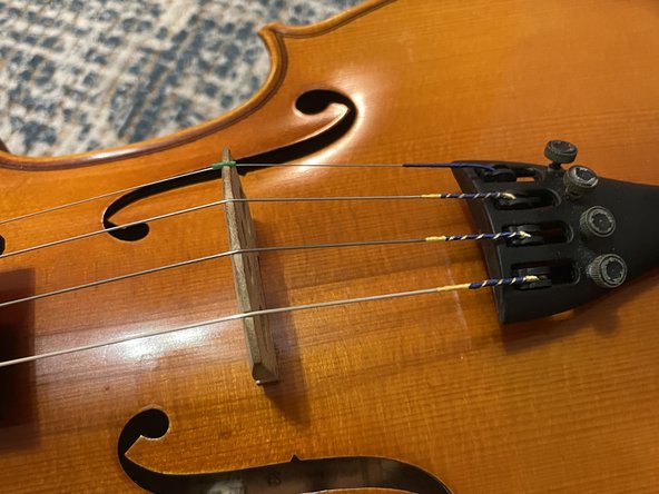

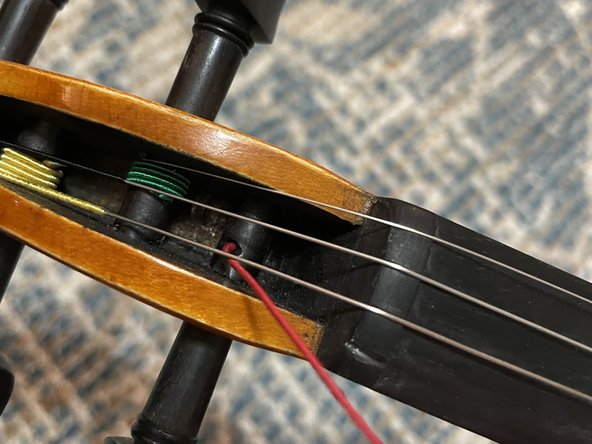

      • To remove the string from the scroll peg of the violin, you should pull the loosened string out of the hole located in the peg. Be gentile in pulling. If the string does not release by easily pulling, you should rotate the peg until the string is uncoiled completely.
      • After removing each string from the scroll peg, you should remove the ball end of the string from the fine tuners. To do this, slide the ball end of the string out of the slot it sits in. This step can sometimes happen automatically once the scroll peg end of the string is removed.
      • It is important to note that during this step, your bridge will fall out of position. Do not worry, as the bridge is not attached to the violin. It will be important for you to reposition the bridge in a following step, so keep it close by.

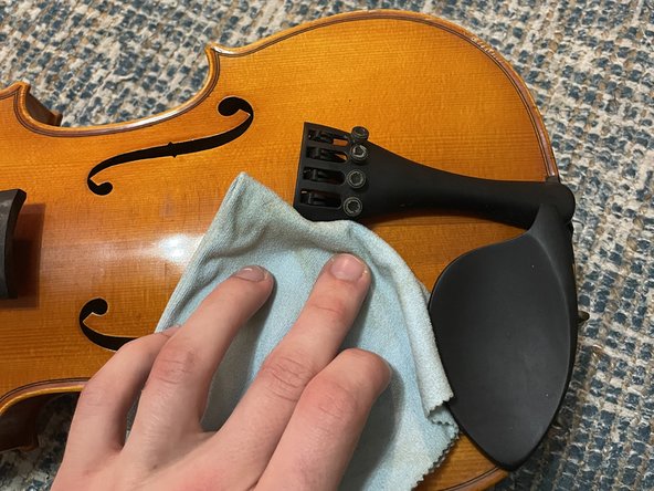

      • Once the strings are removed, it is a good idea for you to clean your violin. With the strings being removed, accessing hard to reach areas becomes easier. When cleaning, you should use a microfiber cloth to remove any dust or rosin buildup around the violin.

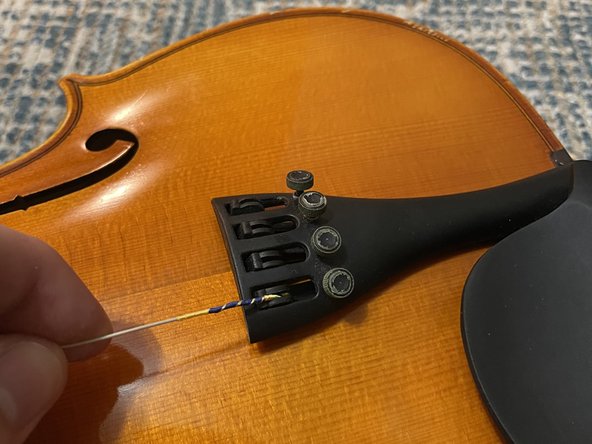

      • When restringing, you should start with the fine tuners of the violin. Slide the ball of the string back into the fine tuner, being sure that you place the correct string in each fine tuner.
      • After securing the ball of the string into the fine tuner, you should run the string over the corresponding slot in the bridge. Run the string up and to the corresponding peg.

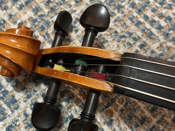

      • The outside strings, G and E, are to be inserted into the peg holes closest to the body of the violin. The middle strings, D and A, should be inserted into the further placed peg holes.

      • Once the strings are inserted into their respective holes, you should begin the tightening process. You should do this by repeating a similar method to the way you loosened the strings. Starting with the lowest, make one to two full rotations before moving to the next. Repeat this until the strings have created equal tension on the bridge.
      • Repositioning the bridge will be important for you to do in this step. Place the bridge under the strings once they have been wound a few times around the peg. As you tighten the strings, be sure the bridge does not move out of its respective spot.
