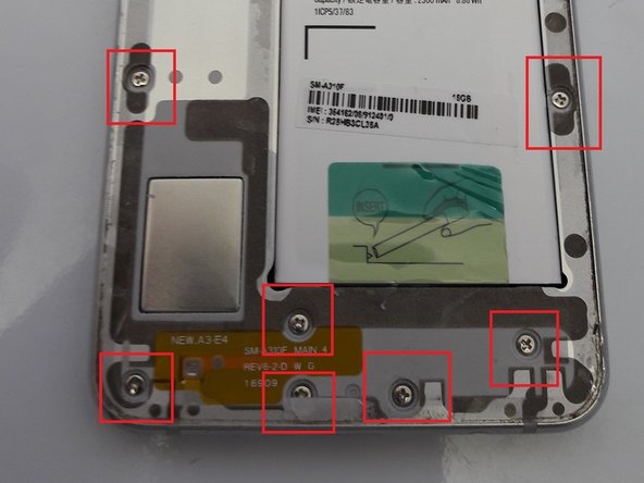

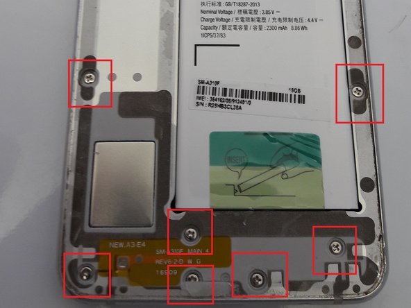

  3. Samsung A3 2016 Model - A310F Display / LCD Replacement: passo 3, immagine 1 di 2 Samsung A3 2016 Model - A310F Display / LCD Replacement: passo 3, immagine 2 di 2
    • Remove all 16 screws from the housing

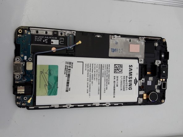

  5. Samsung A3 2016 Model - A310F Display / LCD Replacement: passo 5, immagine 1 di 1
    • Remove the Philips screw securing the mainboard.
    • Remove the cable attached to the mainboard
    • Disconnect the display and camera connectors from the mainboard
