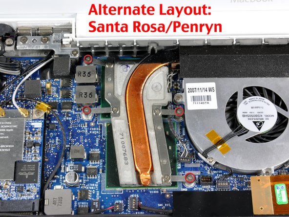

  16. MacBook Core 2 Duo Heat Sink Replacement: passo 16, immagine 1 di 2 MacBook Core 2 Duo Heat Sink Replacement: passo 16, immagine 2 di 2
    • Remove the four Phillips screws securing the heat sink to the lower case.
    • Be sure to secure the ground loop for the speaker cable beneath the screw in the lower right corner when replacing the heat sink.
    • If you have a MacBook Core 2 Duo Santa Rosa/Penryn, the two Philips screws on the right are in a different location.

I used the guide and had no problems getting to the point of replacing the heatsink. I see how the rear heat sensor (250) clips onto the logic board but for the life of me, I cannot see how the longer sensor attaches. I see two contacts but other than the felt thing, there is no way to attach. . . What did I do wrong. . . HELP. Milt King
Milton King - Replica
To refit the temperature sensors, ensure the cables are rooted under the clips of the heatsink. The connectors then just push down on to the motherboard pins.
