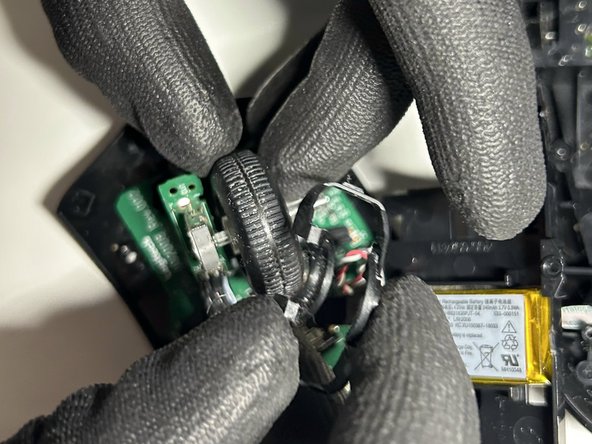

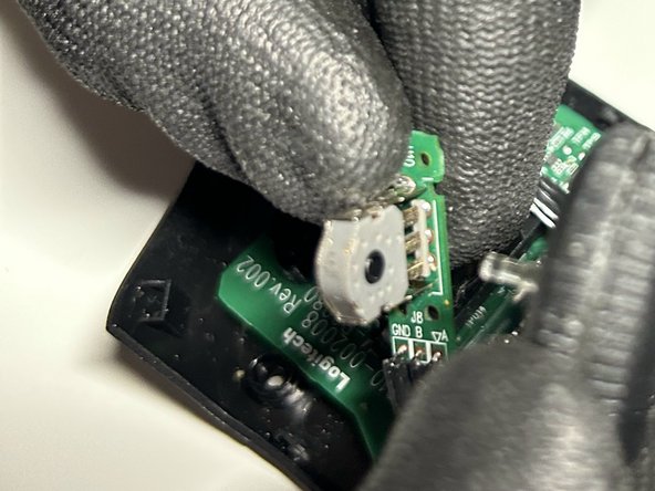

    • Unscrew the two 4.7 mm countersunk screws that secure the scroll wheel in using the Phillips #00 Screwdriver.
  7. Logitech G703 Lightspeed Scroll Wheel Replacement: passo 7, immagine 1 di 3 Logitech G703 Lightspeed Scroll Wheel Replacement: passo 7, immagine 2 di 3 Logitech G703 Lightspeed Scroll Wheel Replacement: passo 7, immagine 3 di 3
    • Remove the rubber piece protecting the scroll wheel.
    • Detach the scroll wheel from the white plastic piece and replace.
