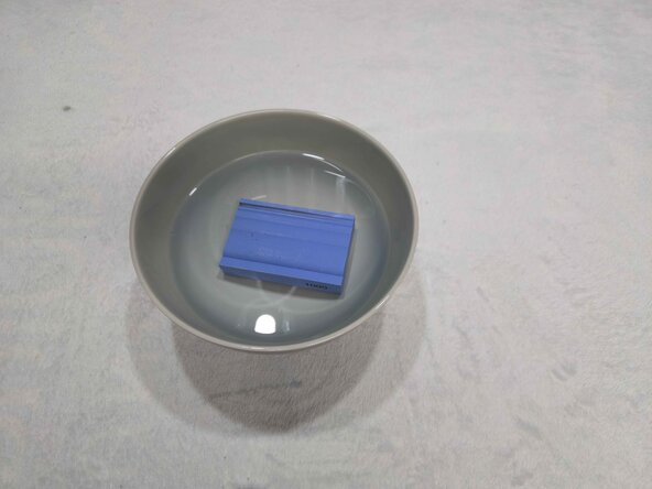

    • Soak then set up Whetstone
    • Submerge the whetstone in water for 5 to 10 minutes until air bubbles stop rising.
    • Place the whetstone on a rubber mat or holder so it stays still while sharpening.
    • Keep bowl of water nearby to re-wet the whetstone again if it dries.
    • A fully soaked stone gives a smoother sharpening surface and prevents friction burns.
