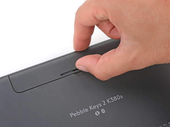

  2. How to Open Your Logitech Pebble Keys 2 K380s Keyboard, Remove the battery cover: passo 2, immagine 1 di 3 How to Open Your Logitech Pebble Keys 2 K380s Keyboard, Remove the battery cover: passo 2, immagine 2 di 3 How to Open Your Logitech Pebble Keys 2 K380s Keyboard, Remove the battery cover: passo 2, immagine 3 di 3
    • Push the battery cover's center tab in and up to remove the cover.

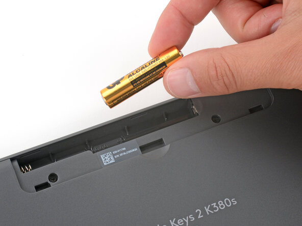

  3. How to Open Your Logitech Pebble Keys 2 K380s Keyboard, Remove the batteries: passo 3, immagine 1 di 3 How to Open Your Logitech Pebble Keys 2 K380s Keyboard, Remove the batteries: passo 3, immagine 2 di 3 How to Open Your Logitech Pebble Keys 2 K380s Keyboard, Remove the batteries: passo 3, immagine 3 di 3
    • Use your finger to lift the edge of the first battery and remove it.
    • Slide the second battery out of its recess and remove it.
    • During reassembly, slide the AAA batteries in negative (-) end first, as shown in the recess.

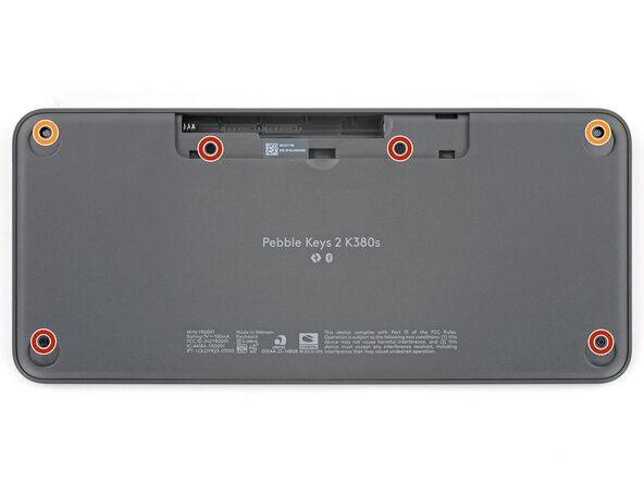

  6. How to Open Your Logitech Pebble Keys 2 K380s Keyboard, Remove the screws: passo 6, immagine 1 di 2 How to Open Your Logitech Pebble Keys 2 K380s Keyboard, Remove the screws: passo 6, immagine 2 di 2
    • Use a Phillips screwdriver to remove the six screws securing the keyboard together:
    • Four 3.1 mm‑long black screws
    • Two 7.2 mm‑long silver screws

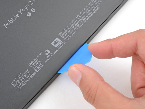

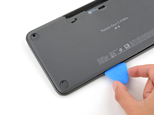

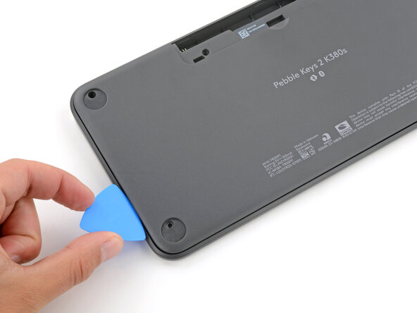

  7. How to Open Your Logitech Pebble Keys 2 K380s Keyboard, Insert an opening pick: passo 7, immagine 1 di 3 How to Open Your Logitech Pebble Keys 2 K380s Keyboard, Insert an opening pick: passo 7, immagine 2 di 3 How to Open Your Logitech Pebble Keys 2 K380s Keyboard, Insert an opening pick: passo 7, immagine 3 di 3
    • Strong plastic clips around the perimeter of the keyboard secure the two halves together. Separating them is tricky and will require some force.
    • Insert the flat edge of an opening pick in the seam between the two halves of the keyboard, near the center of the bottom edge.
    • Use the pick to pry up the two halves apart, releasing the clips.
    • You should feel and hear the clips release. If you don't, remove the pick and try again.
    • Leave the pick inserted for the next step.

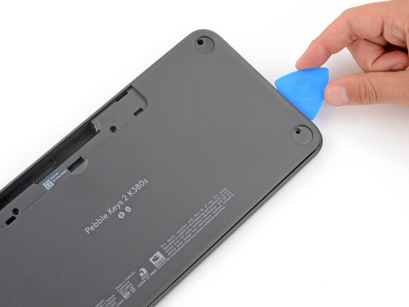

  8. How to Open Your Logitech Pebble Keys 2 K380s Keyboard, Release the clips: passo 8, immagine 1 di 3 How to Open Your Logitech Pebble Keys 2 K380s Keyboard, Release the clips: passo 8, immagine 2 di 3 How to Open Your Logitech Pebble Keys 2 K380s Keyboard, Release the clips: passo 8, immagine 3 di 3
    • Keep the pick angled flat to the keyboard to help release the clips.
    • Slide the opening pick towards the bottom right corner, up the right edge, and along the top edge to release the clips.
    • You should feel and hear the clips release. If you don't, slide the pick along the section again and pry until the clips release. The top edge clips are particularly tricky to release.
  9. How to Open Your Logitech Pebble Keys 2 K380s Keyboard: passo 9, immagine 1 di 3 How to Open Your Logitech Pebble Keys 2 K380s Keyboard: passo 9, immagine 2 di 3 How to Open Your Logitech Pebble Keys 2 K380s Keyboard: passo 9, immagine 3 di 3
    • Repeat the process on the other side of the keyboard to release the remaining clips.
