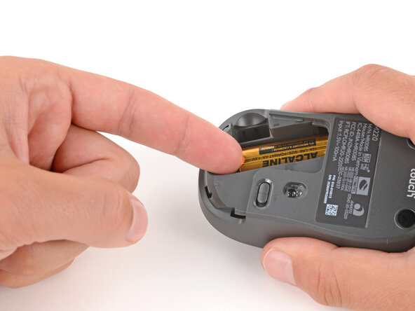

  3. How to Open Your Logitech M220, Remove the battery: passo 3, immagine 1 di 3 How to Open Your Logitech M220, Remove the battery: passo 3, immagine 2 di 3 How to Open Your Logitech M220, Remove the battery: passo 3, immagine 3 di 3
    • Use your fingers to lift the end of the battery and slide it out of its recess.
    • During reassembly, slide the battery in negative (-) end first, as shown on the engravings in the recess.

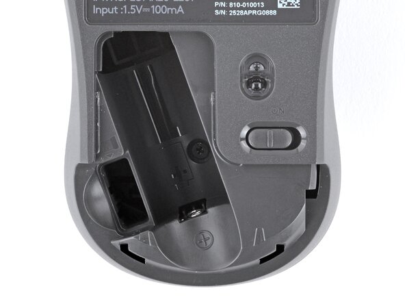

  4. How to Open Your Logitech M220, Remove the case screw: passo 4, immagine 1 di 2 How to Open Your Logitech M220, Remove the case screw: passo 4, immagine 2 di 2
    • Use a Phillips screwdriver to remove the 5.4 mm‑long screw from the battery recess.
