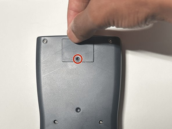

  2. How To Replace Merangue 2-Line Engineering Scientific Calculator Battery: passo 2, immagine 1 di 2 How To Replace Merangue 2-Line Engineering Scientific Calculator Battery: passo 2, immagine 2 di 2

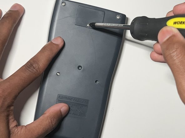

    • Flip the calculator so that the back case is facing you.
    • Use a Phillips #0 screwdriver to remove the single screw from the battery cover at the top of the back case.
    • Keep the screw in a safe place to use when replacing the battery cover later.
    • If the screw does not unfasten easily, do not force it to avoid stripping the screw. If the screw is already stripped refer to the Come rimuovere una vite danneggiata guide.

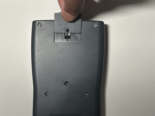

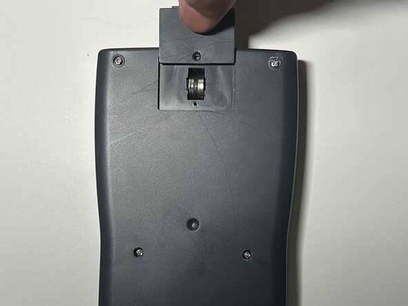

    • Gently apply pressure to the battery cover and slide it upward.
    • If it doesn't come off easily, try gently wiggling it but do not use excessive force.

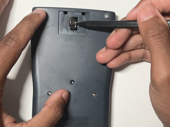

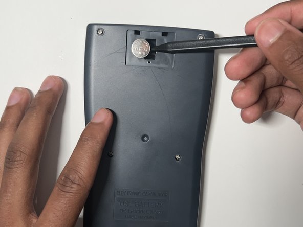

    • Insert a plastic spudger between the two batteries.
    • Use the plastic spudger to gently pry out the left and right batteries.
    • Do not use metal spudgers, as they can damage to the battery.
    • Do not use force when prying out the batteries to avoid damage.

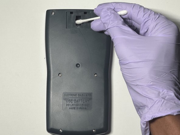

  7. How To Replace Merangue 2-Line Engineering Scientific Calculator Battery: passo 7, immagine 1 di 3 How To Replace Merangue 2-Line Engineering Scientific Calculator Battery: passo 7, immagine 2 di 3 How To Replace Merangue 2-Line Engineering Scientific Calculator Battery: passo 7, immagine 3 di 3

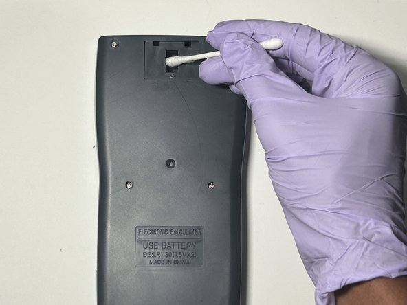

    • Dab a cotton swab in distilled white vinegar.
    • Gently clean the battery compartment in an up and down motion with the cotton swab.
    • Allow the compartment to dry completely for approximately two minutes before inserting the new batteries.
