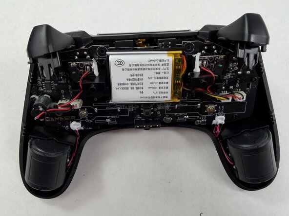

  4. GameSir Tarantula Pro Joystick Replacement: passo 4, immagine 1 di 3 GameSir Tarantula Pro Joystick Replacement: passo 4, immagine 2 di 3 GameSir Tarantula Pro Joystick Replacement: passo 4, immagine 3 di 3
    • Use the Phillips #000 screwdriver to remove the nine 4.0 mm screws from the motherboard.

  5. GameSir Tarantula Pro Joystick Replacement: passo 5, immagine 1 di 3 GameSir Tarantula Pro Joystick Replacement: passo 5, immagine 2 di 3 GameSir Tarantula Pro Joystick Replacement: passo 5, immagine 3 di 3
    • Use the point of a spudger to push on alternating sides of each JST connector to "walk" it out of its socket.
    • It may take a lot of alternating before the connector comes out. Be patient, and don't pull on the cables.
    • If that doesn't work, use a pair of tweezers to firmly grip the sides of the connector and pull straight away from the socket. Hold the tweezers closer to the connector to get a better grip.
    • If you're having trouble, try rocking the connector side-to-side to loosen it.
    • If the connector's socket has cutouts, you can insert the arms of a pair of sharp tweezers into the cutouts and gently push the connector out of its socket.
    • Carefully remove the battery from the controller.
    • Avoid bending or puncturing the battery.
    • The battery is secured by double-sided tape, so it may take some work to loosen the adhesive before you can completely remove the battery. Use the iFixit adhesive remover if you have trouble removing the battery.
