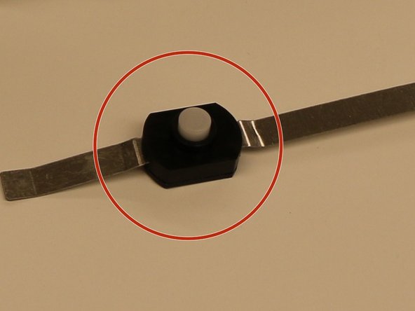

  7. Disassembling Translucent Rubber Flashlight Battery Power Component: passo 7, immagine 1 di 3 Disassembling Translucent Rubber Flashlight Battery Power Component: passo 7, immagine 2 di 3 Disassembling Translucent Rubber Flashlight Battery Power Component: passo 7, immagine 3 di 3
    • The switch mechanism disassembly removes the button attached to the lid (red circle) from the grooves (blue circle) containing the switch components.
    • Next, remove the spring first and then metallic, grooved pressure plate which contained the spring (red circle) using hand.
    • Finally, remove metal connections of battery switch by lifting holes (red circle) off containment piece.
