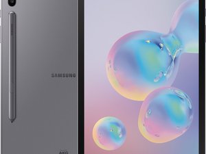

Power button is broken ...how to power on the tablet?
Power button has broken ...how to power on without power button?

Make sure your battery has enough charge to actually run.
Hold down the volume down key and connect your device via data USB cable to your PC.
Keep the volume button held down until you see a boot menu.
Select the 'Start' option using your volume keys.
