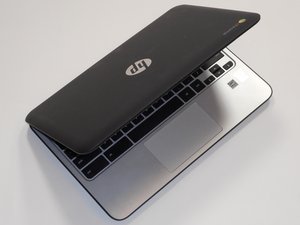

Anyone know where the BIOS Write-Protect Screw is on this image?
Anyone know where the BIOS Write-Protect Screw is on this image? This is the motherboard of a HP Chromebook 11 G3. I need to know thx in advance!

http://h10032.www1.hp.com/ctg/Manual/c04...
I think what you are looking for is found on pages 40 and 41 of that pdf file. I circled them in white on the image you provided....
Looks like only one of them is installed in your picture but it is not real clear either.

Hi
The screw is mark circle:
Do you want install other OS in this laptop?

Well, these are the screws ya gotta remove circled in white
